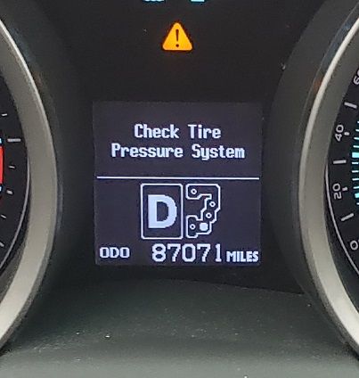

A few months ago while driving (2008 LC) I received the "Check Tire Pressure System" warning. Manually checked pressures, which were all fine. Message went away, then returned, then went away. I took it to the dealership and they told me "your tire pressure was low. It's fine."
Then last week warning returned. Manually checked pressures were normal. Warning spontaneously disappeared again. Is this likely a bad sensor or sensors, or is there another known problem that could do this? Time to replace all 5 sensors? Thanks.
This happened on my 08LX - one of the TPMS sensors had gone bad after 10 years.

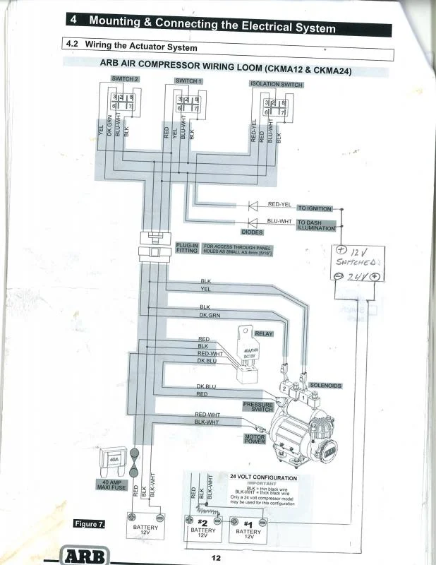

Found an ARB twin air compressor, 24v. Is 24v going to be an issue or anything weird?
For sake of not adding complexity to this system, I would highly recommend going with a 12v version.

A dude in Hyde Park, NY. It looks like he got it and is in the same position. Glad I asked before I got stoked and bought it
Look like arb expects 12v bats in series. Interesting all the relay is still 12v.
