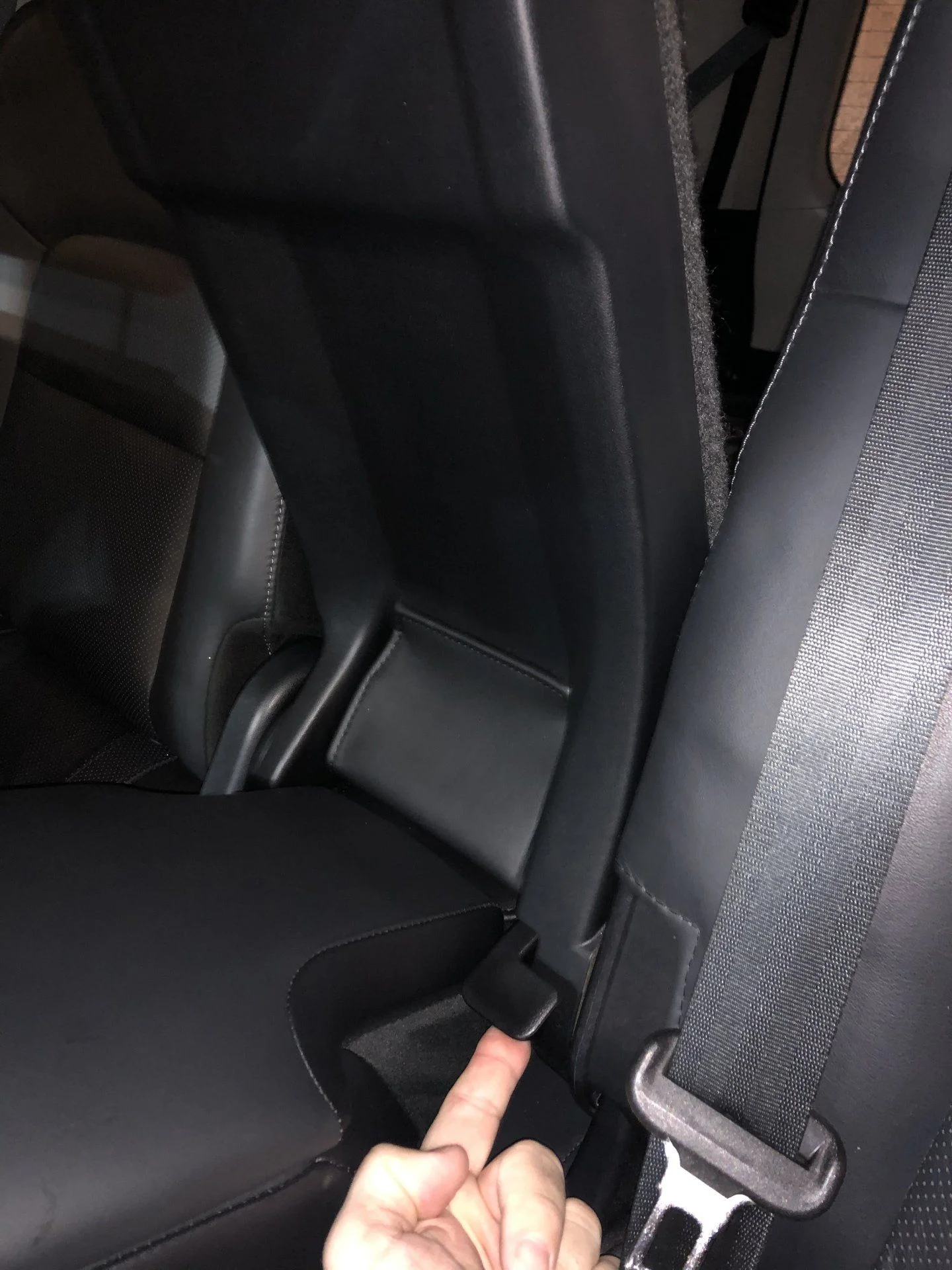

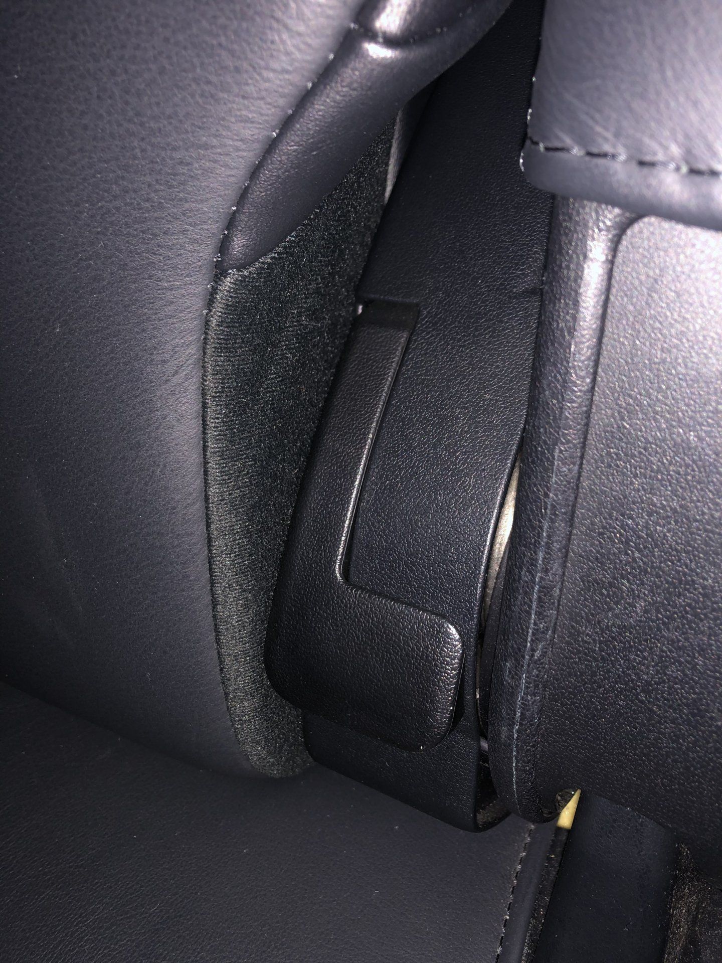

@Sandroad On my '16 there is a little lever that allows the back of the center to fold down. Did they remove this on the '17?
That’s what I was shooting for. Moving the backing for the second row armrest down. I’ve seen photos of it on this site, but wasn’t sure if was only prior years. I checked the manual (thanks for the link!), but didn’t see anything mentioned. It’s odd the it is split from the 60 section of the 60/40 second row if it can fold down.

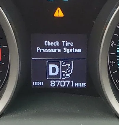

A few months ago while driving (2008 LC) I received the "Check Tire Pressure System" warning. Manually checked pressures, which were all fine. Message went away, then returned, then went away. I took it to the dealership and they told me "your tire pressure was low. It's fine."
Then last week warning returned. Manually checked pressures were normal. Warning spontaneously disappeared again. Is this likely a bad sensor or sensors, or is there another known problem that could do this? Time to replace all 5 sensors? Thanks.
Are they the original sensors? One or more of the batteries could be going out causing intermittent connection to the TMPS system. I think normal life is 7-10 years.
I haven't looked in the LC settings yet, but on my Mercedes, there was a place in the menu system where you could tell it to set the current tire pressure as the reference level. If this was done with the pressure set to 35 and the pressure on a tire drops to (for example) 32, the warning will go on, even if 32 is still considered an acceptable level because it was told that 35 is the target number and it allows a few psi variance either way (so if the allowed variance is 4 psi, the pressure would have to drop below 31). So it could be a result of outside temperature changes affecting the pressure reading, a low battery in one or more sensors, a defective sensor, or it could just be that you need to reset the reference level that the system is watching for.
