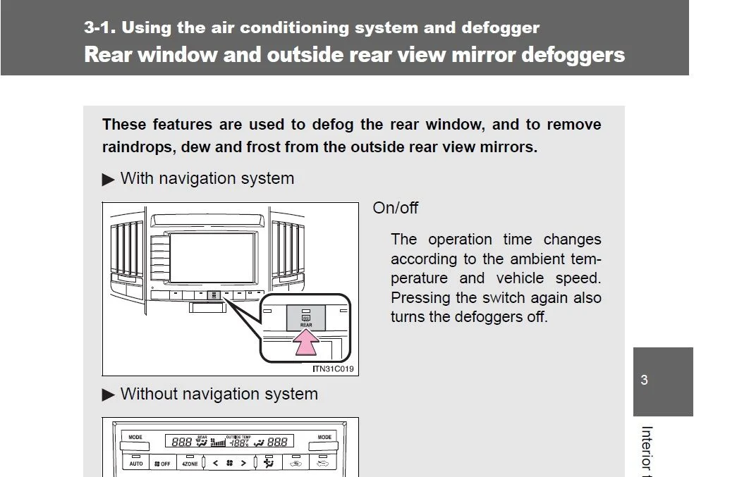

I really do need to read those silly multi-volume Owner's Manuals! I am thinking that maybe a have a fuse out or something. I really liked the way the 100 had them separately controlled. My side mirrors on that thing defrost WAY faster than my rear window!
I liked the separate button also, my 100 and Tundra both had it... And both did defrost the mirrors faster than the 200. That being said my 100 did not have the option to heat up the wipers, and when I was in freezing white out conditions they froze in place while driving. In theory the "wiper heater" would have prevented this.

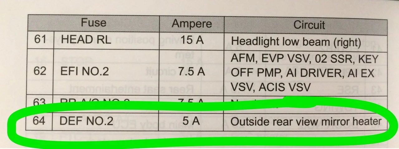

Well, mine must not be working. I had time to finish shoveling off the drive this morning and they were still not clear, even though my windshield was completely clear and my rear was fully melted.
I'll have to look into this more.
Your mirror heater could be as simple as a bad fuse.
According to my 2008 manual, the Outside rear view mirror heater has its own 5A fuse...
-Fuse number 64, at the front-right corner of the main fuse box under the hood.
That was my thought as well... I'll take a look this weekend.

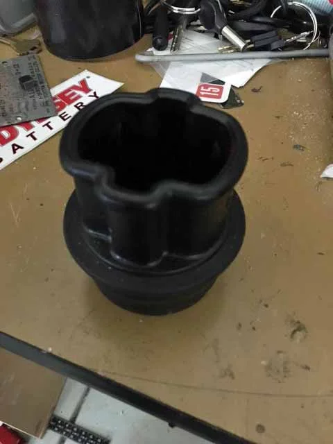

here is my Stupid question. There were two of these in the far rear cup holders. The only thing I can think of is something you put in a cup holder to hold things like pens, glasses etc
juice box...?
in theory it's for putting the tv controller in...
Maybe those are an acknowledgement that the rear cup-holders are uselessly small/shallow...and they tried make them taller/wider...?
to hold your weed
^^ I bought WeatherTechs to hold that... along with my mud, snow, rain, etc.
