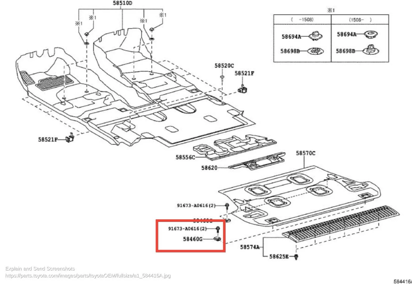

Anyone know the size/thread of the bolt for the cargo area tie downs?
The bolt part number is: 91673-A0616 (outlined in red below)
thanks!
