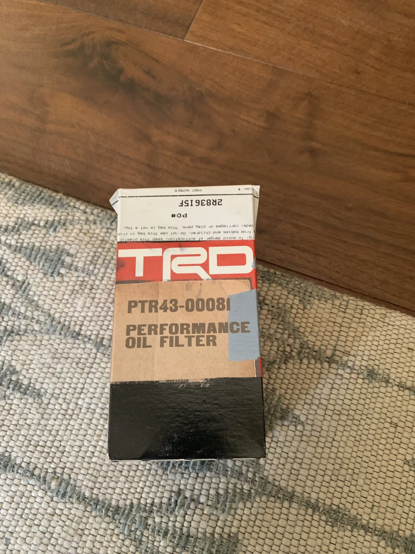

Please confirm this is the correct TRD filter for ‘10 200. Thx!View attachment 1990140
Yup. That's the one:

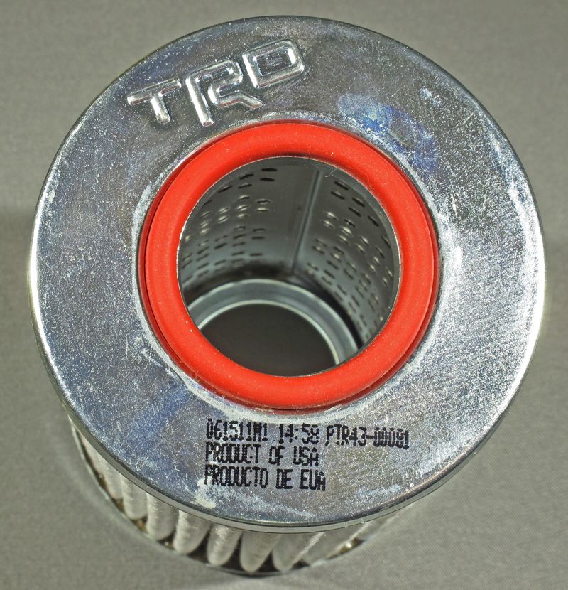

Looks like this on top:

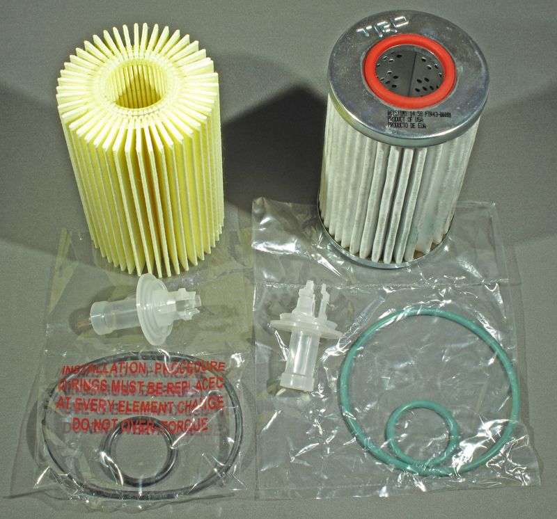

Comes with higher performance O-Rings (TRD on right, stock on left):
HTH

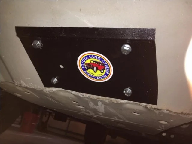

I installed the ARB skid plates but there is no cutout to enable Oil Filter access.
I tried searching but arb skid plate oil filter was not returning any examples.
I was thinking of cutting a hole for access with a hole saw; and then attaching a larger plate to cover the hole when not being used.
Has anyone fabricated access to the oil filter on the ARB skid plate?
Check @Romer build thread - he did exactly that. I always get my oil changed by the same person at the Toyota dealership, and when I had ARB skids he just removed it for access.
Thanks !
Those Bud Built stainless are way better skids, these will need the modification.
Found it... what I figured ... plate over the hole.
