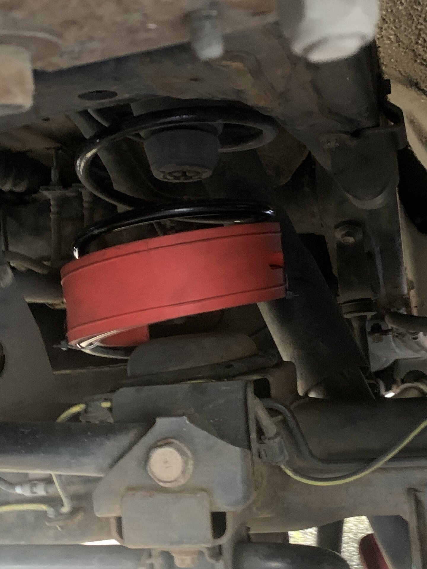

A+ size (largest they seem to offer) may end up being good in the rear. This is an a+ Rubbershox spring rubber in a rear drivers side (shorter) lx570 coil.
Depending on how much the coil compresses under the vehicle load, this one may end up “helping” the spring back there.

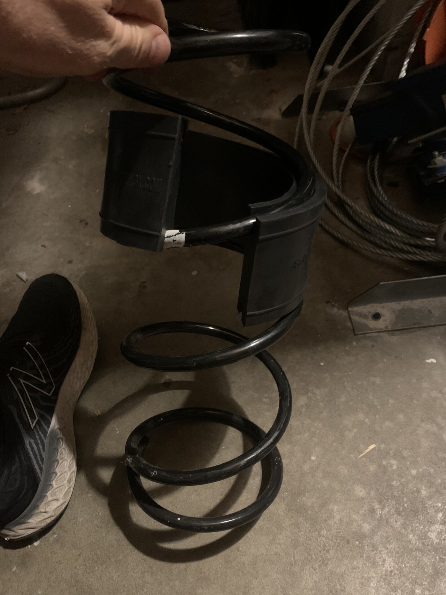

I have this driver side rear spring in my garage…I didn’t have time to fit these a+’s on the passenger rear springs I have on the lx yet but I figured I would size them on the shorter springs in the garage first.
When I have time, I’ll see how these fit on the lx with passenger rear springs and spacers…and update accordingly.
A+ seems to “thread” onto the laden longer rear passenger coil, even with a small spacer on top of the coil in high mode.
It’s tough enough to get on that I think it’ll compress down in neutral mode.

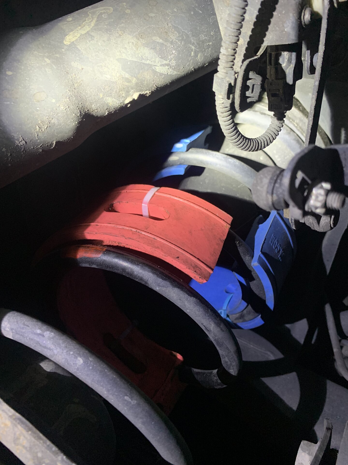

Colored rubbers are the size that fits front, quite loose on my right rear (original 10 year old) coil (now removed).
Other photo is the size a+ on my 2021 passenger rear coil (installed on driver side rear) I picked up as a take off on eBay.

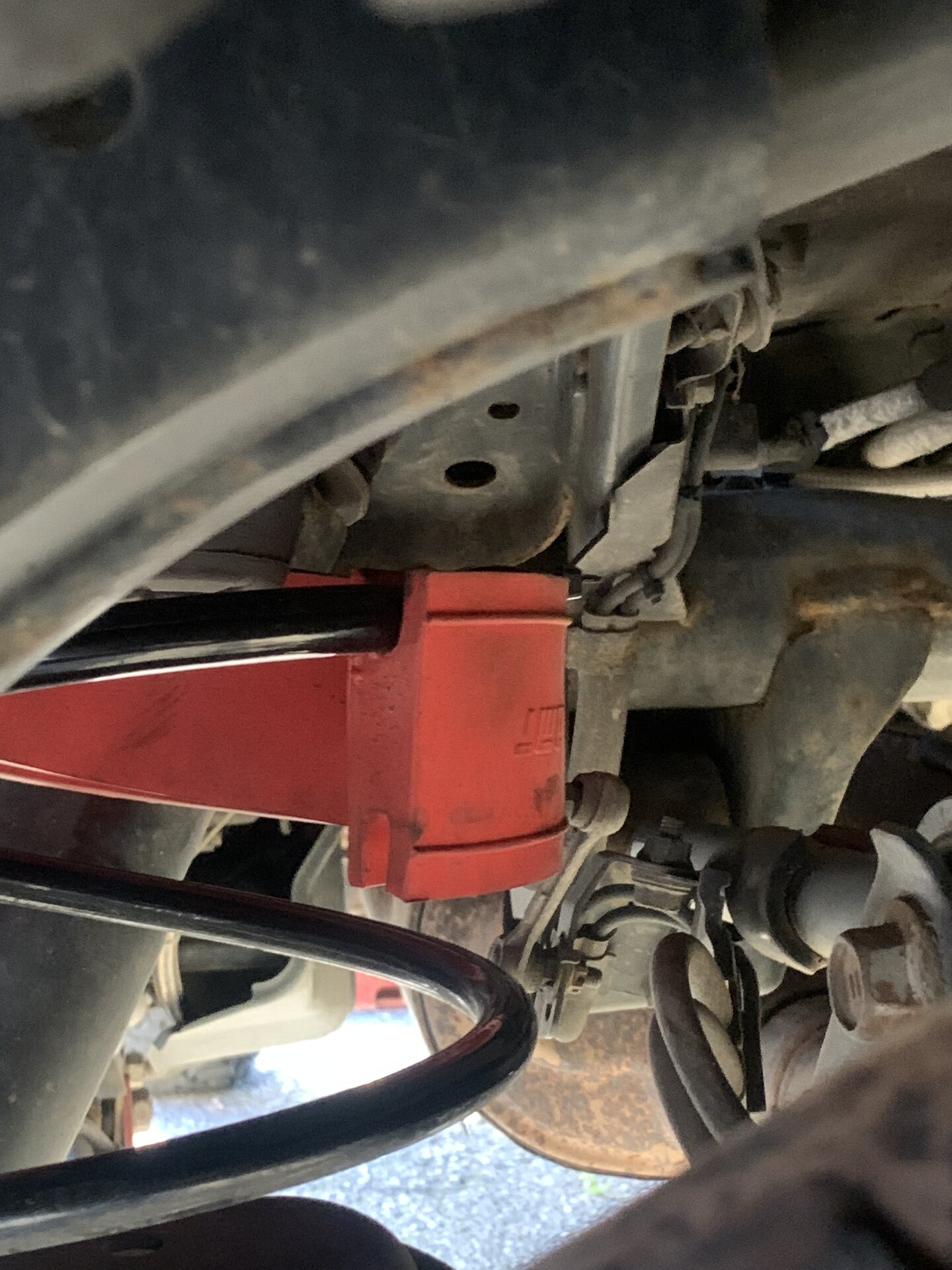

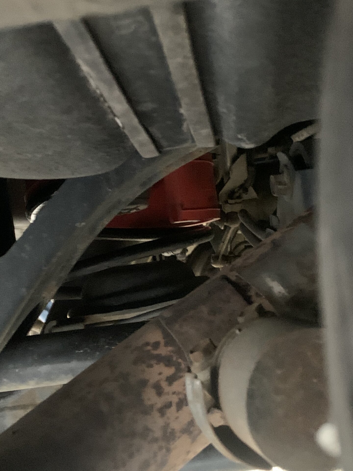

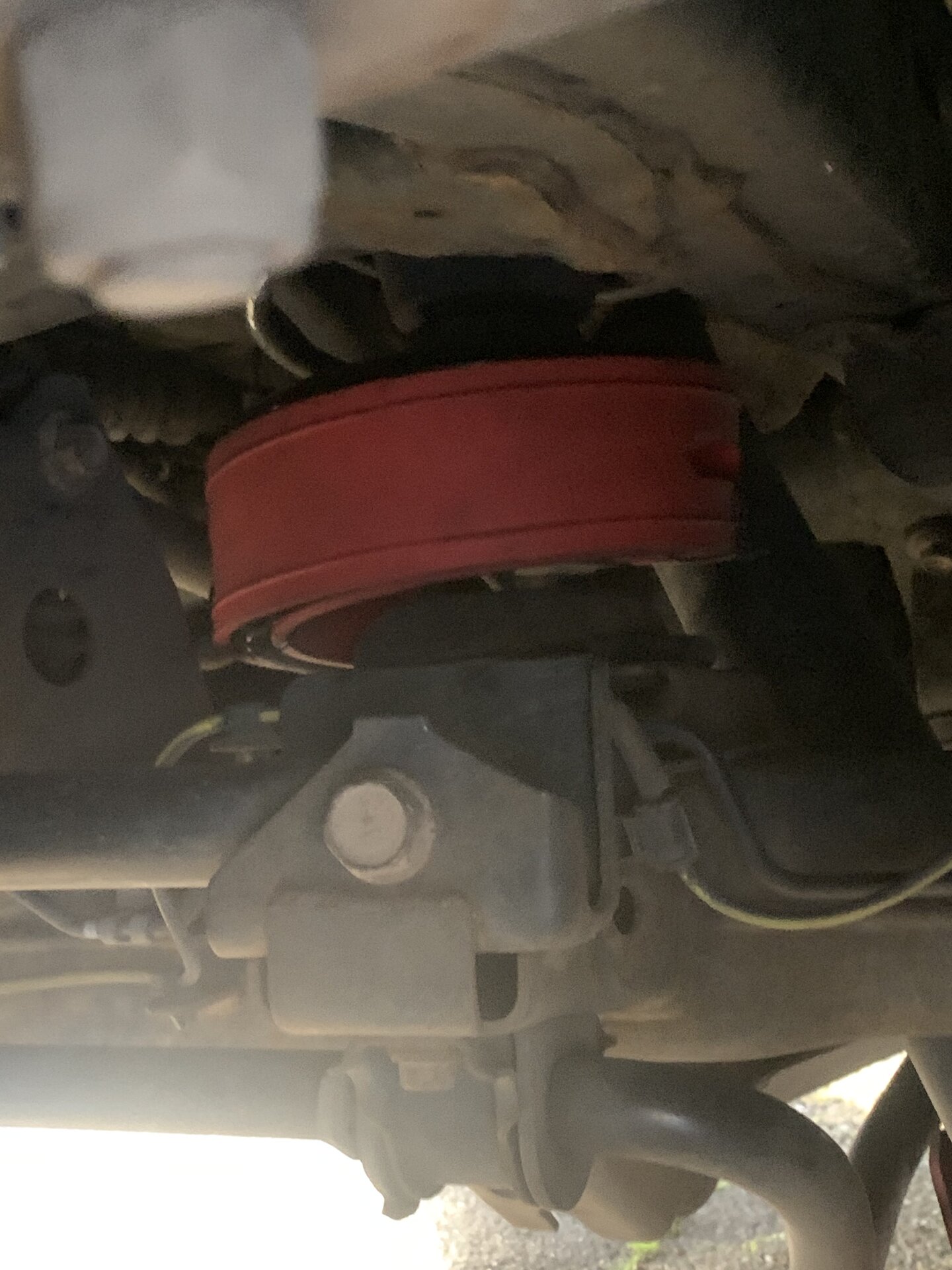

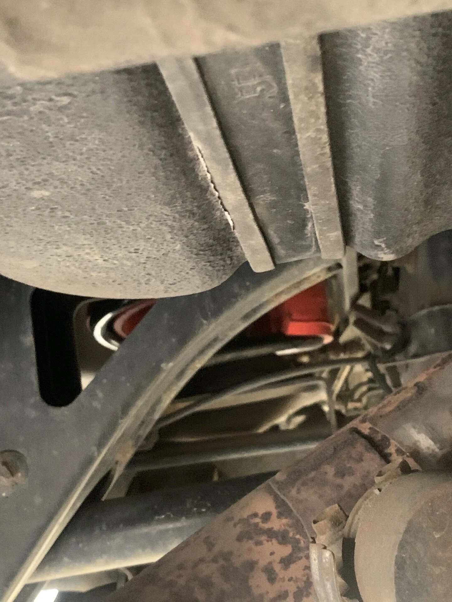

Here’s the right side (us passenger) rear, using size B. It’s floating in H, good contact in N and L.
Pics are H and N
Here’s the left side (us driver) in H N and L.
It’s about 1 inch floating in H. About in contact in N, some contact L.

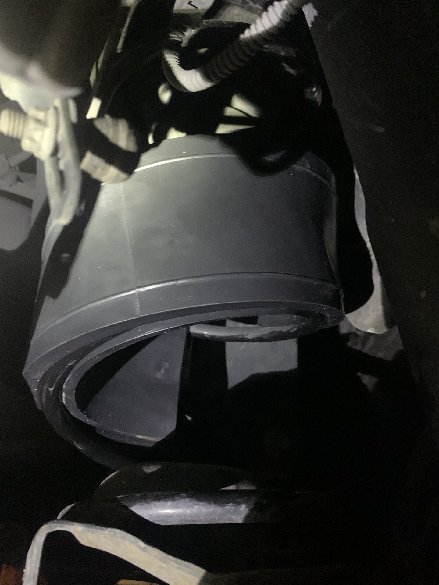

Got the black size B on in front. Car definitely feels better overall. Pairs nicely with the TT springs I have in the rear. Wish we had options for stiffer springs up front but this will do for now.
Pretty easy install after getting them lubed up with magic lube.
Just did the blacks up front. 159k, transformed the truck with a heavy bumper. Best money I have spent on the rig. A huge thanks to everyone who paved...plowed...the way.
