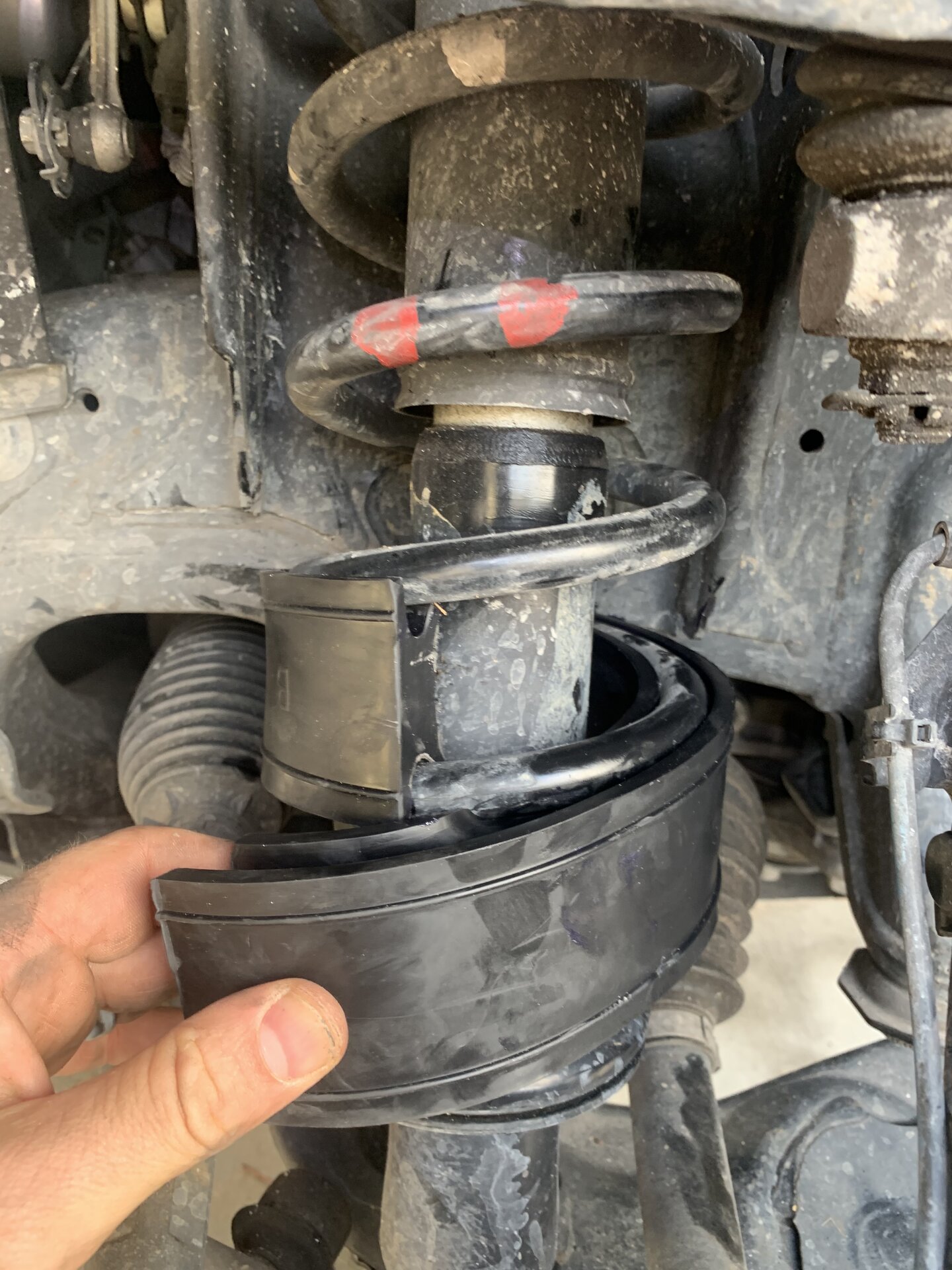

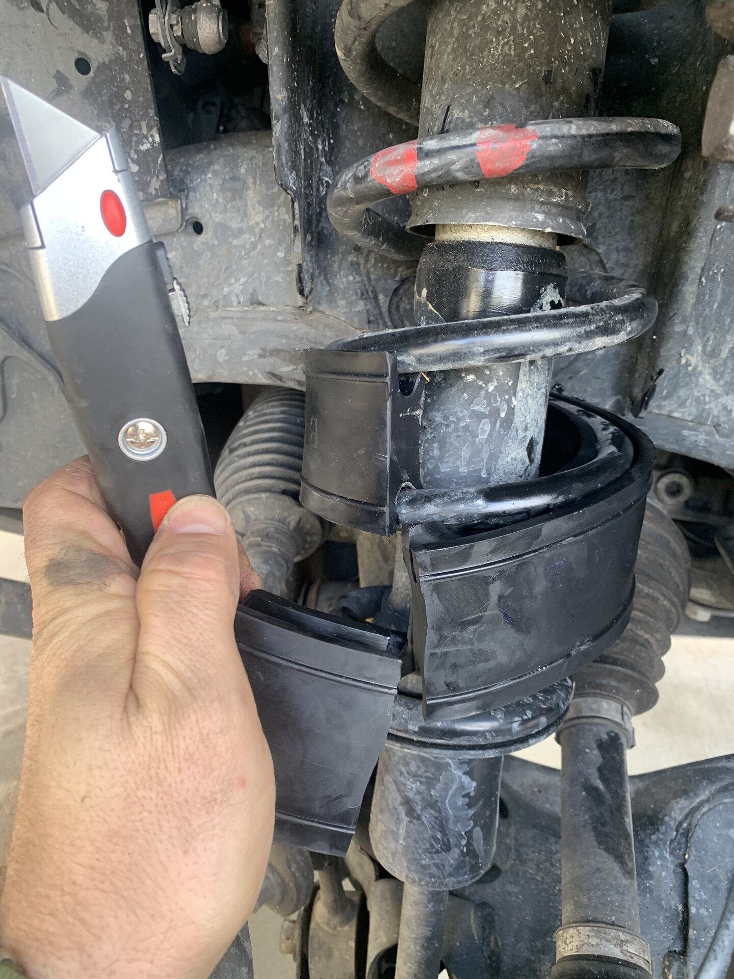

Adding them in the front: lube them up with silicone grease and cut an angle on the rubber like Grinchy references in this thread…that helps get them started. Working them in there took me about 10-15 minutes per rubber. Now that I’ve done it a couple times, the fronts will probably go in in 5-10 minutes each.
Once they’re “threaded” onto the coils, you’ll note that the overlap themselves and need to be trimmed. This can be carefully done with a box cutter while they’re installed on the vehicle.
With the black coils, you’ll also need to drill zip tie ports in them as, unlike the blue ones, the manufacturer doesn’t appear to include them on the black ones.

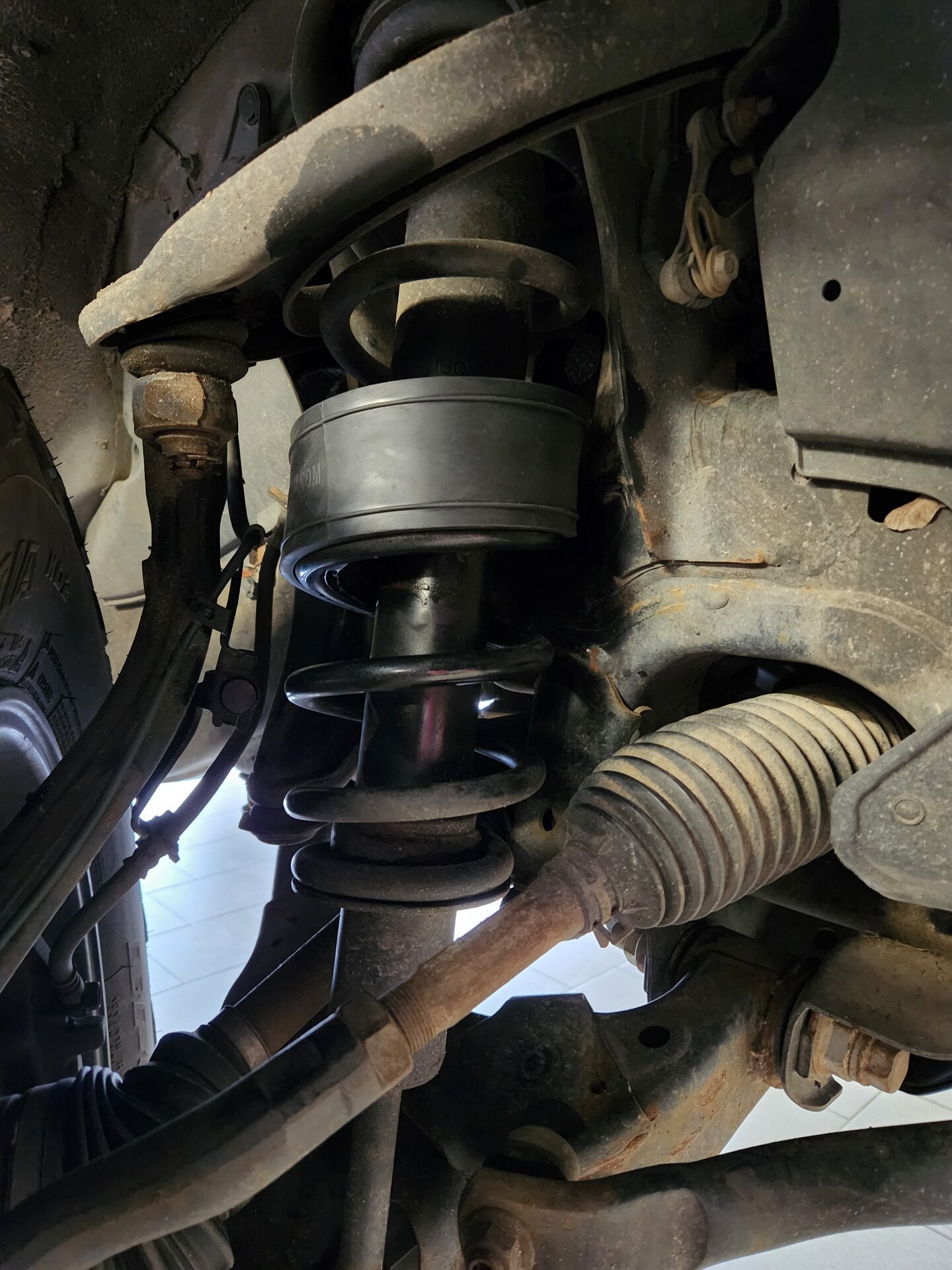

Got mine in yesterday... I like these, I like these a lot. I have the 10mm spacers up front as well.
A few observations for me: less side to side sway (I am pretty top heavy, hehe), a whole lot less nose dive under braking (pros and cons to this for my driving style), and I don't have my ahc warning light going off at turn-in anymore which is nice. It might be in my mind, but i do feel like the nose has come up a bit in all conditions, i didn't measure the front height before and after so i can't be sure, but that is what my gut is telling me, also don't have the front hunting around to settle itself out at stoplights, etc. I am back to driving around in the middle setting again, harder and softer have the desired effect which I think I appreciate the most.
