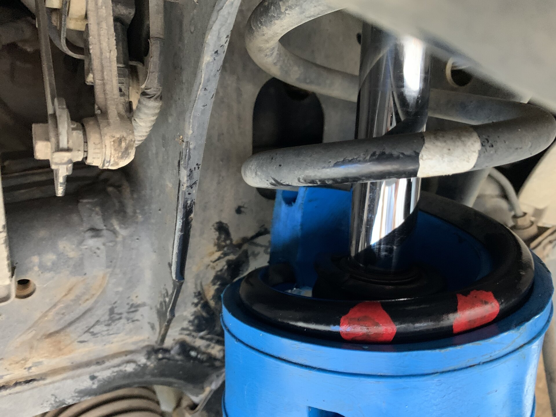

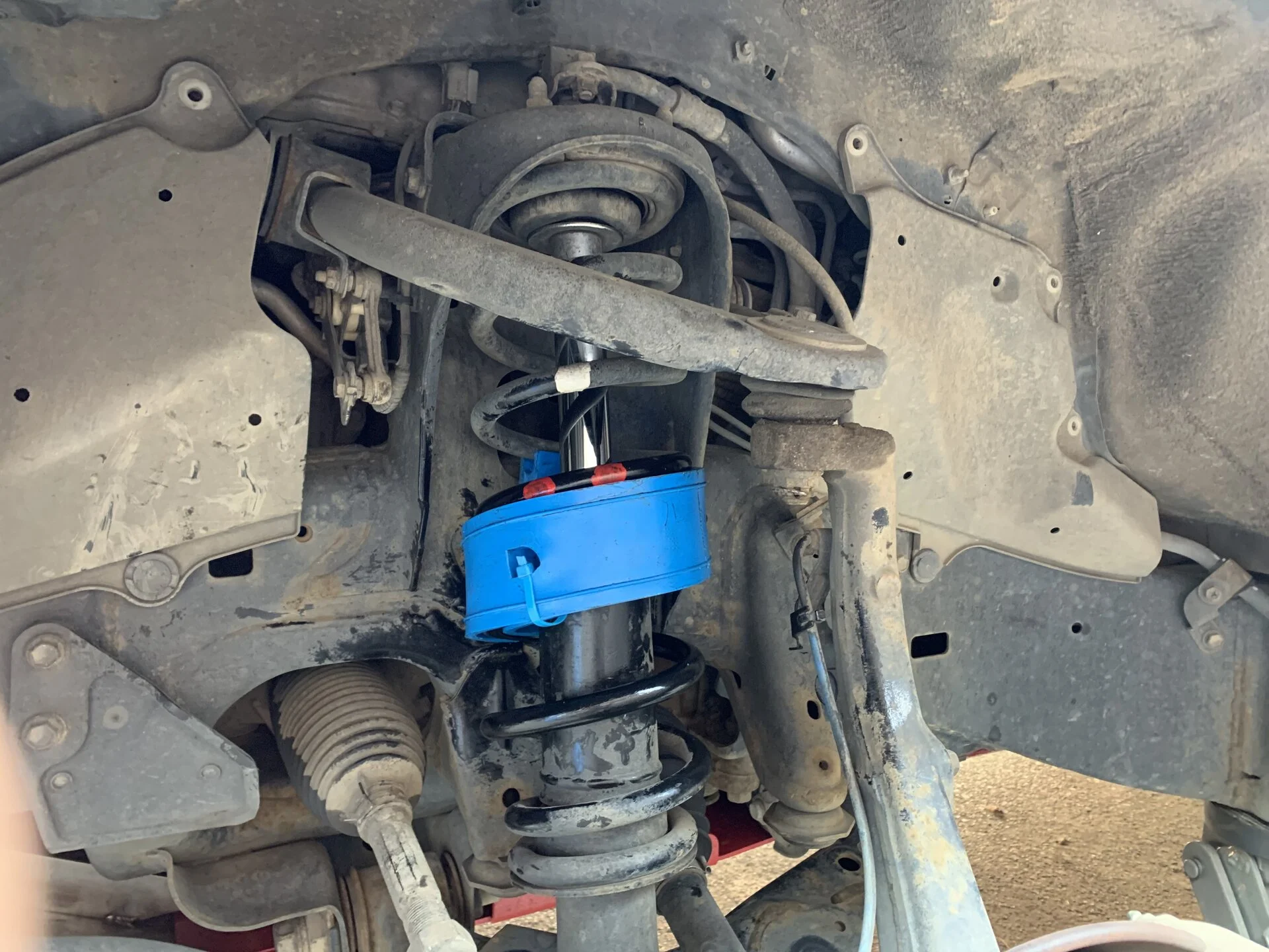

Here’s a picture of a spring rubber (or two)
And a picture of one installed
The LX570 takes size B in all four corners . The spring rubber needs about 70 mm (measured along the outside curve) trimmed on install to allow full wrap on front springs. Not sure what the trim would be for rear spring, the trimmed for front blue ones I moved back there were too short to cover a full wrap, and even uncut might be a bit short <edit - uncut B is also too short, probably goes 3/4 of a coil turn>

After I chatted with you the last time I went ahead and bought a set of blacks for the front, still sitting on my shelf though... I do have 10mm spacers up front already and the terrain tamers with airbags in the rear, but even "unloaded" I can still get my AHC warning light to come on when hard into corners (I am still stock AHC height but I am heavy for sure).
What did you use to cut yours down 40mm?
hacksaw. it cuts real easy, a box knife could do as well. even the black spring rubber isn't hard. I just measured my black offcut, it's 70mm. I have updated the first post.
One hint on cutting, observe the inward slope on the factory end and attempt to replicate. If you cut flush/90 degree you'll have to cut them shorter to prevent overlap

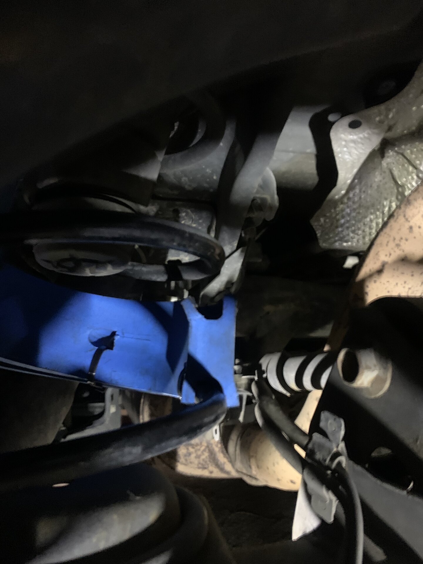

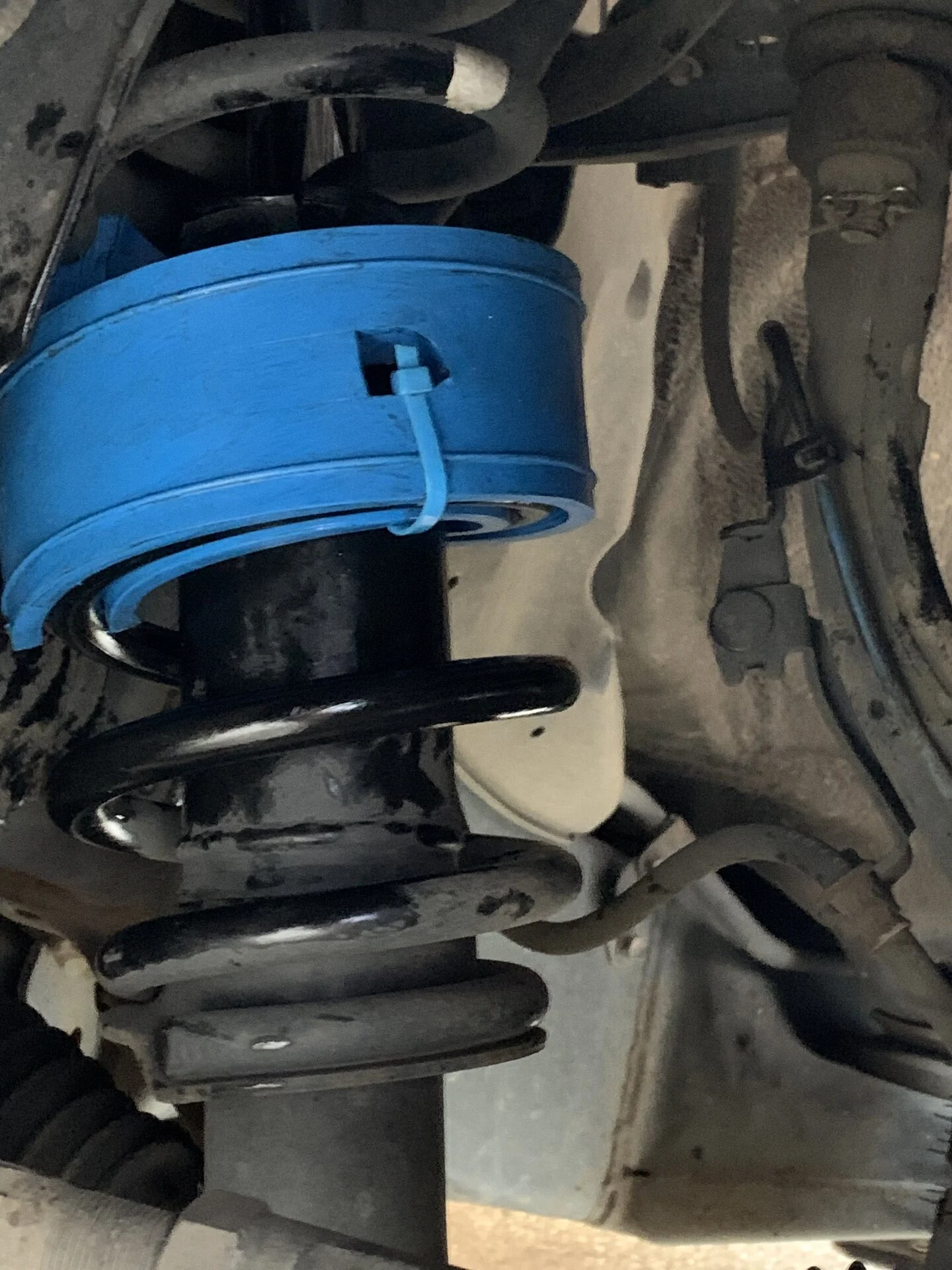

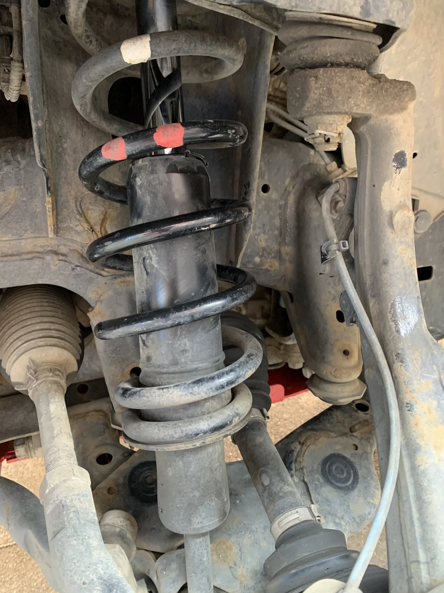

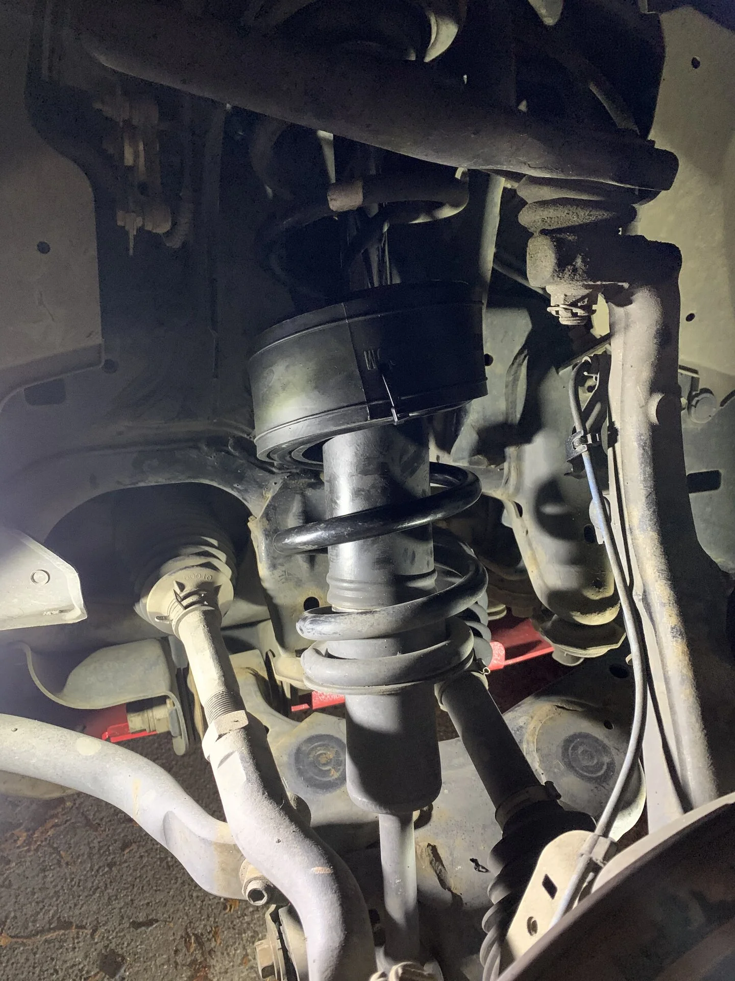

Picture dump
The last is Rear US Driver, that gap closes down when weighted. Super easy install on that corner.
The rest are initial fit pics on the front

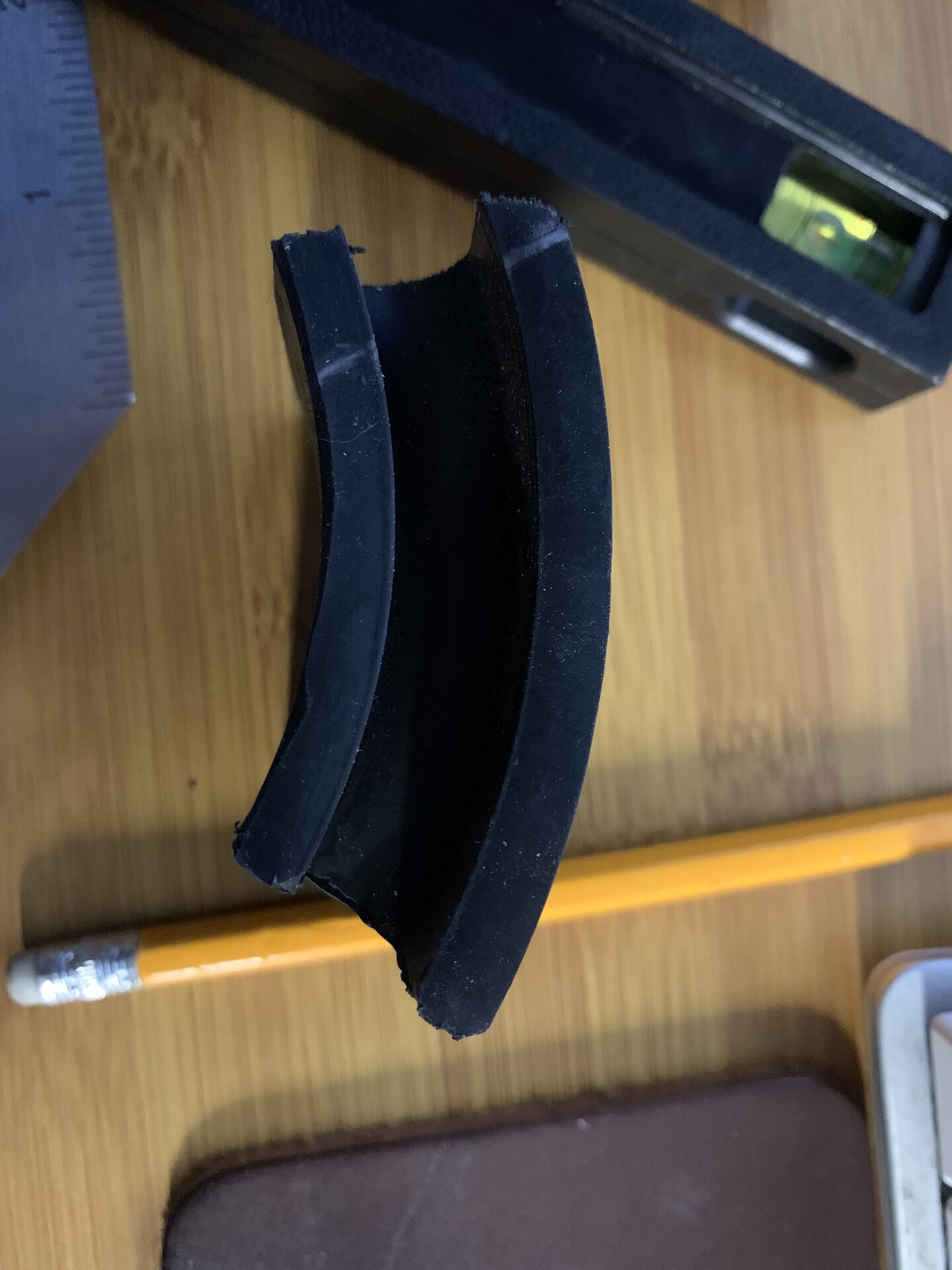

Would you mind photographing the cut you made?
sure. easiest thing to do is take the uncut item, put an angle measure on it, and mark the cut location at 70mm with that angle. it doesn't have to be precise
Looks like about 5mm shorter on the inside. Factory edge down, marked same angle on other end. Looks like my cut was more ‘straight’. It worked fine.
70mm is the outside length along the curve, not 'straight'. Just roll the ruler along the outside.
