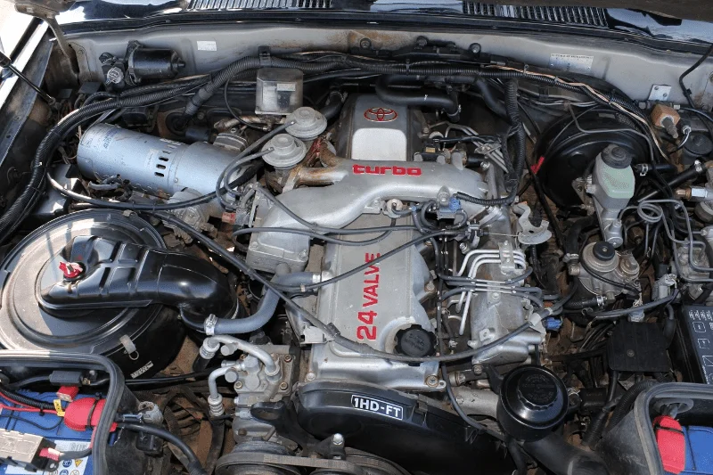

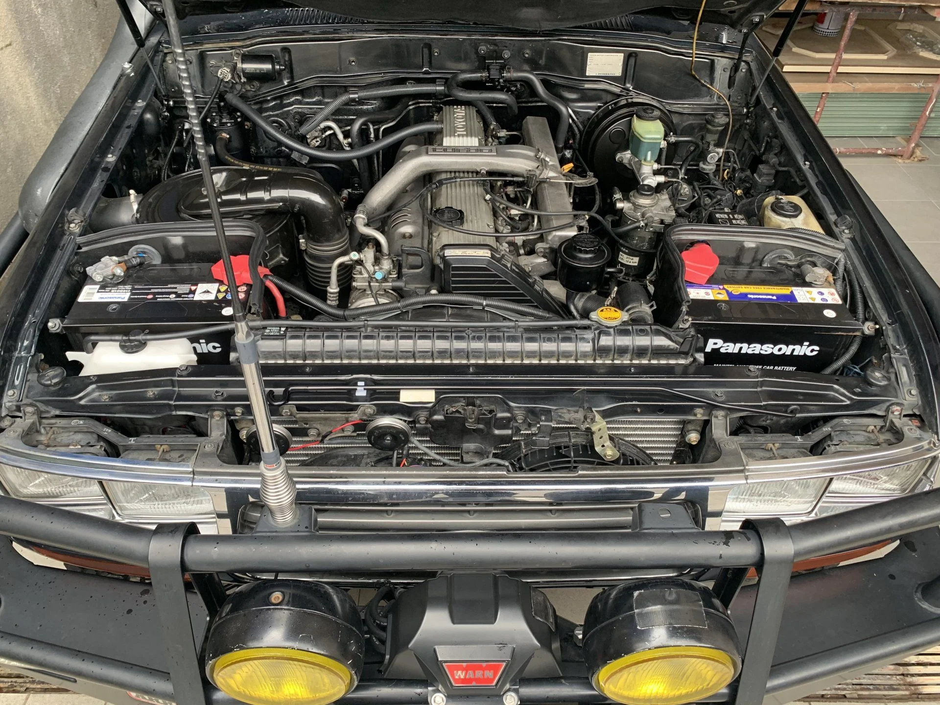

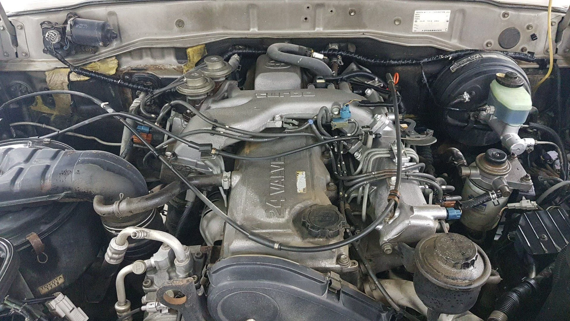

Hmmm... Intresting theory, SNLC. Here's a couple of photos of the engine bay:
I don't see any evidence of things having been moved around. The wiper moter, for example. I don't have any photos of the driver's door jam at hand, but next time I will have a look and see what is there.
I've heard there is some company in Dubai that does conversions of more recent Land Cruisers. But I've also heard that it is possible to special order LHD in the Japanese Domestic Market--because for a time after WWII, again I am told, it was prestegious to do so in emulation of Amercian imports. No idea if this is true.
But this is all great fun, trying to figure this out!
Well, the best conversions, you would be hard pressed to see anything that gives it away.
All they really had to do was have a LHD donor. If it was cut for the conversion it’s pretty likely that would have been done at the a-pillar and the floor where it meets the firewall. Also engine mounts may show signs of welding because as you say that is a rare engine for over there. And as you probably also know there are some high dollar shops over there that do crazy builds with no expense spared.

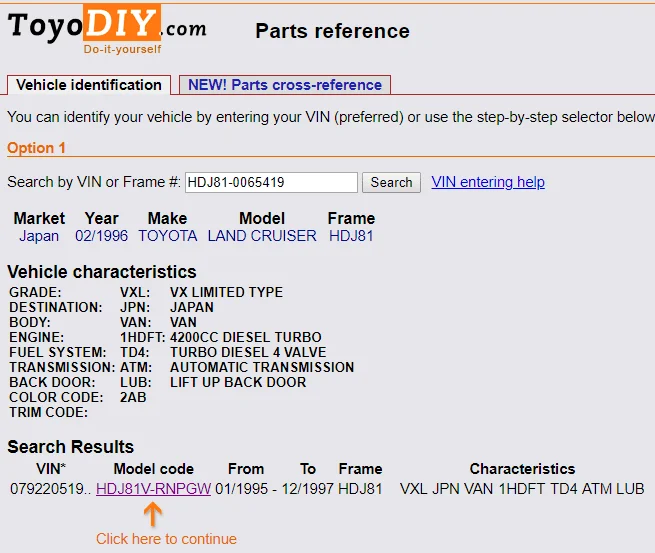

Toyodiy has always been spot on for me and the few dozen trucks I have decoded on there. I will say if anywhere in the world could have gotten special orders from Japan it would have been the Middle East.

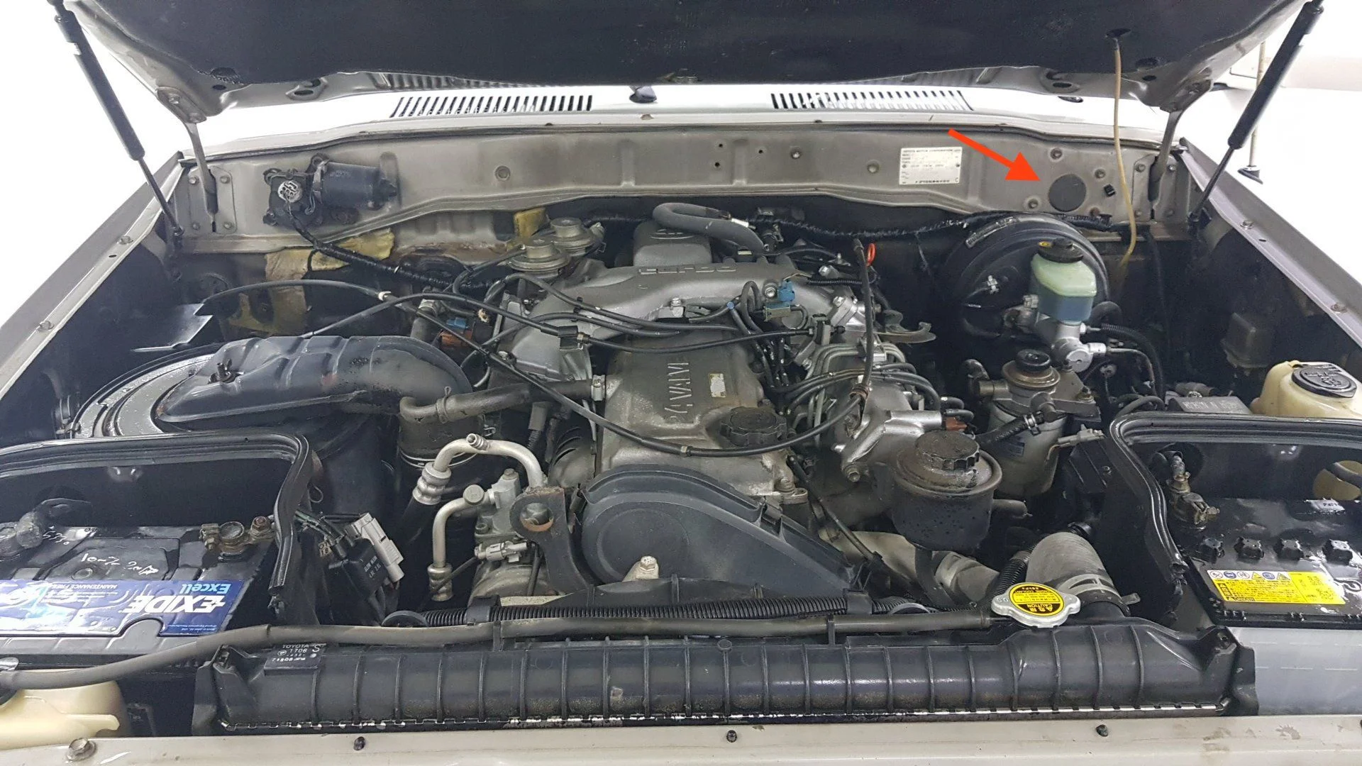

Here’s a photo of the engine bay of my LHD ‘96 HDJ80 for comparison.
By the way, the dead giveaway that the OP’s was originally a RHD is the antenna placement. It should be on the passenger side fender.
The only question remaining is where and when the conversion was done. Was it contemporaneous with the purchase as new, and was it done through the UAE's sole importer. Good thing I never listen to the radio and can keep it down. Otherwise it would bother me.

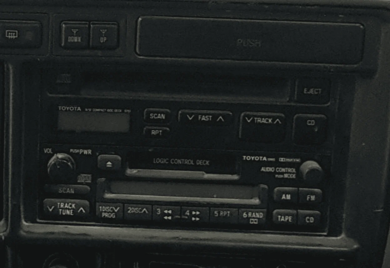

Incidentally, speaking of the radio, if anyone can identify this exact radio/cd I'd be very grateful. I'd like to try to keep it in the truck and modify to add bluetooth, which is possible with some of the radios where the CD was implemented as a separate deck, as this one seems to be from this bad photo.
I've seen a bunch of photos online that look similar, but none that are identical. From the small size of the displays I wonder if it is not from earlier on in the 90's.

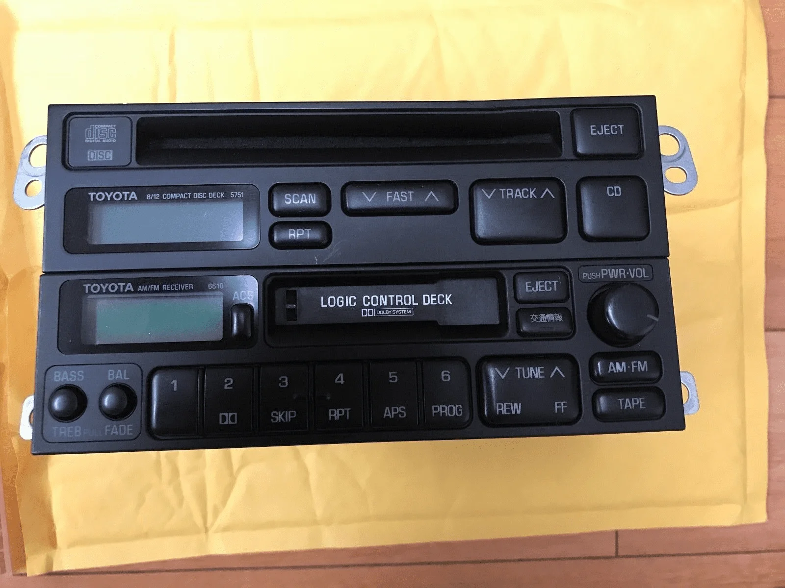

Just to add to the mystery, after googling the parts numbers I found an ebay listing for this:
The CD player it the same, but the radio portion is pretty much the mirror of the one in my truck. And get this description from the ebay listing: "Removed from RHD 1992 Toyota Land Cruiser 80". Which suggests that this radio is for LHD. Which could suggest that the conversion was done in Japan. But thanks to WDE I'm much closer to figuring out how to add an aux input to this.
The radio was probably replaced because the Japanese radios can only tune up to 89.9Mhz in the FM band.
