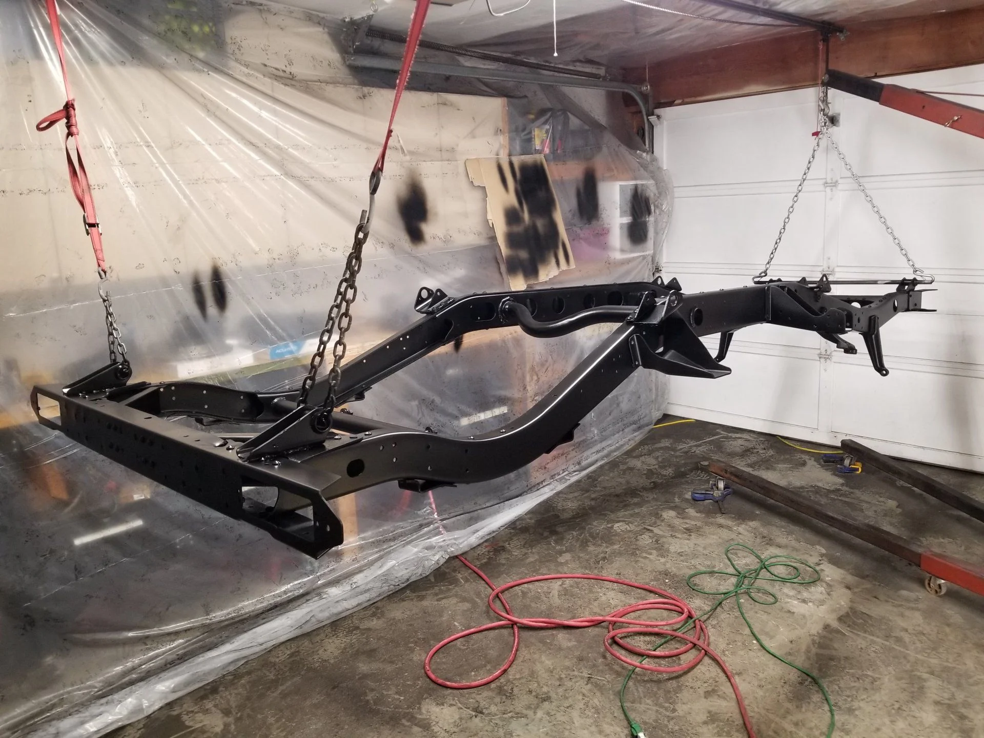

That was a PITA. Used the epoxy primer on freshly blasted frame and urethane satin per recommendations. Not perfect but better now that it's black!
