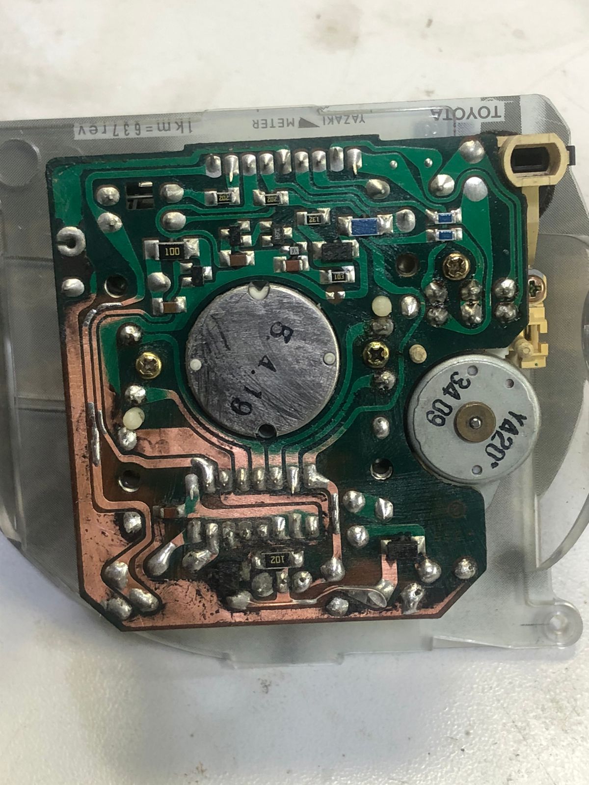

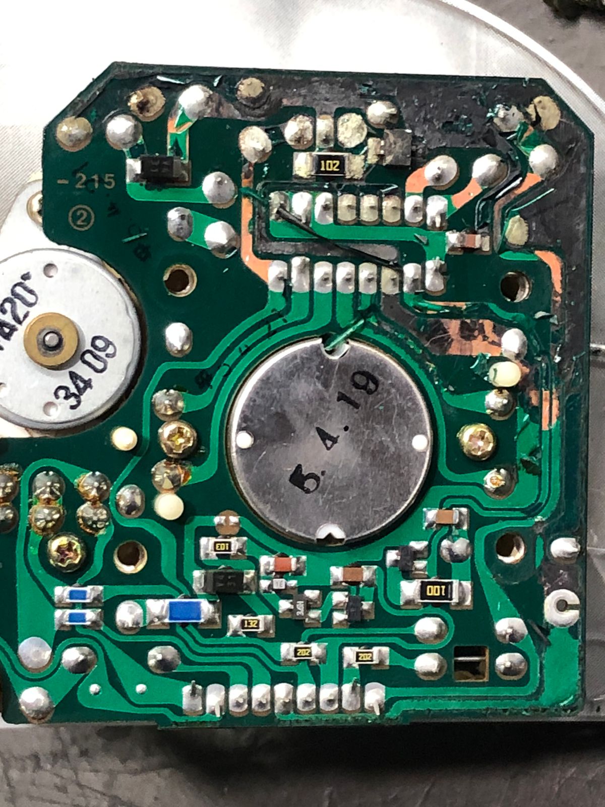

Long story short …. 93 model Speedometer/odometer not working, removed it and took it to someone who knows his way around the electrical components of vehicles.
Bottom line the attempt to fix amd repiar the speedo/odo didn’t work.
Below is a pic of before and after cleaning the circuit. Any help is really appreciated.
I really need to get it fixed
View attachment 3257595View attachment 3257597

The speedometer sensor is mounted on the transfer case and reads back to the gauge cluster by wire.
Check wire connectors there to see if sensor is operating.
I'd also be worried about what happened to cause that nastiness.
Have you confirmed that the cable end @the t-case is still functional?
