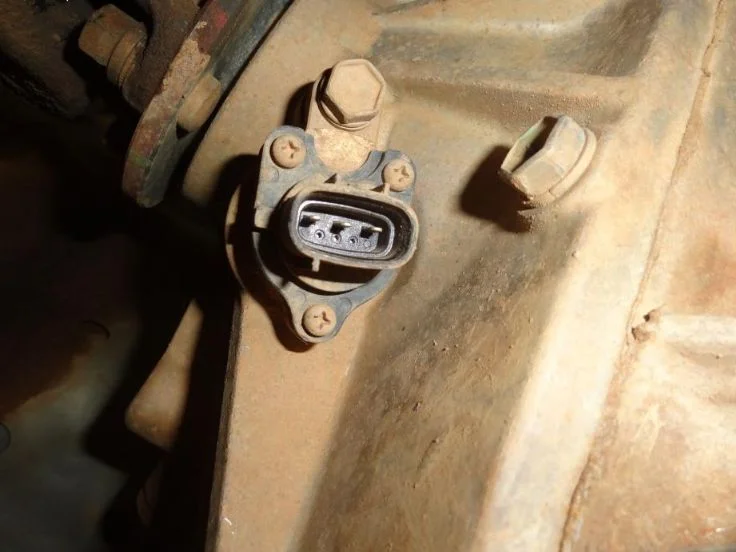

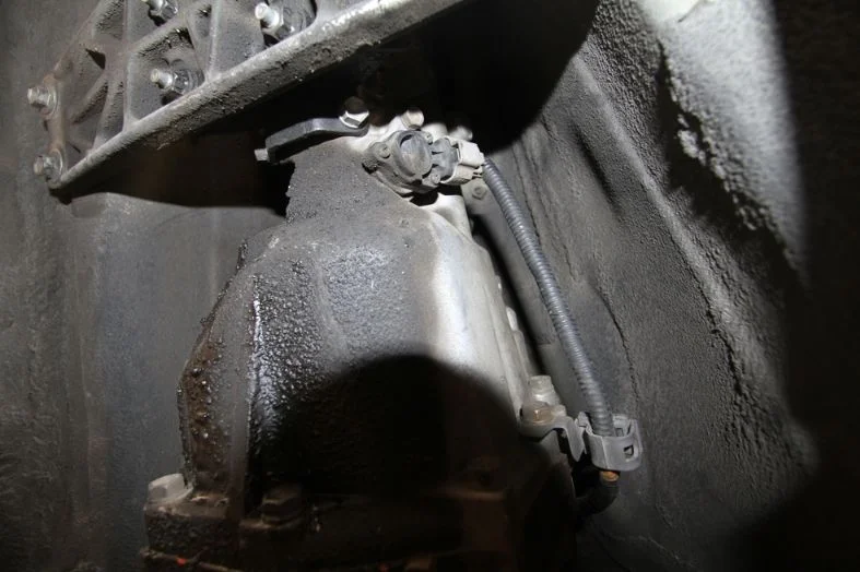

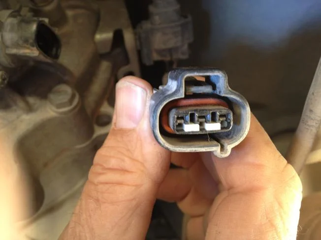

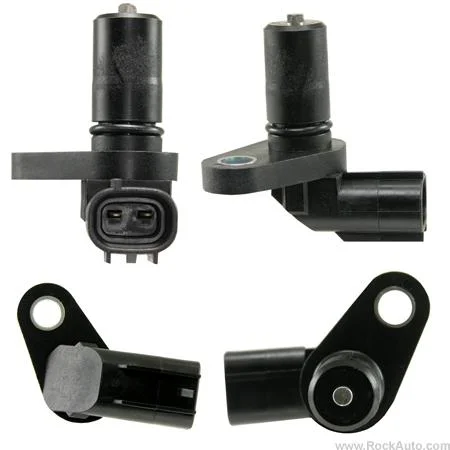

Some time ago back in the Fall of 2019 I emailed Yellow Box (Official home page of the Yellow Box Speedo Recalibrator - https://yellr.com/index.htm) and their reply was:
"Yellow Box is likely compatible with your Lexus, first we would need to confirm the type of speed sensor used.
Attached are some photos if your Lexus has this same 3-pin plug set at the Output Speed Sensor, then Plug-n-play Harness is available. The Output Speed Sensor is typically located on the transaxle/bell area of the transmission.
If your Lexus has a "2-wire/2-pin" Output Speed Sensor then it will require "2-wire" unit and Splice Harness only."
here are their attached photos:

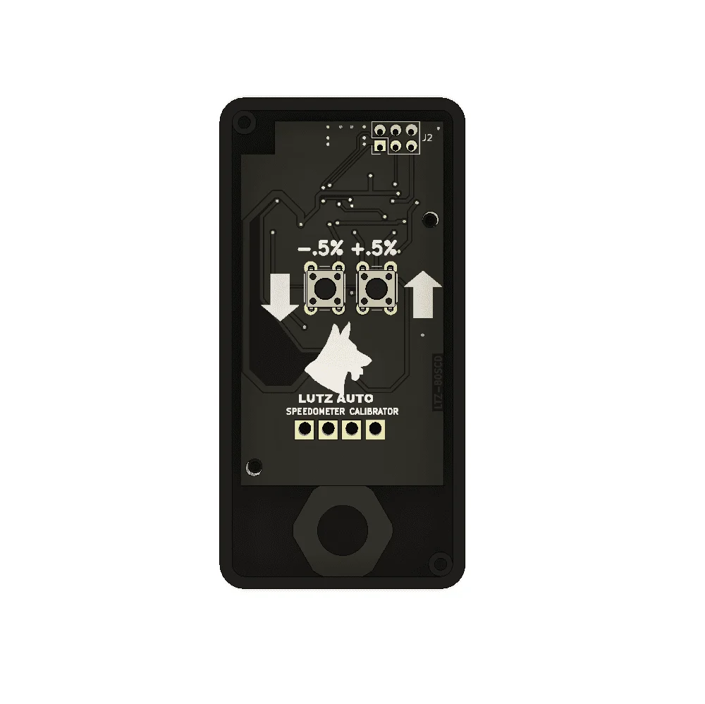

Perhaps an option for someone to work with
Wow, that's a great detailed install description!
(too bad it's for a Sequoia...) :(
Looking at their vehicle selection it was all for motorcycles and I think side-by-sides. Nothing for cars, SUV's or trucks.
Wonder how that fellow with the Sequoia figured to use the model he did? I'm guessing he bugged their tech support. :meh:

Lutz Auto is willing to provide a product if they can get a donor vehicle to validate the install in central CA.
SHOOT!!! I'm in So. Cal otherwise I'd let them use mine!
