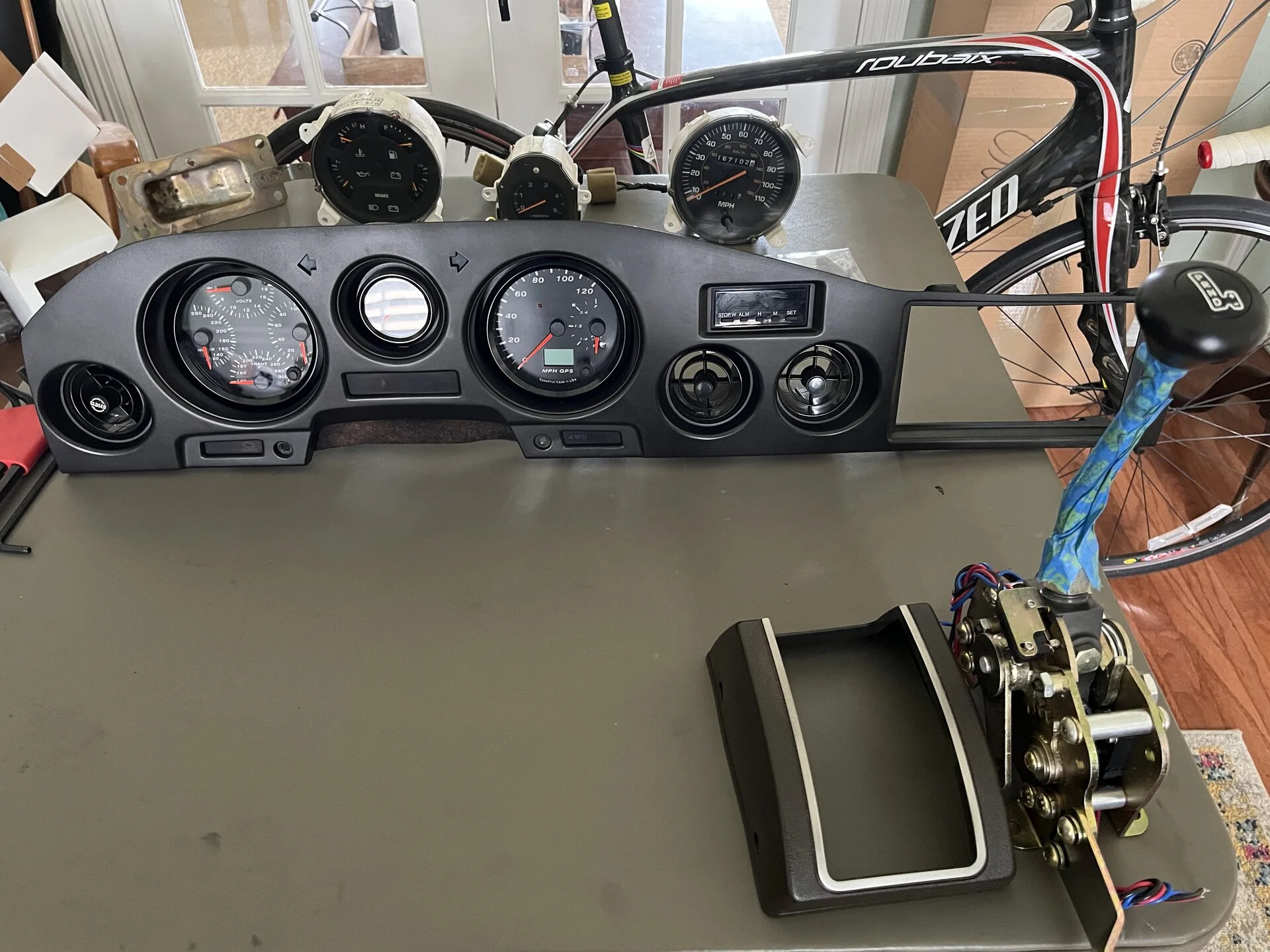

Here’s my mock-up. Couple questions:
Where’s best place to tap for the ignition and dash lighting source?
Did anyone tap into factory dimmer switch, if so, would love details.
Is that a lokar trim ring? I have been looking at that shifter for my ls swap.
Ha, I too have been trying to figure out what to do there. It’s the original 62 automatic shifter surround and not sure about cutting it up. Nothing fits perfectly due to the cable arm sticking out. Another idea I had last night was to use another parking brake fabric cover but again, it won’t ever fit flush to the floor.
My Lokar in my 60 uses the stock 60 series shift boot.
My shifter is for a 6L80e with sport mode tap up/down and has a cable arm sticking out the back. Seemed like the only option when I got it.
I think a leather boot with nice trim ring blends well in most cars.
We use the large Lokar boot and ring with the sport shifter. ...70series
J
Thanks @TRAIL TAILOR do you make some sort of mount to allow the cable arm to stick out or how do you deal with that? Looks like the 70 size boot it only 6 1/2” long. TIA!
