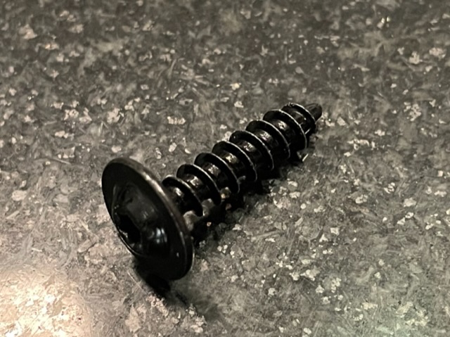

Ok, so thanks to the advice in this thread and after looking at the markings on the OEM speakers (all 4 Ohm) I’ve replaced the four doors. I can confirm that the Pioneer TS-G1020F work almost fine in the rear - I had to clip the Y shaped plastic grille inside the grille, and the TS-G1620F (front) work fine if you use a small spacer to move it away from the rail. I used a plastic wall anchor, clipped the top part, drilled a hole just right for the screw to go in and hold it (was going to use a washer at first, but then realised that the moment I ever try to remove the speaker, all washers will fall into the door), and then used it as a spacer. I did need longer screws - a 6x30 wood screw would’ve worked very well, but I couldn’t find any, so instead I used the medium size BMW T20 screws (like the one that holds 90% of the dash together). And now I get insane static 😂 but I really think my head unit is burned because SOMETIMES I do get sound, so that’s next anyway.
