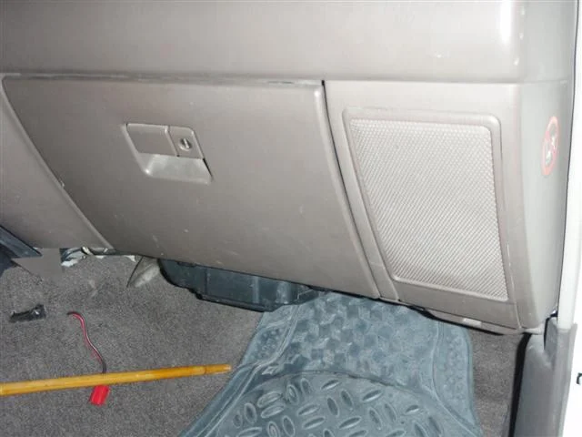

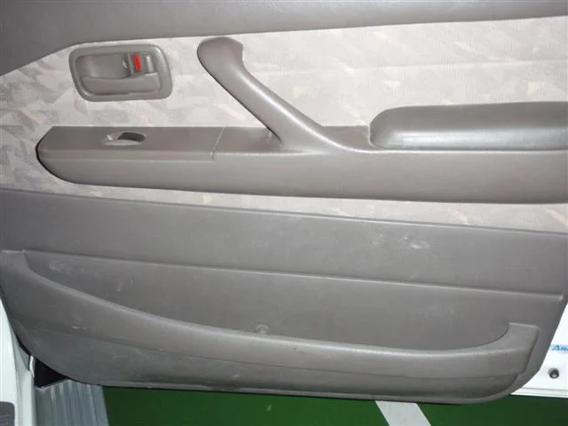

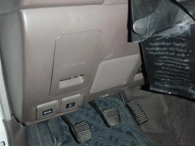

Turns out that my cruiser doesn't have front door speakers! I have attached the following 3 pics to show the 2 speakers that are located on the bottom of the dashboard and the passenger side door to show how there isn't a place for the speaker! Is this normal? I'm guessing I have the bottom of the line basic stereo system and that's why I don't have door speakers! Should I install door speakers if I decide to upgrade the system, which means that I have to cut away at the door panels, or not?

That's how it is on some models. Mine is a mid-east spec VX trim model. I opted not to hack the door panel. Just put in slightly better speakers. :)
