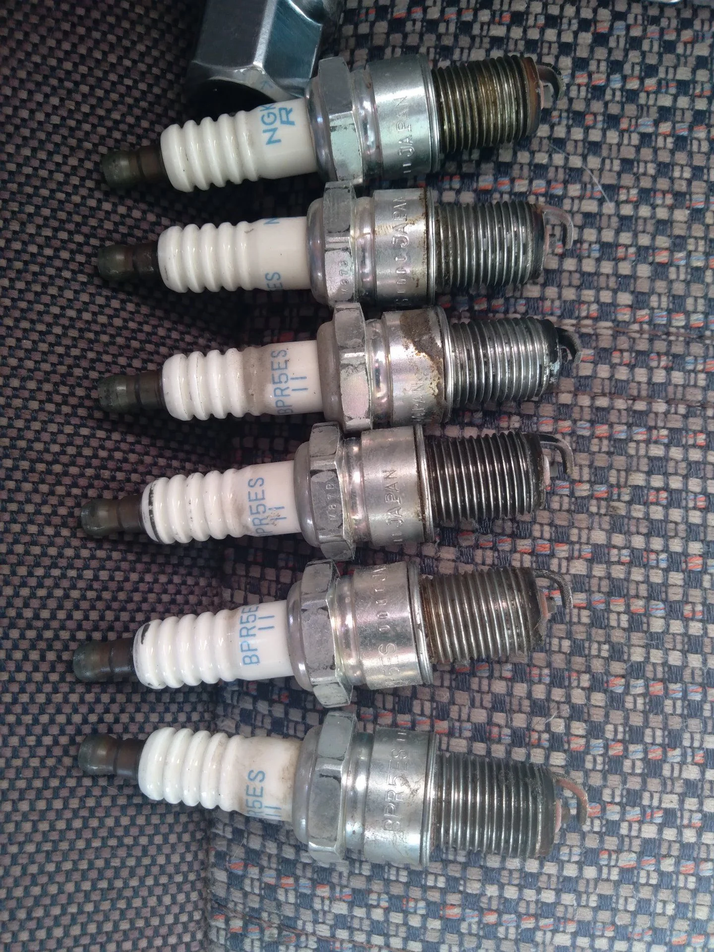

Hello Mud,
I took off my spark plugs from my 92 3FE to see what condition they were in and see if everything is normal. What prompted me to do this was coolant loss so I want to triple check its not HG failure, before replacing everything in the cooling system. These plugs were put in about 6000 miles ago/2 years ago. Please let me know what you think. Plugs are ordered 1-6 top to bottom.
Note: I noticed plug 4 was "wet" on the threads and on the surface of the head. I'm 90% sure its oil, but I could not tell for certain.

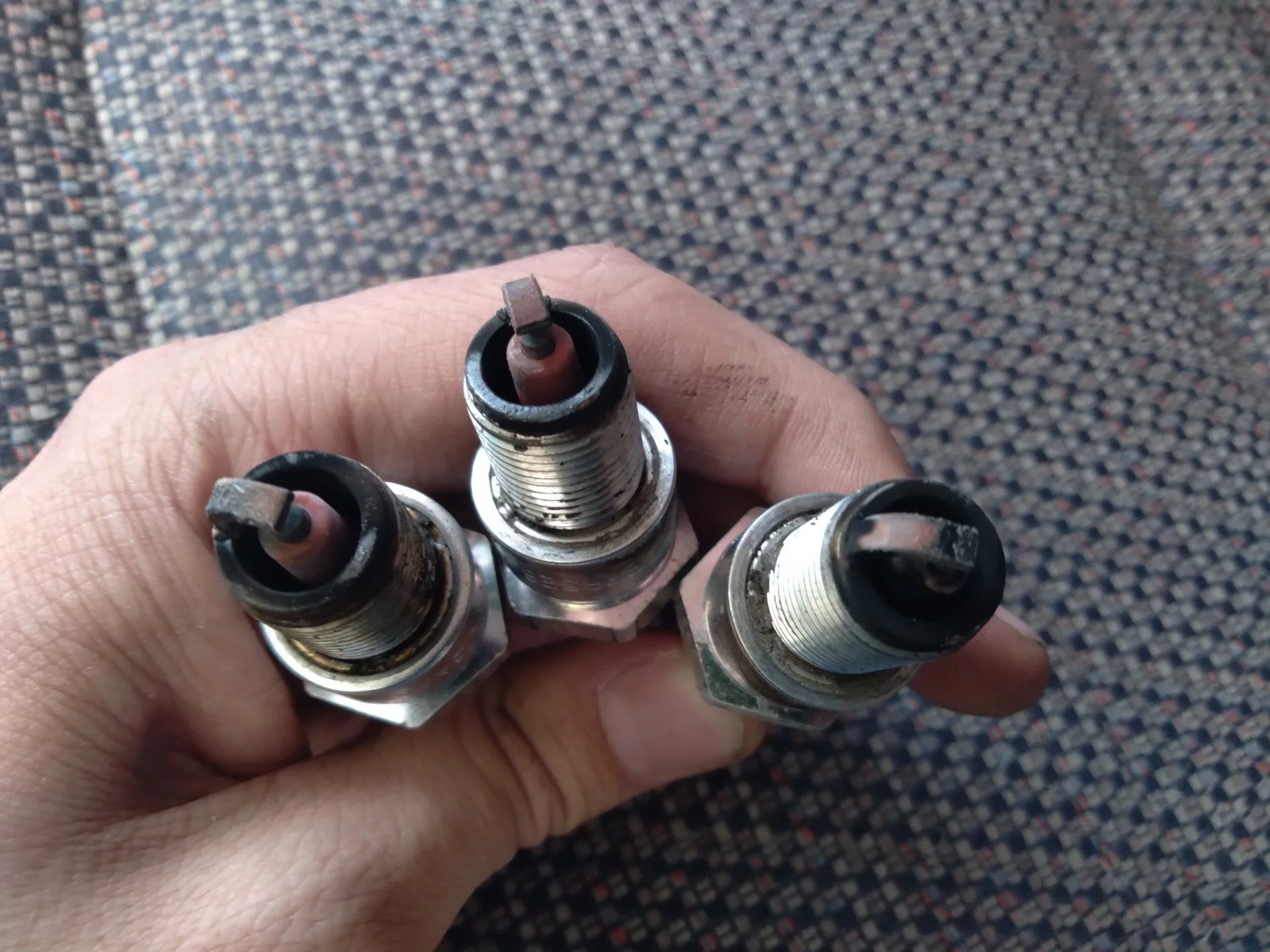

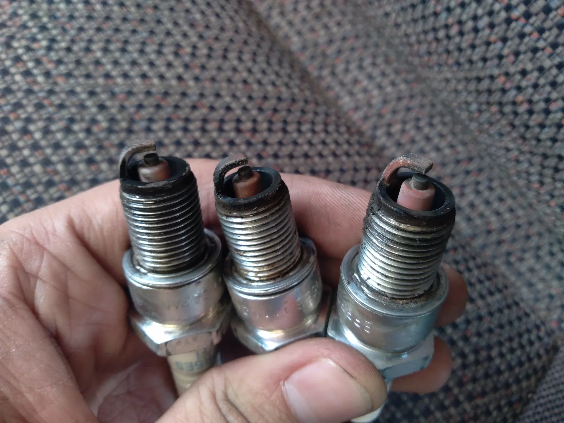

How about a better pic of the electrode end?
Initially:
#1,2,5,6 look good. No issues
#3 is running rich and maybe a little oil.
#4 may have a little oil, but nothing much.
I see nothing there indicating HG.

I stand by my first statement.
Fantastic! Thanks for the good news and quick help.
