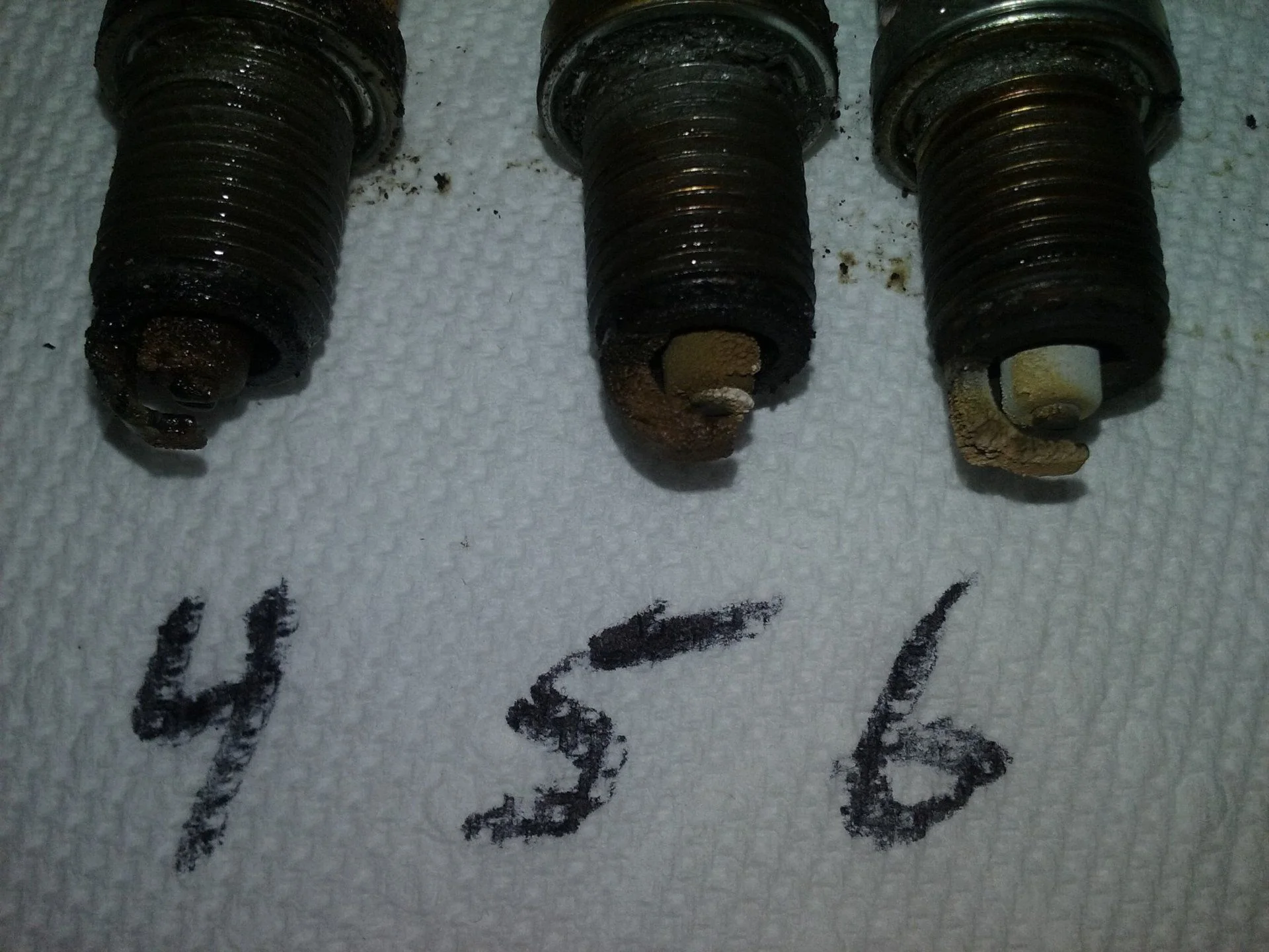

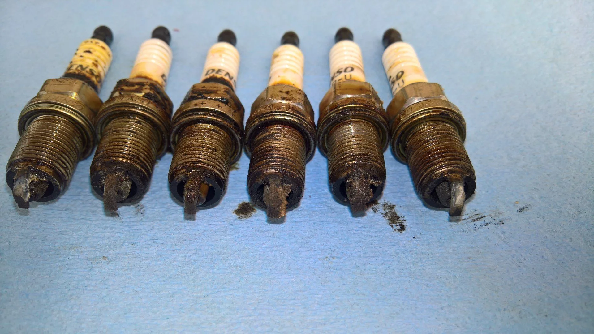

Here's a few photos; look like they've been in there way too long along with some oil fouling, got a one time misfire in #6 and that plug (far right) is a bit cleaner than the rest, but it doesn't look steam cleaned. Distributor cap and rotor were also very worn, they've been replaced. Yazaki spark plug wires marked 2003.
(#1-#6 left to right: click on the photos and magnify for a close-up view)
Note the significant build-up of deposits on the side electrodes, except #1 and #6 (cleanest).
Hi, While these trucks are not speed rockets,it amazes me that people don’t do simple maintaince on the trucks. Yes they are slow when you don’t maintain them. Mike
I'm not surprised that it was still running, perhaps a testament to the fine craftsmanship. It's ashame to see things like this though. Plugs are cheap & easy.
The 80 I'm working on (plugs at top of thread) was running OK even with the fouled plugs, felt maybe a bit less power than my other 80 that's up to date with it's PM. I am concerned about the fouling, the valve stem seals likely need replacing.
Just changed mine last week along with plug wires and tube seals and though mine were in bad shape. Plugs were gapped way to wide and had some carbon buildup, runs night and day better. But mine didn’t look nearly as dirty so I consider myself lucky.
Those look to be original plugs.
There is some oil fouling and some fuel fouling, but the gap is so huge, I would discount what I see there as a "diagnosis".
I would bet the valve seals are toast as well, but how deep do you want to dive?
The gunk on the threads on #4 is from the bad plug tube seals and the oil getting cooked on the threads as well as oil from the cylinder firing.
Use a good clean old plug and some solvent and oil (PB Blaster would work well) to loosen the gunk and run the plug in and out numerous times to clean the threads. Do NOT use a cutting type tool to clean those threads.

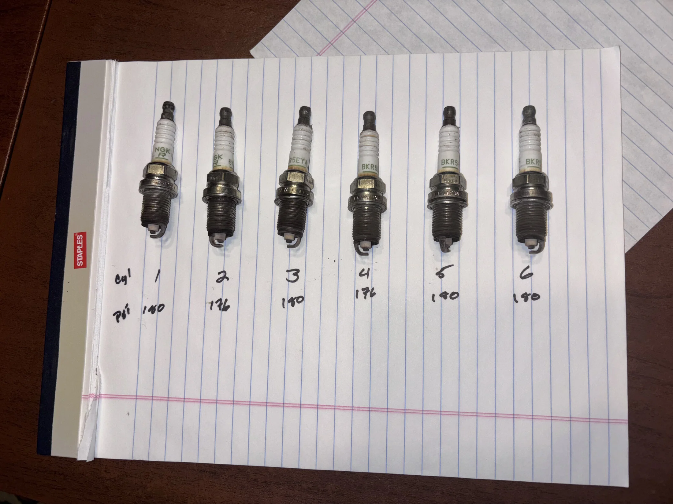

As part of getting the '94 with 235k miles ready to hand over to my daughter, we replaced the plugs and ran a dry compression test today. The plugs had been in for 18-21k miles based on date. The gray on #5 is only on part of one side, turn it 90 degrees either way and it looks like #1. To my eye, they seem fine, no real carbon, dry and light gray ash.
Dry compression seems pretty good as well.
Replaced with same NGK BKR5EYA - for $1.12 each(?)!
