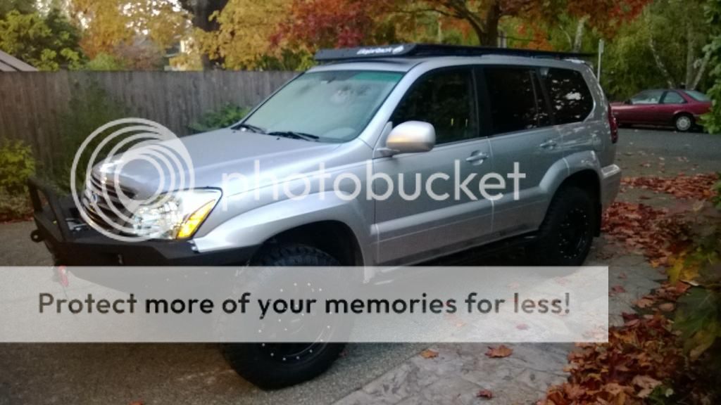

I'm looking to do this to my 06 GX with KDSS. Could you tell me what you did with the suspension and how tall is the lift in the front, back and overall? (Tricking the rear air bag, adding aftermarket shock absorbers to the back, front coilovers)
How do you go with the 33s? I was under the impression that without a significant lift (4" or more) they would rub and grind on everything front and rear. Have you found this to be true?
THats awesome!
No, I dont rub on anything noticeable unless im at full compression with my wheel turned full lock to the driver. Even then it just catches the plastic from the old running boards and makes a noise a bit. I have seen a very small amount of paint rubbed off the body mounts, so it would probably be beneficial to go ahead and do a body mount chop. I havent done so, cause it really isnt bad at all. Any tire larger though, and you'll definietly need it.

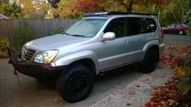

special consideration is necessary at that point because the frame does flex quite a bit causing that particular point to come into contact with the headlight housing or the fender itself. I erred on the side of caution so to not cause any damage to the customers vehicle.
I have, for a time, had an idea in my head to manufacture some nice looking cover pieces that would go between the oem fender and the SouthernSS bumper but I've never found the time. If a customer is particularly worried about that section, I have a simple and elegant solution.
What about a color matched piece of rubber? Looking good either way. ;)
