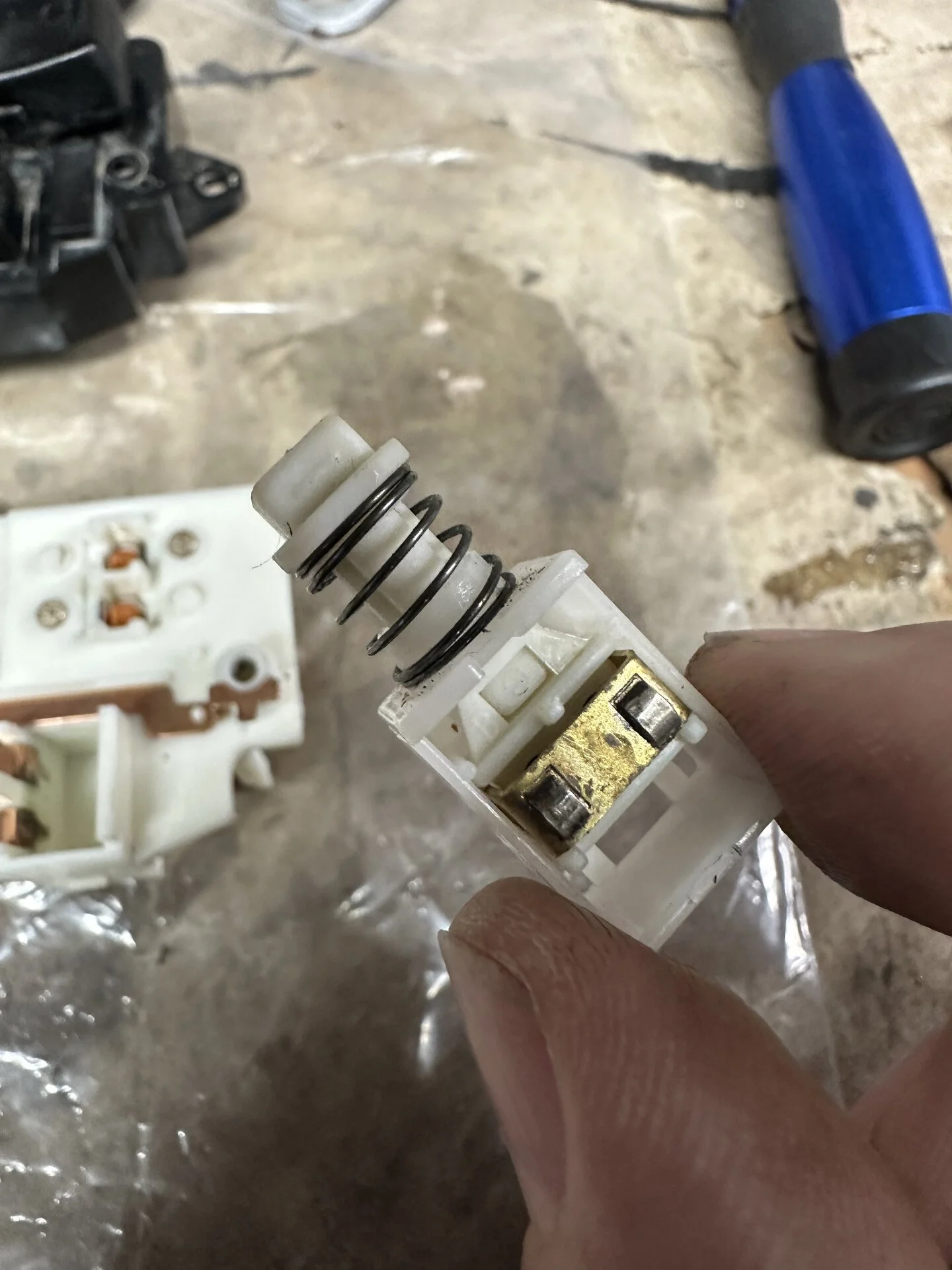

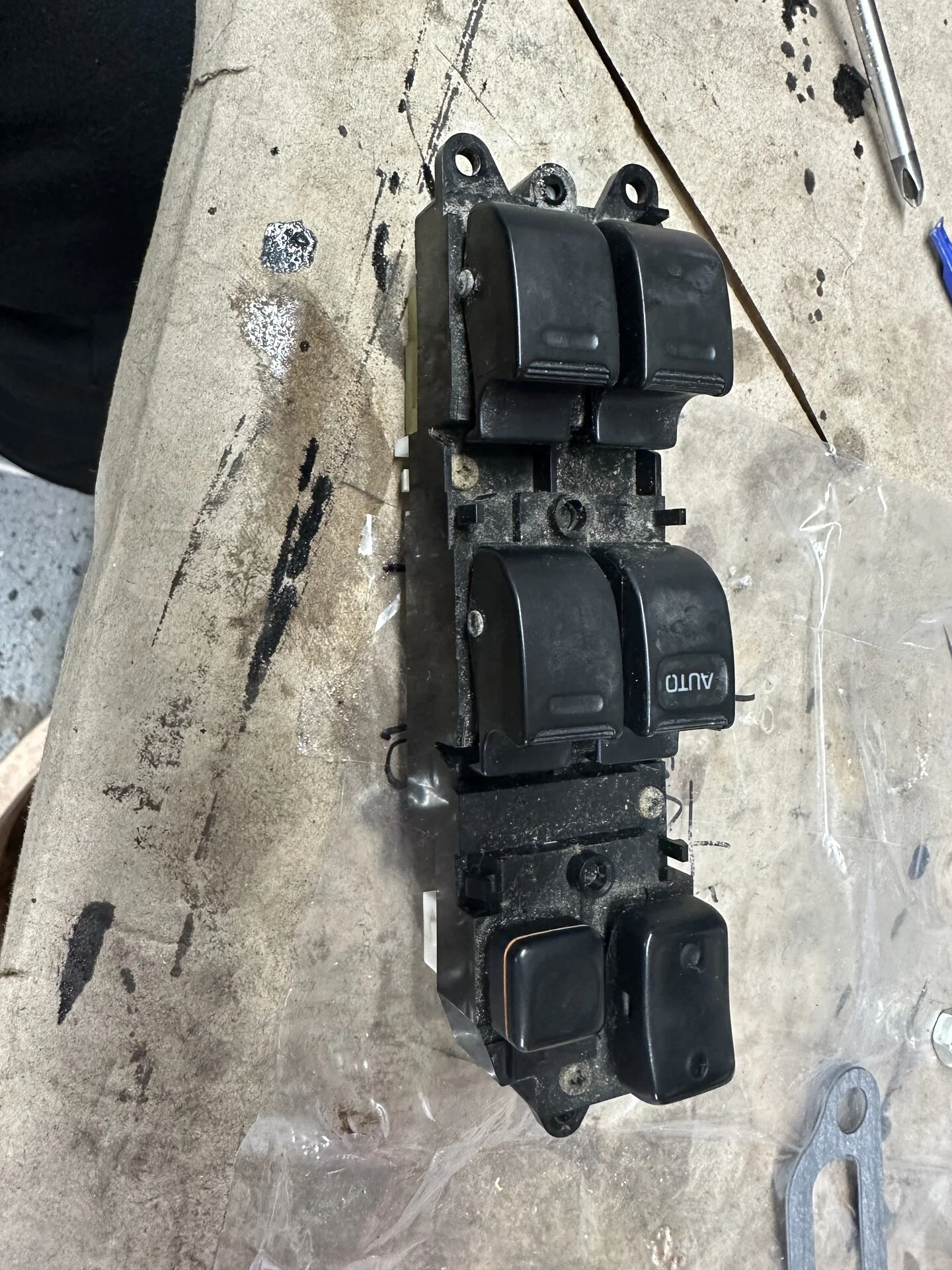

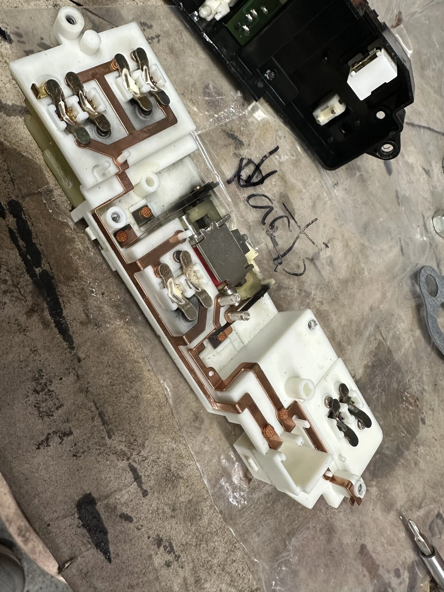

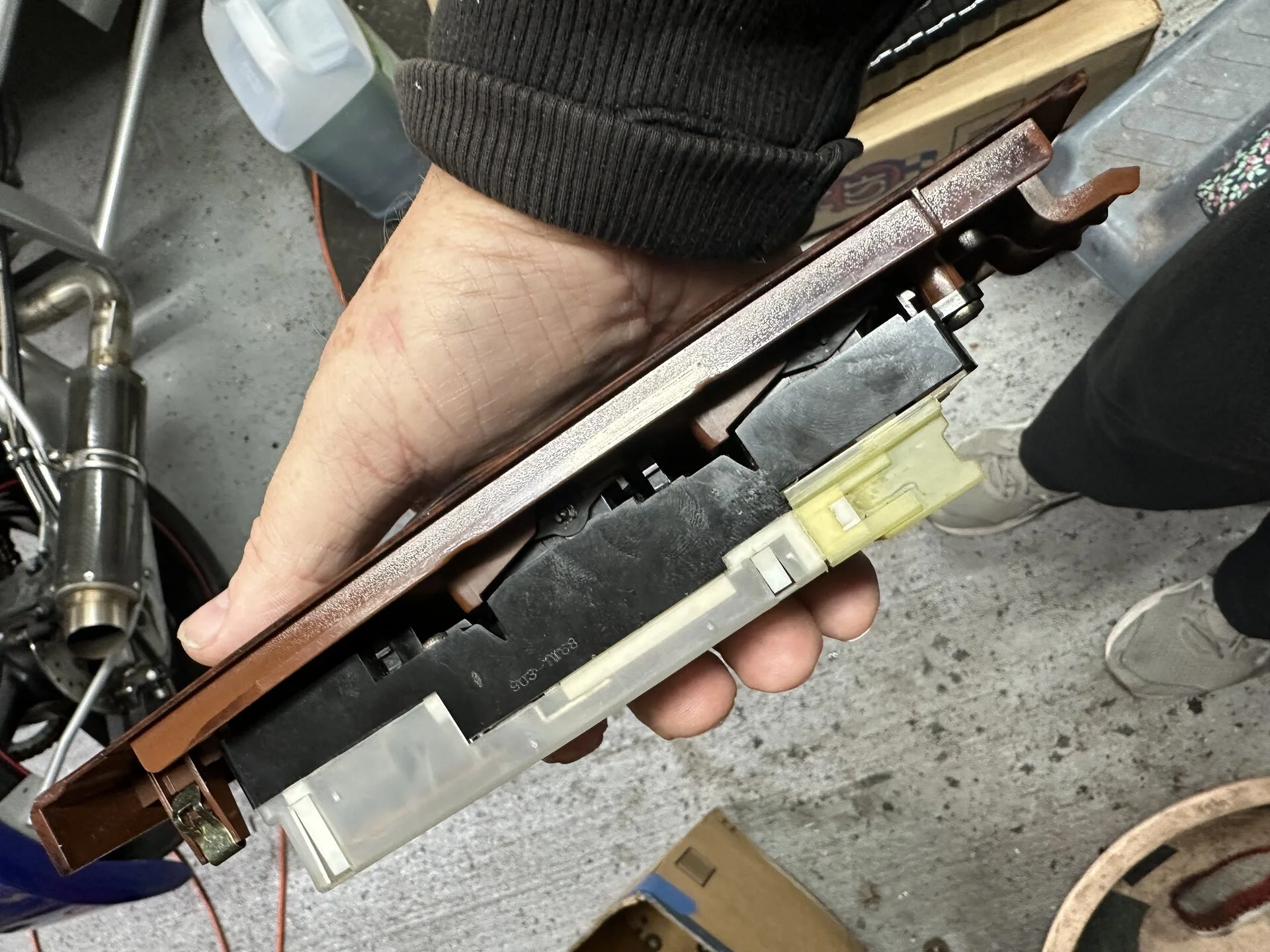

Drivers side window would occasionally not go back up after opening the window, so decided to clean the switch On the drivers side door.
Easy to remove leverage up at the front, and then unplug the connector. Little bit of crusties, but not bad. Cleaned up with some vinegar and q tips.
flipped it over and removed the three screws holding on the cover. And then removed the white plastic cover on the bottom.
there are four screws holding the circuit board to the switches. Very carefully remove the screws and carefully remove the circuit board.
then you can see the contactors and two springs. Best to work on a clean surface so things don’t get lost in the mess.
the contactors are not fixed, they just sit in their little seats. Remove one by one and clean with sandpaper or nail file.
note the window lock switch is a push button with a small spring to latch on, latch off.
the first time I put this back together the black spring had sprung out, so the latch would not lock. The key is to remove the top of the button from the switch itself first.
after that, simply reinstall everything and enjoy the almost new switch for about an hour of your time.
I've seen the same issue just rather it was extremely slow to go backup especially in cold weather. Probably more of a track issue then contactor for me but good to know you can get these back to like new condition. Nice job!

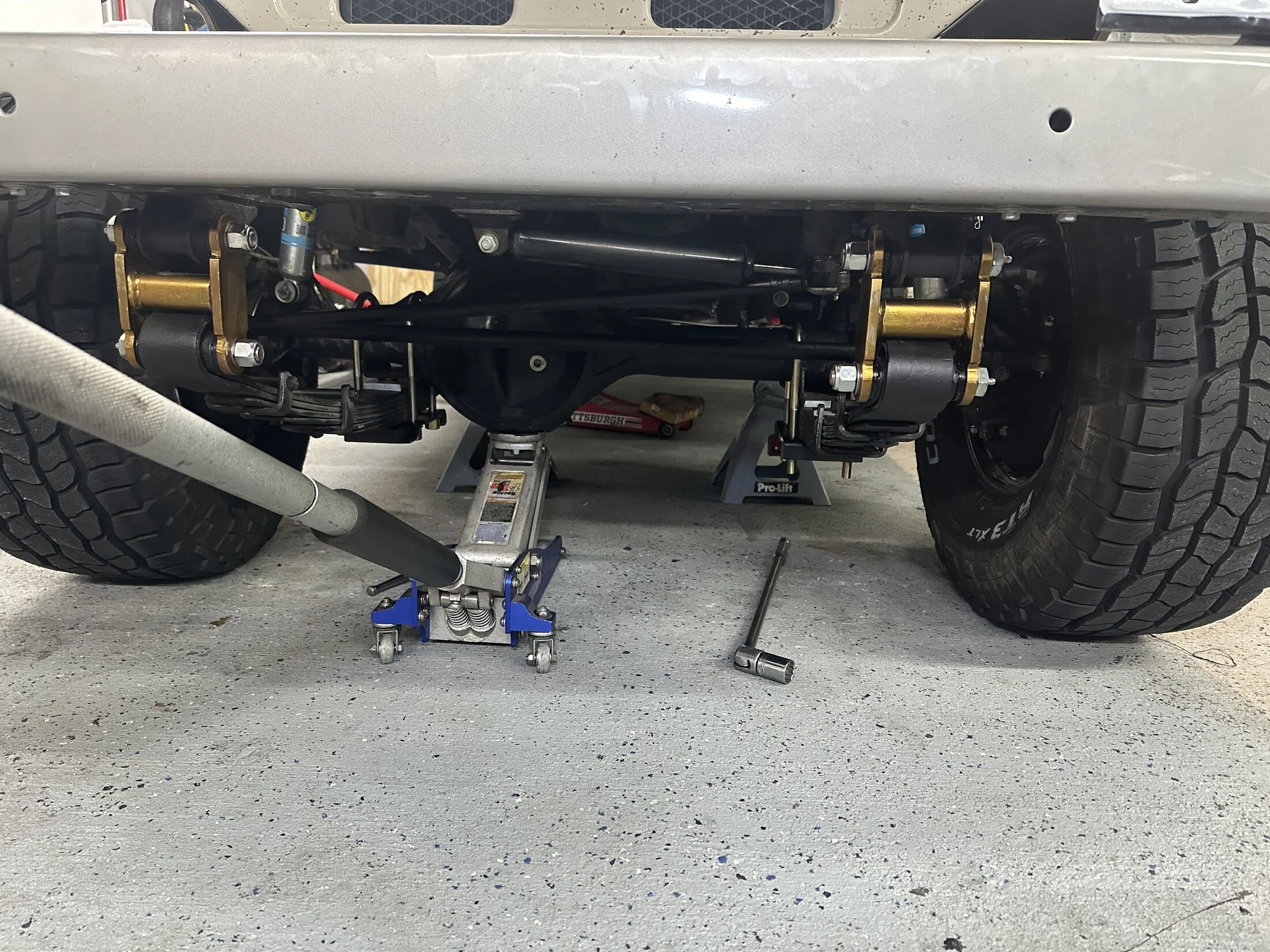

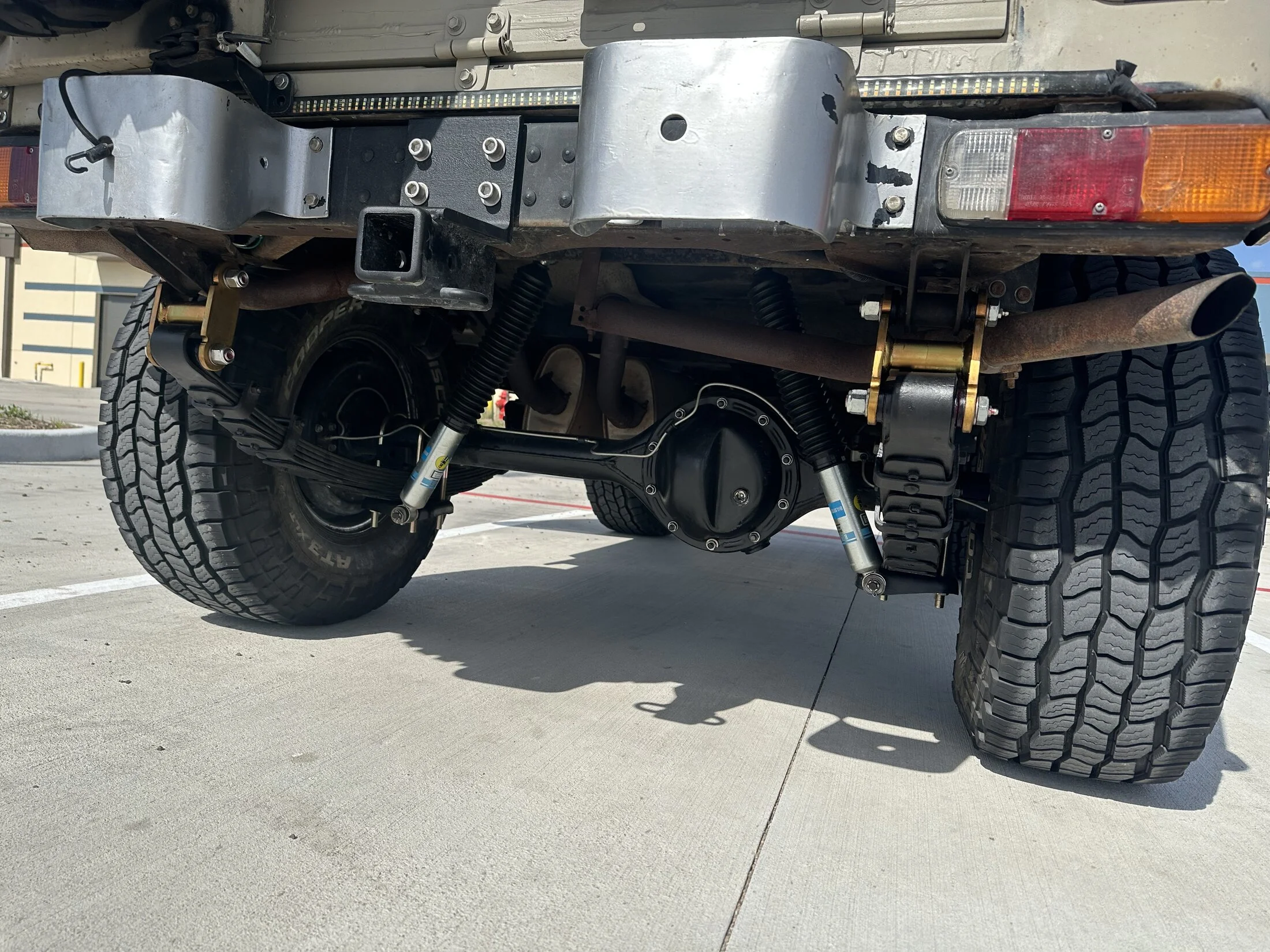

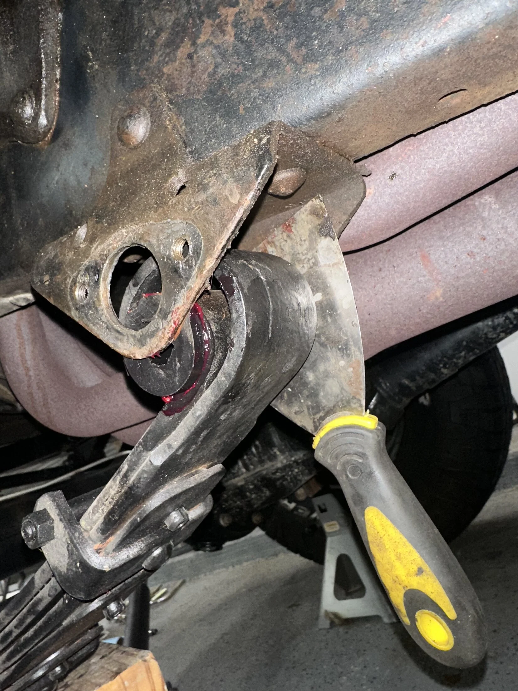

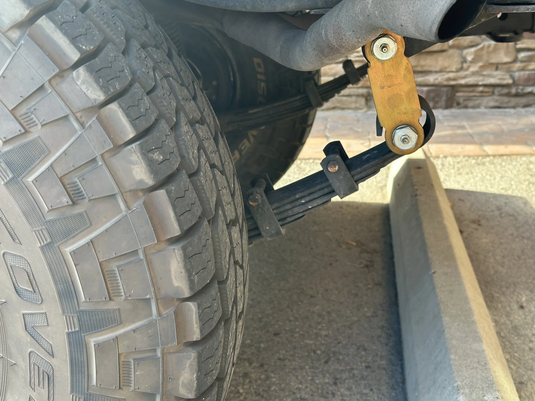

Two weeks back drove up to Dallas to Cool Cruisers of Texas and picked up a set of HFS springs and shackles. I thought it only fitting to take the 97 Series 80, and on the way back rolled over 365,000 miles. Very satisfying, now I need to do an oil change!
This weekend installed the springs and new shackles.

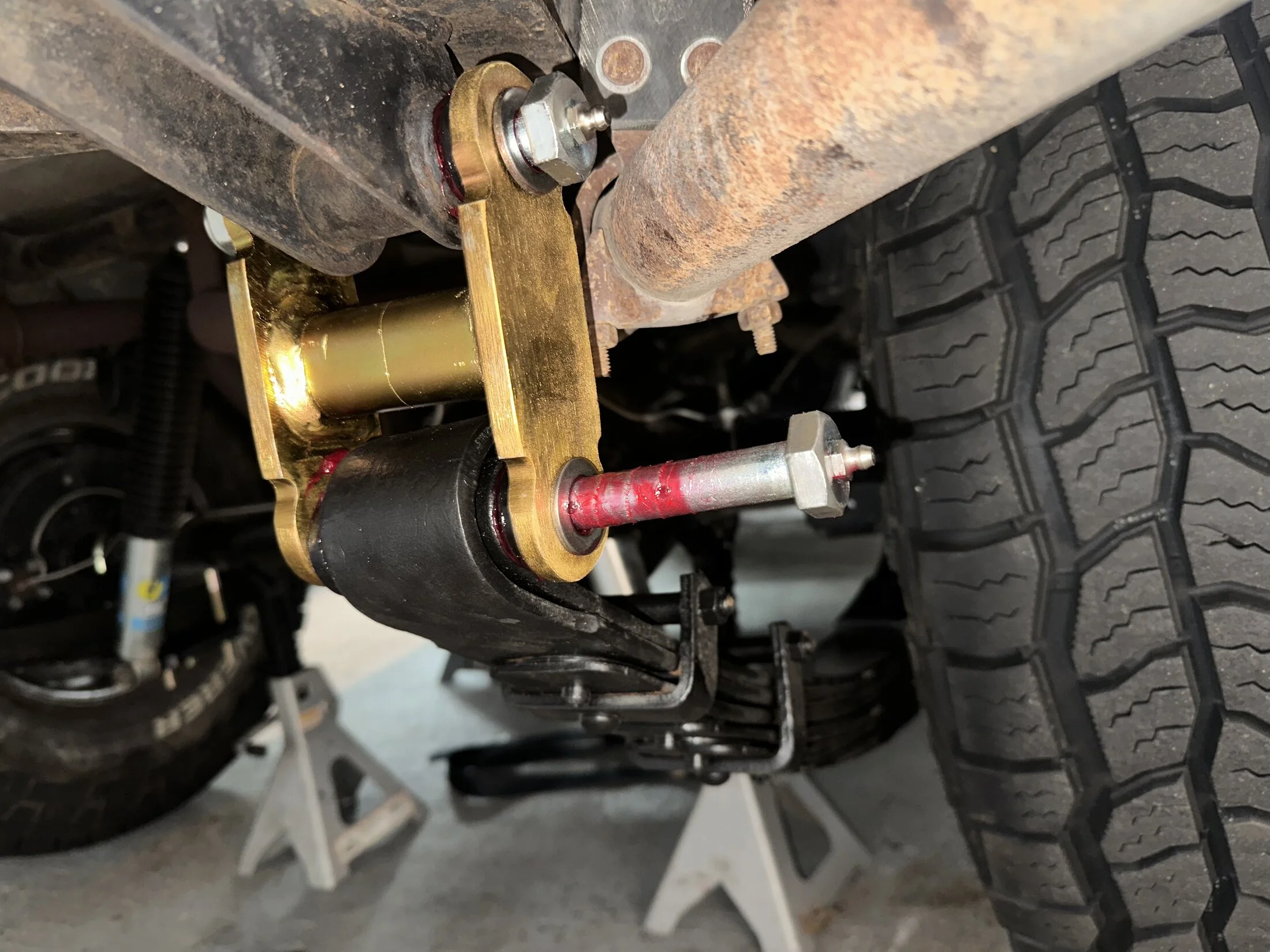

The frame mount with new bushings are quite tight, so I have found a thin metal drywall tool allows to get one side in while the other side just squeezed in.
It helped to leave on of the shackle bolts only 1/2 way installed to let the spring twist a bit to get the frame side bolt installed. I. Struggled with the first three, but the last one was just pushed in by hand.
Took it for a quick shakedown drive to settle everything in.
Front and back look great.
Back view
This weekend installed the springs and new shackles.View attachment 3867466
The frame mount with new bushings are quite tight, so I have found a thin metal drywall tool allows to get one side in while the other side just squeezed in.View attachment 3867467
Back view

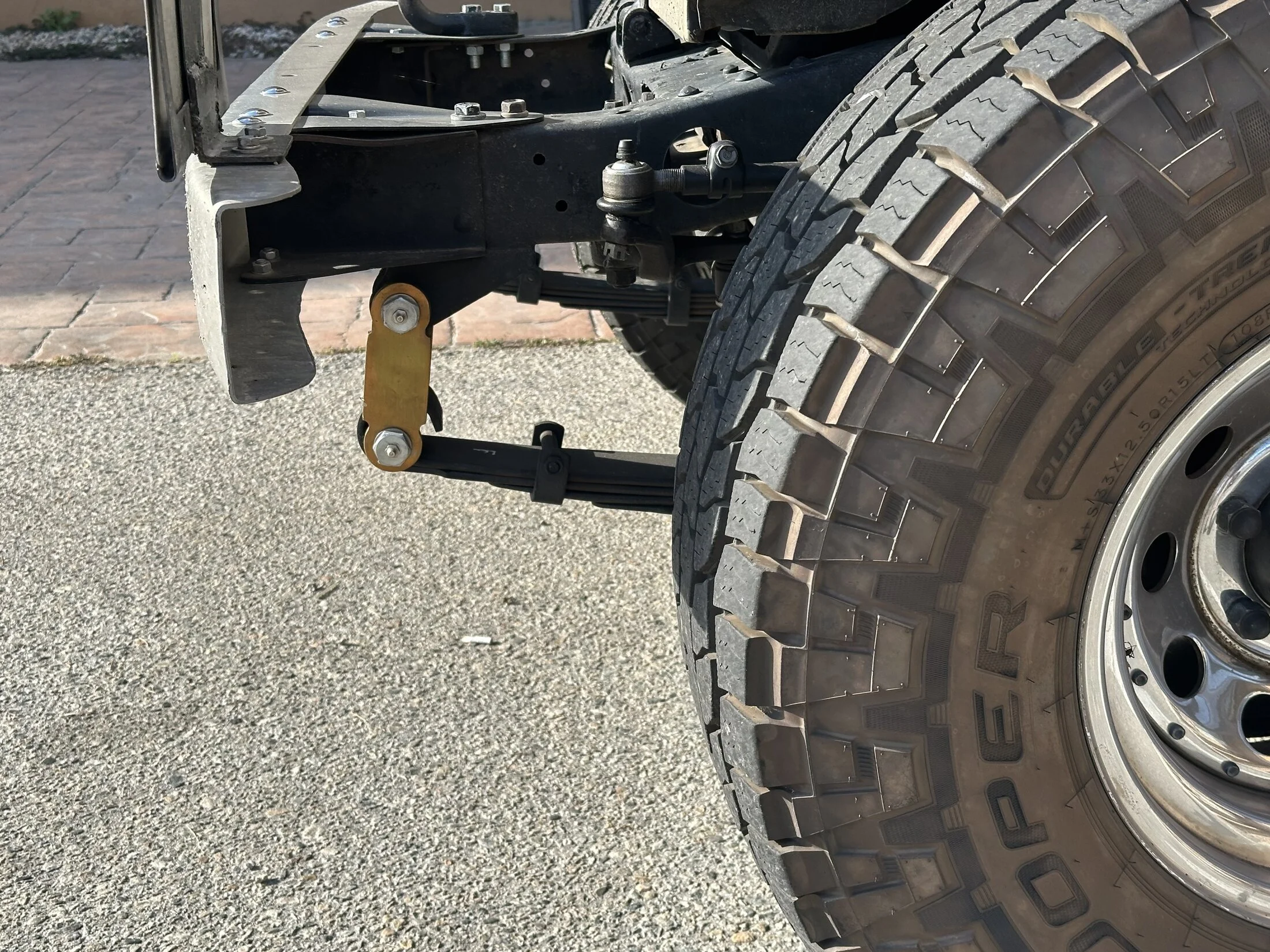

The front doesn't look great if that's the settled angle of the shackles. Hopefully the jack is taking weight there and the shackles go the other direction when completely laden with truck weight. I'm also along for your updates. Soft topping it to AK in a 40! :)
Looks like he was in the middle of the install, the u-bolts aren't torqued and the axle is raised

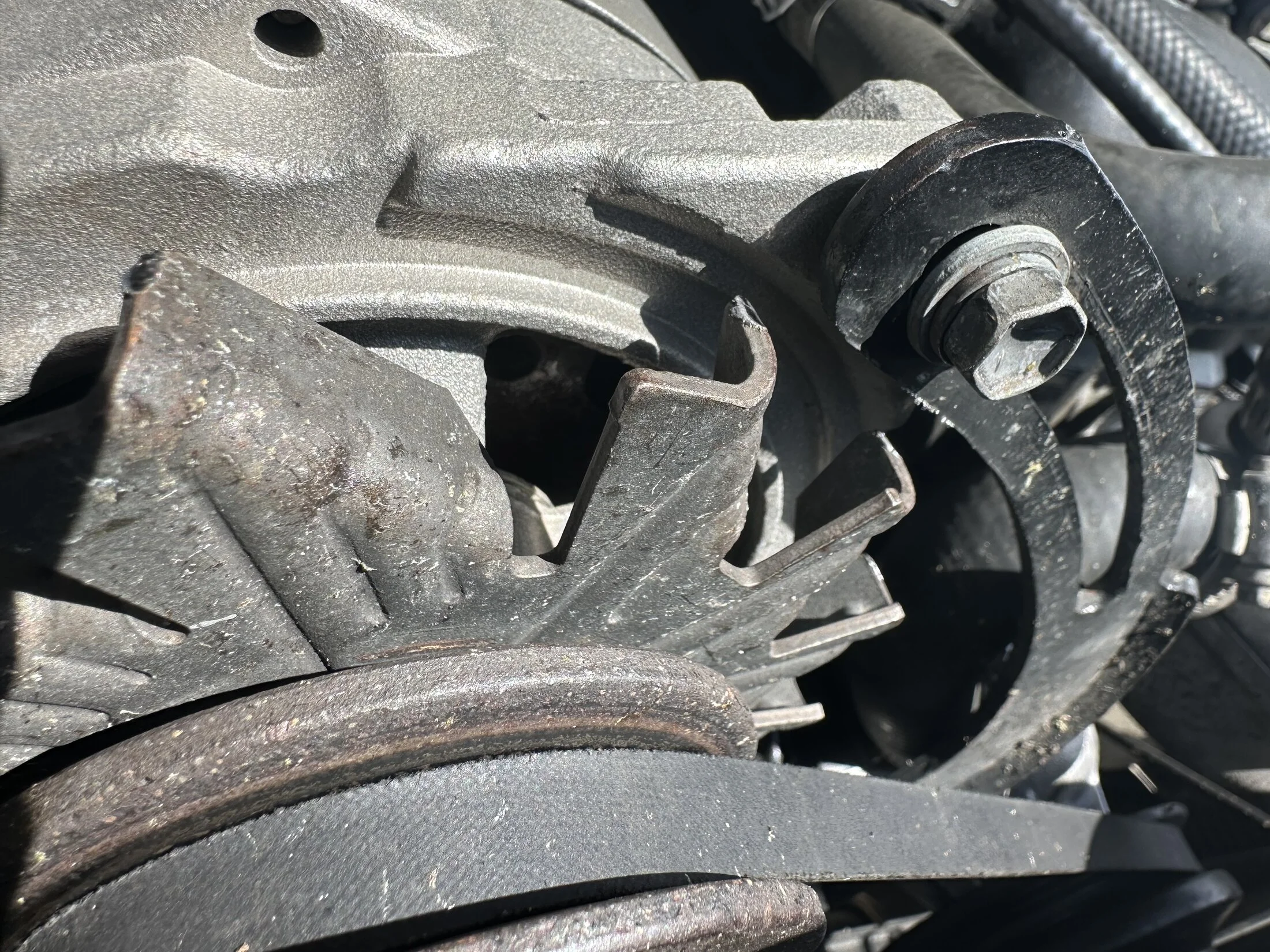

Heading out of Merritt noticed my voltage was stuck at 12.5. So pulled over to check my fan belt, which has honestly been loose for a while now. To adjust it had to move the battery tray back a bit, as the alternator was hard up against the battery. Got that done, but when I started the truck a terrible squealing sound. But it was charging at 14.5. Figured the bearings or something, so decided to return to Merritt and find a mechanic. Shawn at DCS automotive was very helpful, and had me start the truck while he observed the alternator. Turns out the strut holding the tension on the alternator was touching the metal fan on the alternator. The shaft of the bolt was too narrow and when I cinched it tight, it was on the low side. So scraping the fan. Fixed that, Shawn would not take any payment, and sent me on my way.

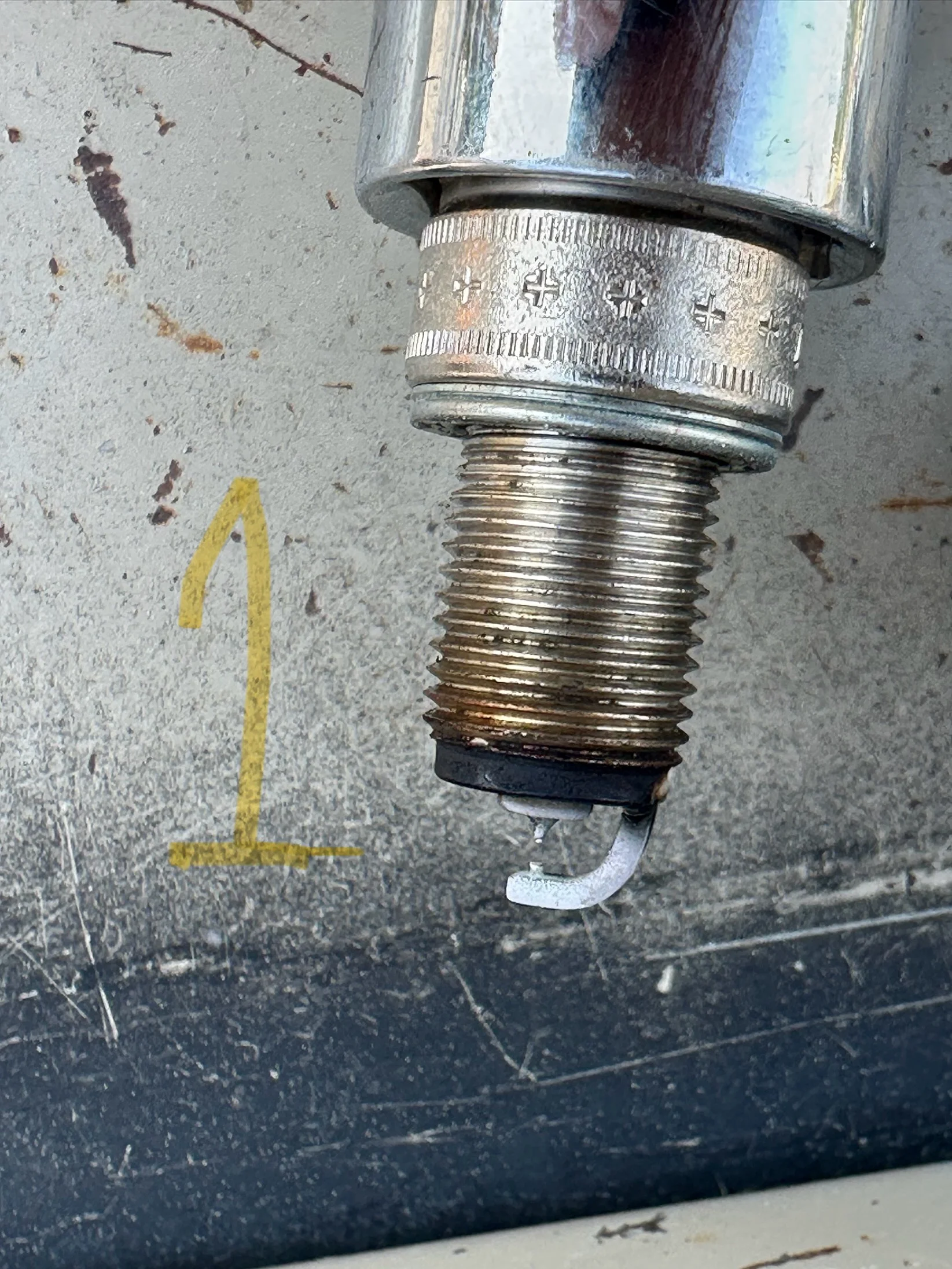

Before I left the hotel pulled the plugs one by one to see if something was obvious, and found plug for cylinder 3 was quite carboned up. Used a pocket knife to clean it up as best I could, and put them all back in. It seemed to run better initially, although I guess this could indicate a valve gap not set correctly, the plug going bad, or the plug lead is an issue.
Other plugs were much better/“normal” for example plug 1
Comments welcome on this. Not sure if I can find plug leads this far north.
The rest of the day to motor did not stumble, but on deceleration it would often backfire on me. I believe that is a sign of too much gas?

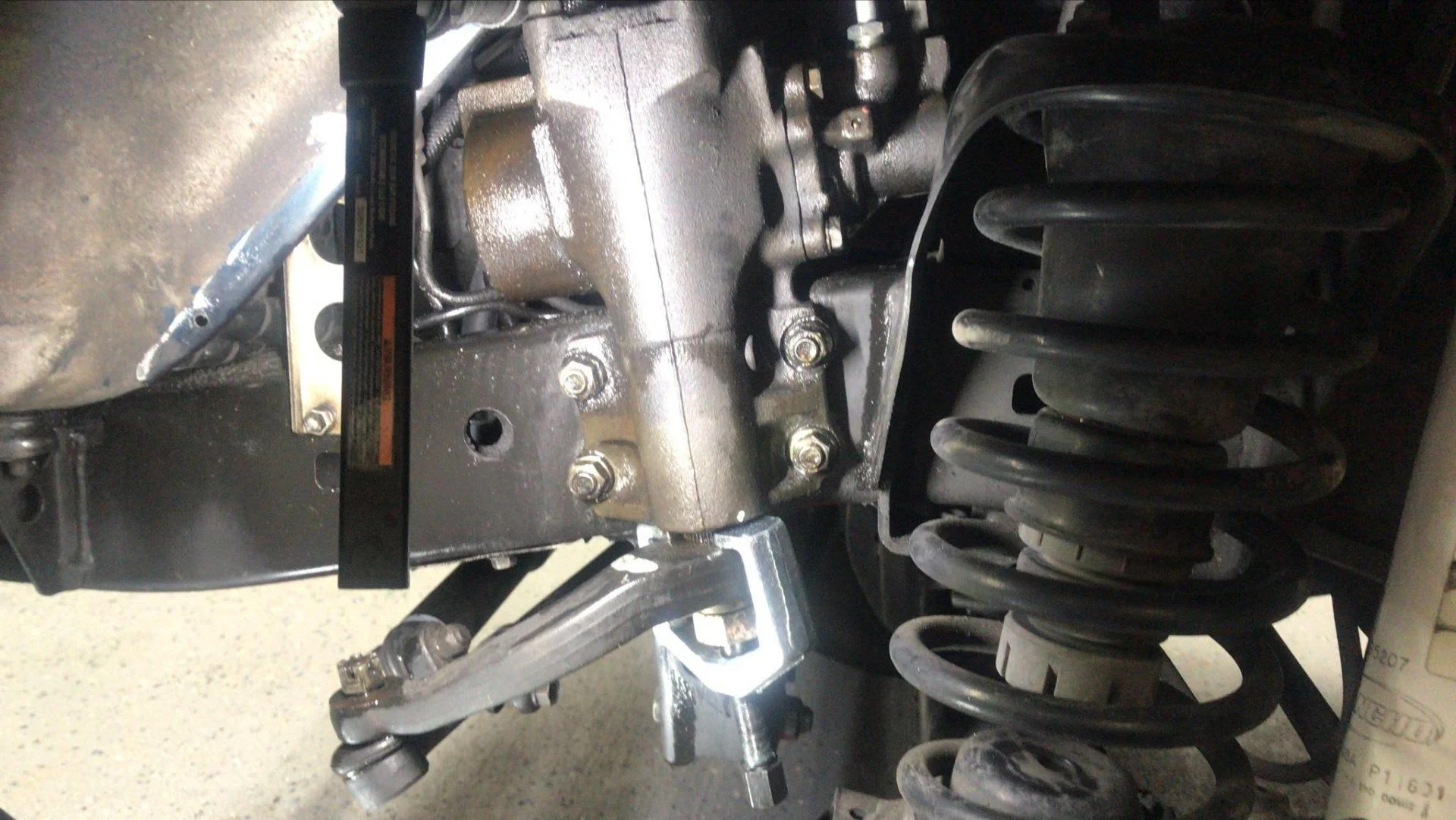

As mentioned at the top of the page, the steering box had a leak. the PO had replaced both the low pressure and high pressure hoses, but the issue was the seals. I read through the FSM on rebuilding the box, and I did not have all the tools, so decided to have it rebuilt by a shop. Reading through the forums, it seemed that ADCO in Houston did a good job, so took it off and over to them for a complete rebuild. 375USD + Tax and four days later went over and picked it up.
used a punch to put some index marks on both the steering wheel shaft input to the box, and on the pitman arm and box, although I could not get the pitman arm off, so left it on. It was easier to pop off the ball joint.

Sorry for the long distance recall, but once you had the steering box rebuilt, did you notice any decrease in steering wheel play. I’m down to replacing the box at this point. It doesn’t leak but I’ve used all the adjustment and still have slop.
No problem, yes the steering improved. You mentioned you had replaced all the tie rod ends? They can be hard to check with the wheels on the ground
So far I’ve replaced the TREs, added Delta Radius Arms and replaced the rubber steering coupler. I’ve made a 3/4 turn of the adjustment screw, and it’s at full stop. Only untouched item is the box. It’s bone dry so I’ve had no reason tk mess with it. My rig is almost 96% full restoration and running 33” on a 2.5” OME. No wheeling- Daily Driver. Tandem Off-road near me said they could rebuild for about $400. I was shopping online last night for an OEM @ $1800. Researching the Redheads(?) now.
