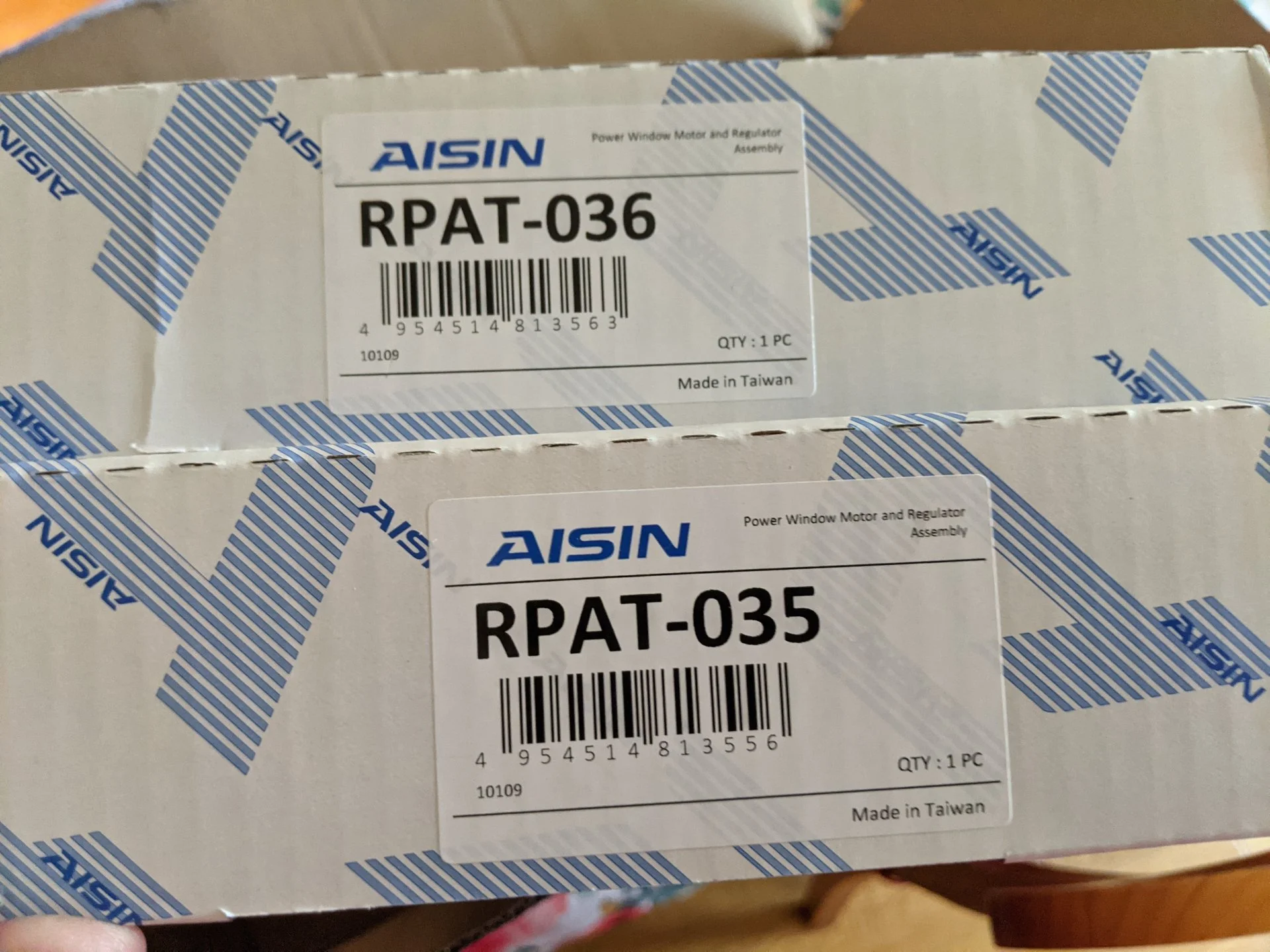

They had Aisin regulators with motors a few months ago, that's why also have a spare set of new regulators without, they got stock of them with motors in after I had already bought without. I can grab the part number later...
Jason
Jason
Here you go, looks like 035 is out of stock right now, but they have 036....
I did notice they are now made in Taiwan, and not Japan, but hopefully good stuff. I have not installed them yet, so I can't comment.
