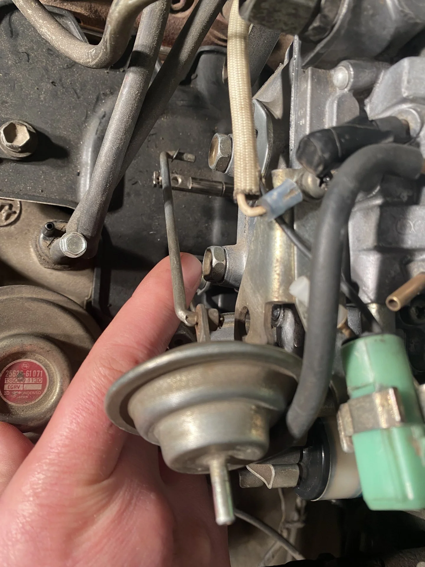

Now I am trying to get the emissions/smog reassembled and attached to the stock carb I just rebuilt. Put the carb on and it fired right up but without the vacuum birds nest all attached it obviously doesn’t run right. I hope I have all the parts I need for the smog, etc. but I know there are at least two parts missing on the carb. Parts that engage with two different vacuum systems.

- does anyone have a good source for finding these missing carb pieces? (see pictures) (I will put up a post in buy/sell thread)
- does anyone with more experience than me see anything obvious that I am missing at this point?

You looking for those specific pots for the carb? The company I found a few years ago who had small clutch of NOS vacuum adv pots can rebuild the ones you need. Lmk if you want their info.

It's a little hard to tell what you are looking for. Spector off road has some nice photos from all angles of the 1980 to 1987 carburetor at the bottom of the page here: Land Cruiser Carburetor Identifier - https://www.sor.com/cat042d.sor. Maybe you can use these to identify what you are looking for. The 2F engine manual also has detailed procedures for disassembly and assembly of the carburetor, so you might get some insight from that manual.
Toyota never identified the linkage rods as separate parts so you might have to find something used.

Looks like your carb might be missing some linkages?? I dont have those, but have detailed pics of my carb I used as references before I rebuilt it. PM me if you want either.
