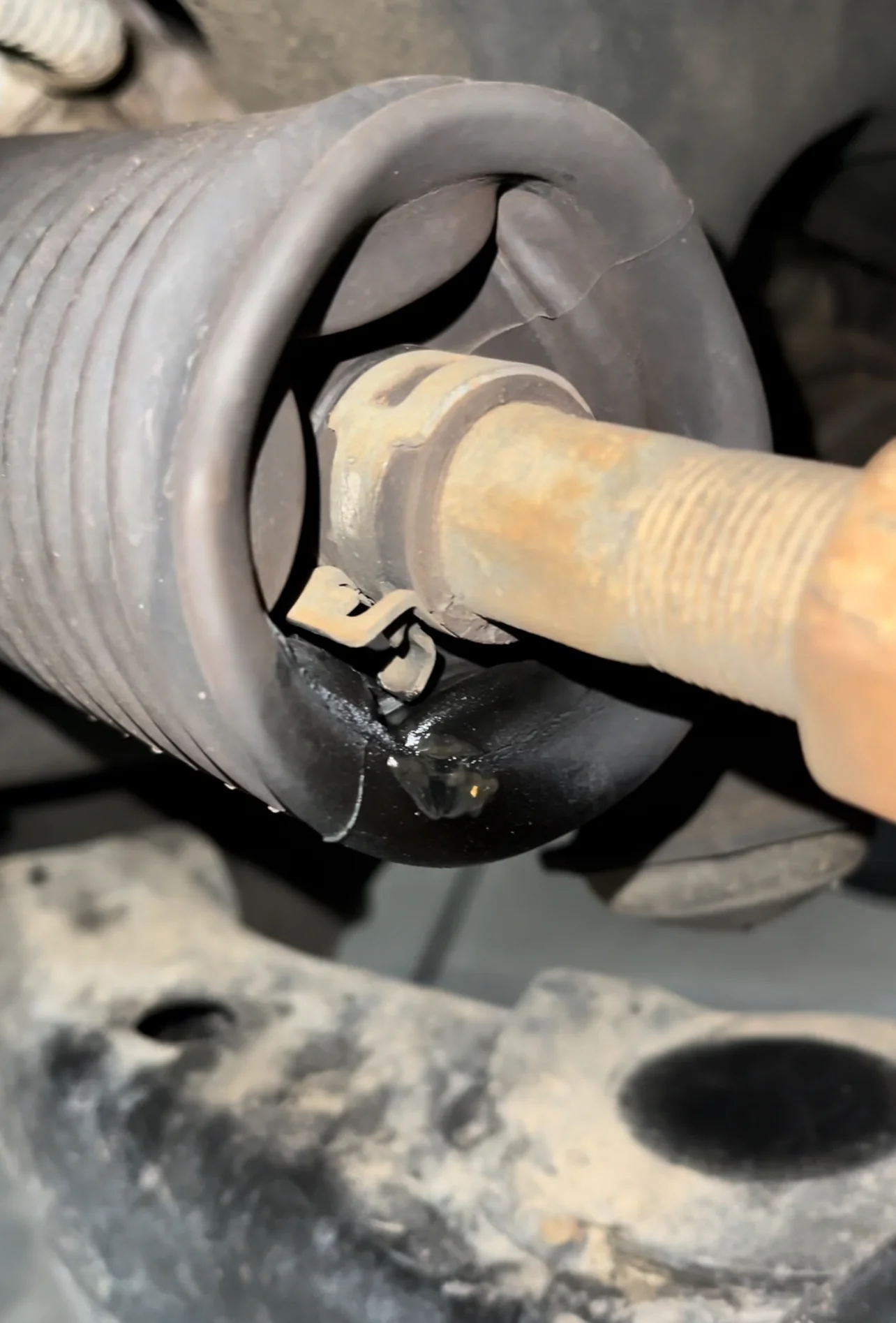

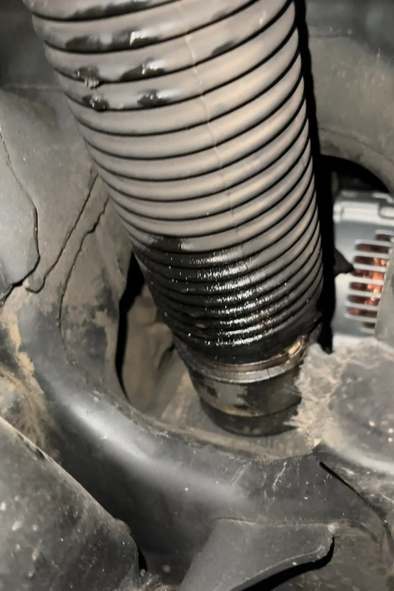

Recently, a new noise has appeared and it is in the front right. It is a slight grinding noise when turning right at low speeds (5-10mph). I am assuming it is my inner tie rod on the front passenger because i am seeing some leakage on the boot. Previous owner said the rack was rebuilt. Not sure why he didn’t replace the rack with an oem one. But here we are.

A grinding noise is not something normally attributed to a steering rack. I would add AT-205 to the power steering and you may stop that weeping.

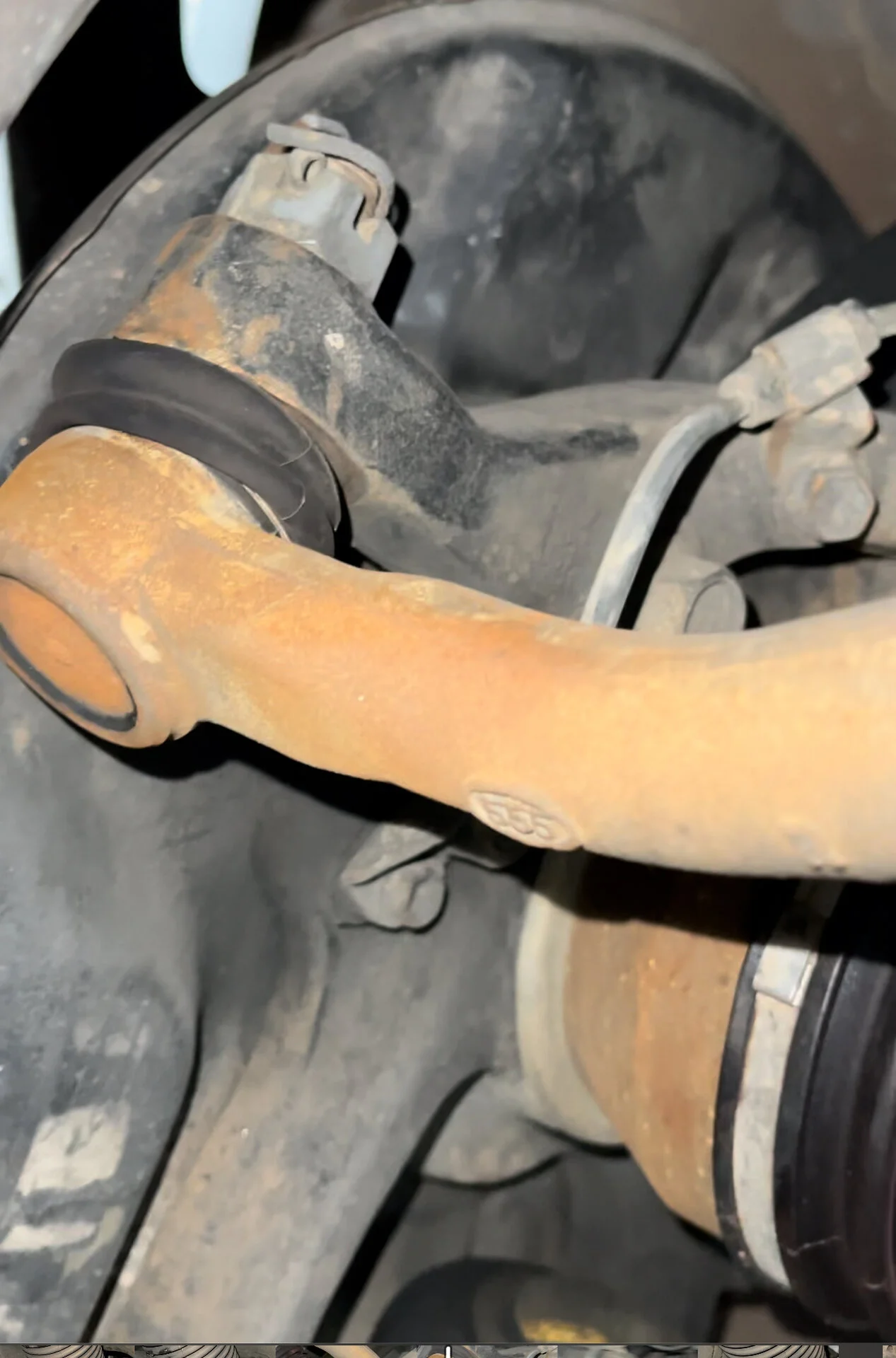

Grinding is often from CV axles. Are your boots leaking?

Searched more on the forum and it is sadly a sign of a steering rack gasket. Luckily i caught it earlier than seeing oil on the floor. My power steering reservoir is still normal level.
I’ll grab some AT-205 today. I saw that might be helpful to seal the leak from other posts I’ve been reading.
The previous owner put duralast CV axles prior to me purchasing the LC. I checked and no rips or grease build up on the boots or lower control arm.

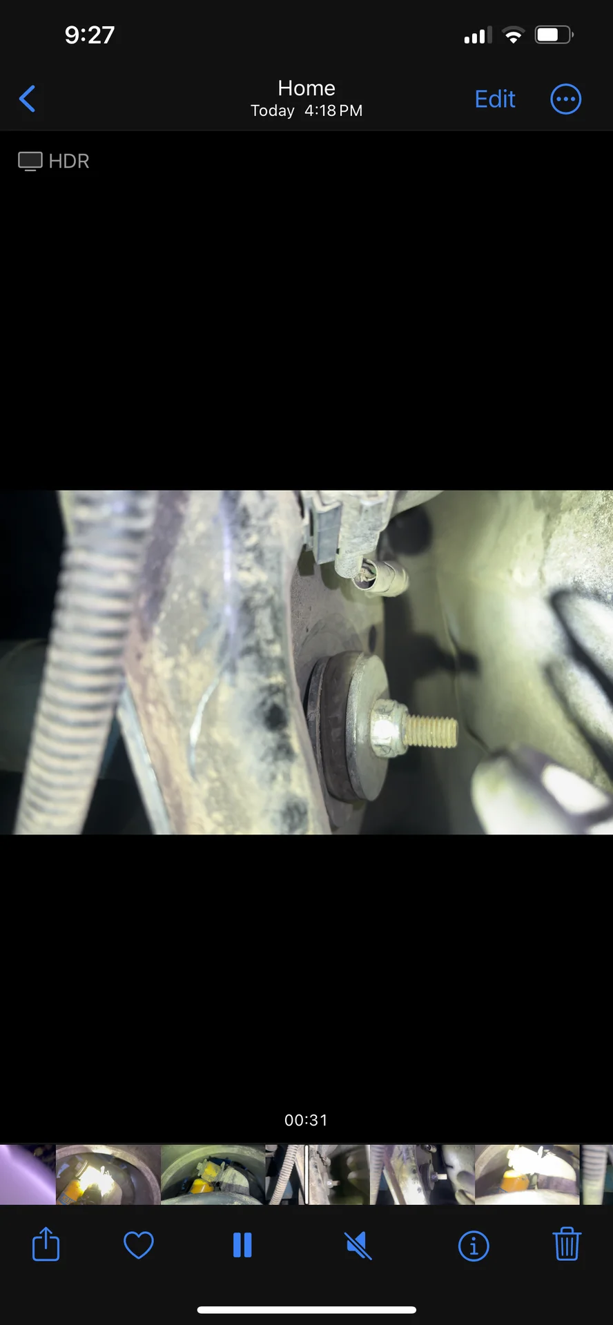

i was able to get under the LC when the rain stopped for a little and noticed something weird for the bottom part of the shock. Previous owner put a washer cup for the cushion at the bottom of the shock. Now sure if this is the culprit for the noise, but we will get to it tomorrow.
