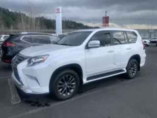

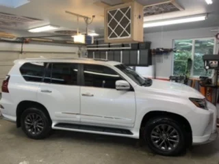

The subject is a 2018 Lexus GX 460, 22,000 miles on the clock, 18 months old with factory warranty still available, black leather interior.

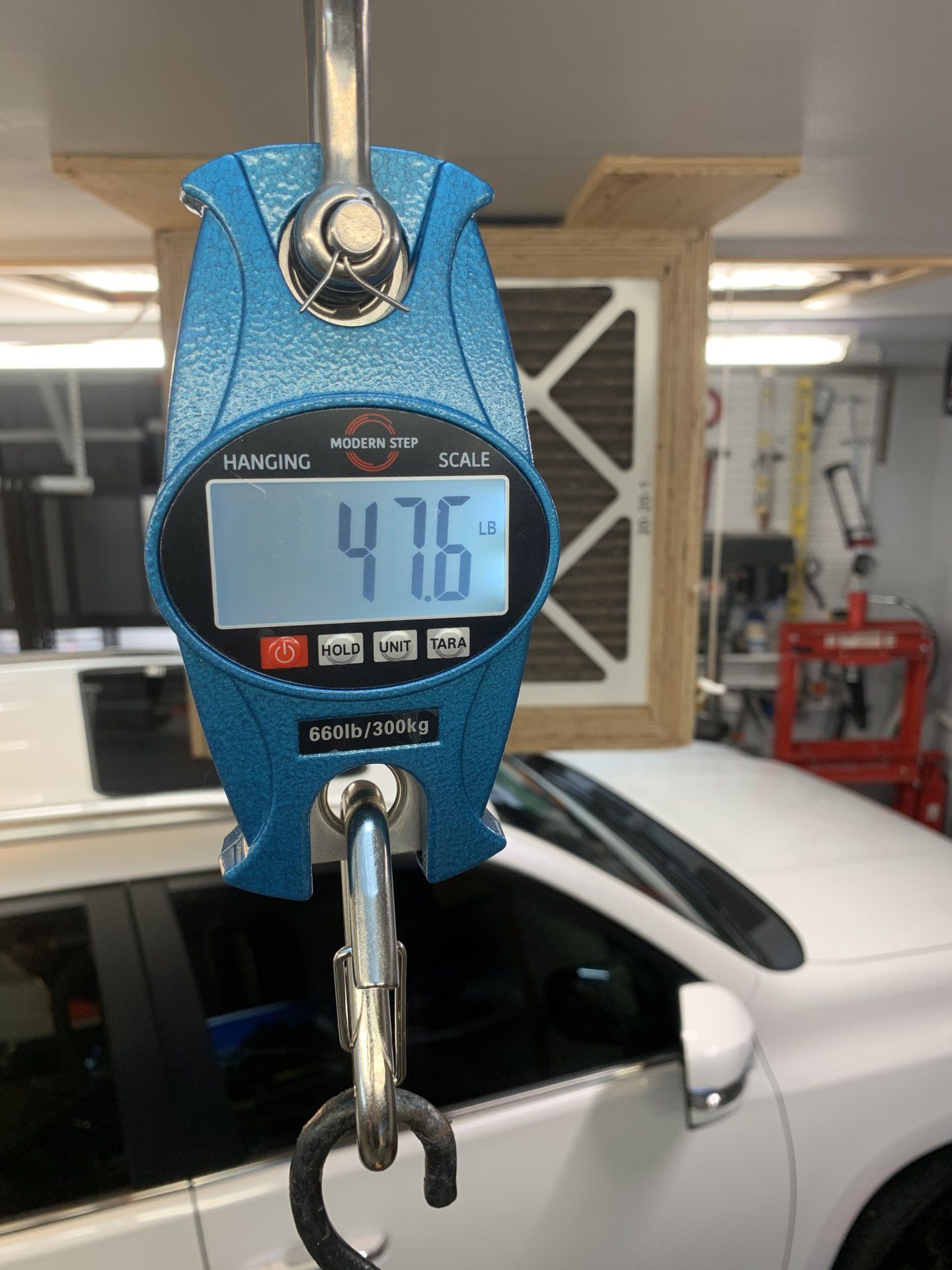

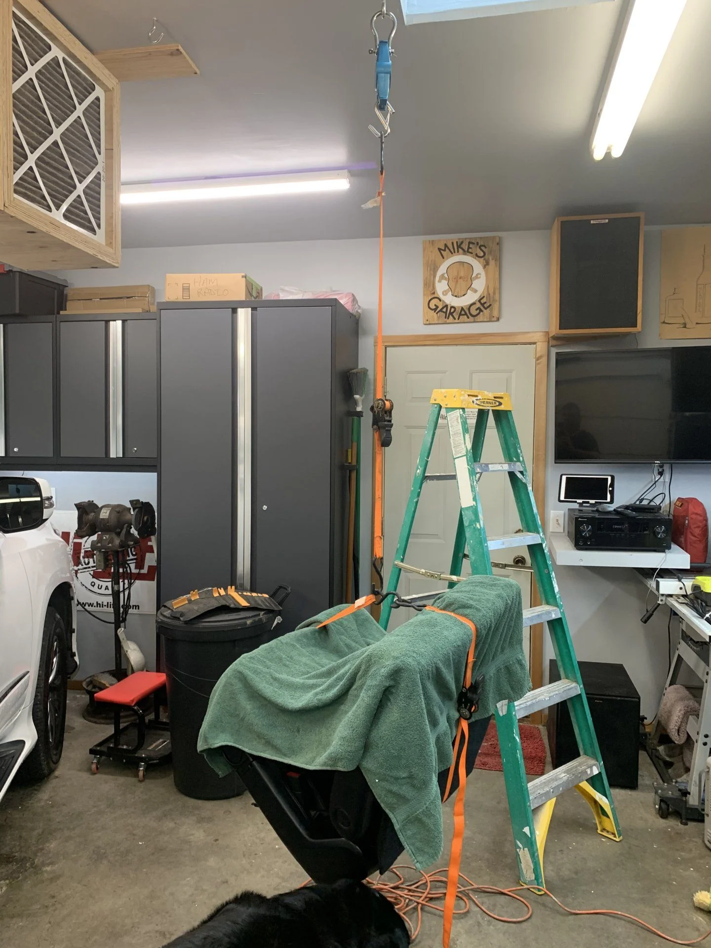

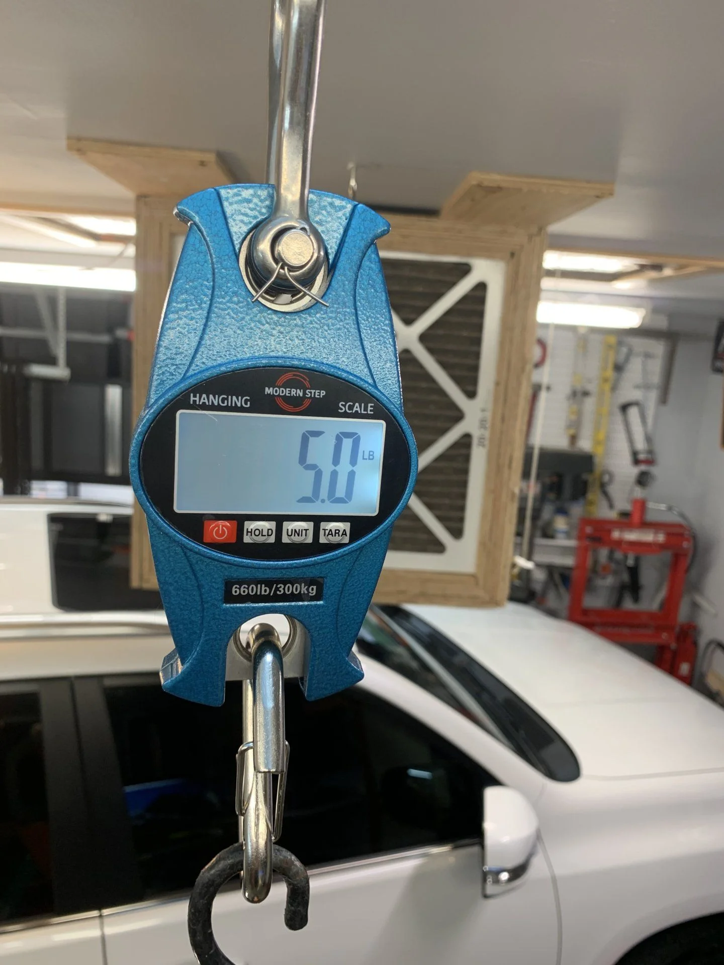

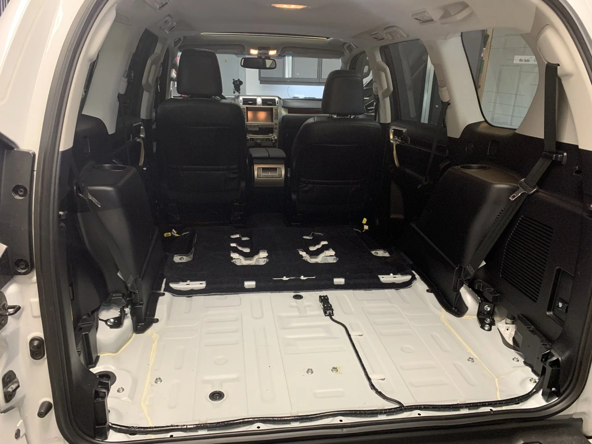

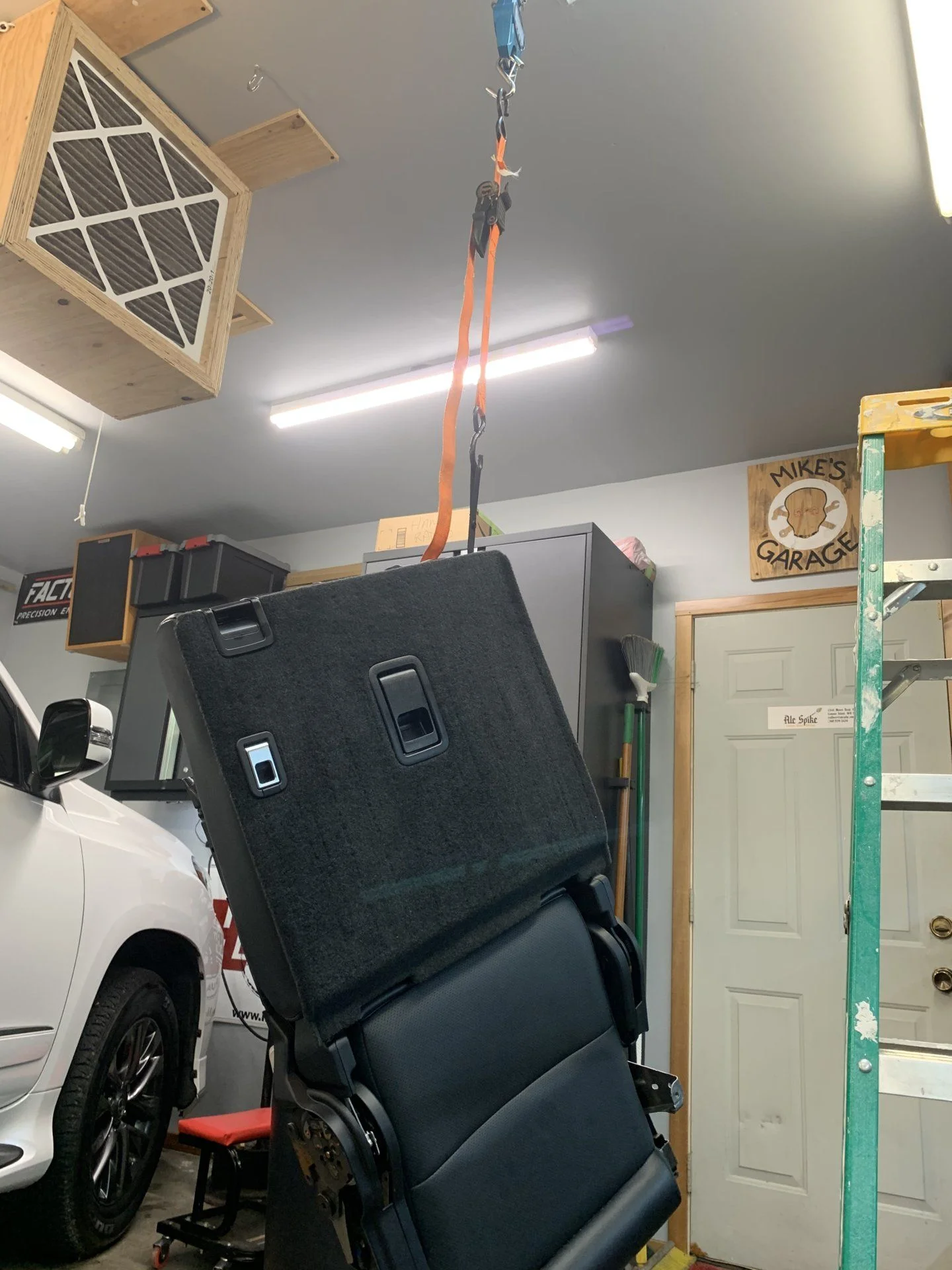

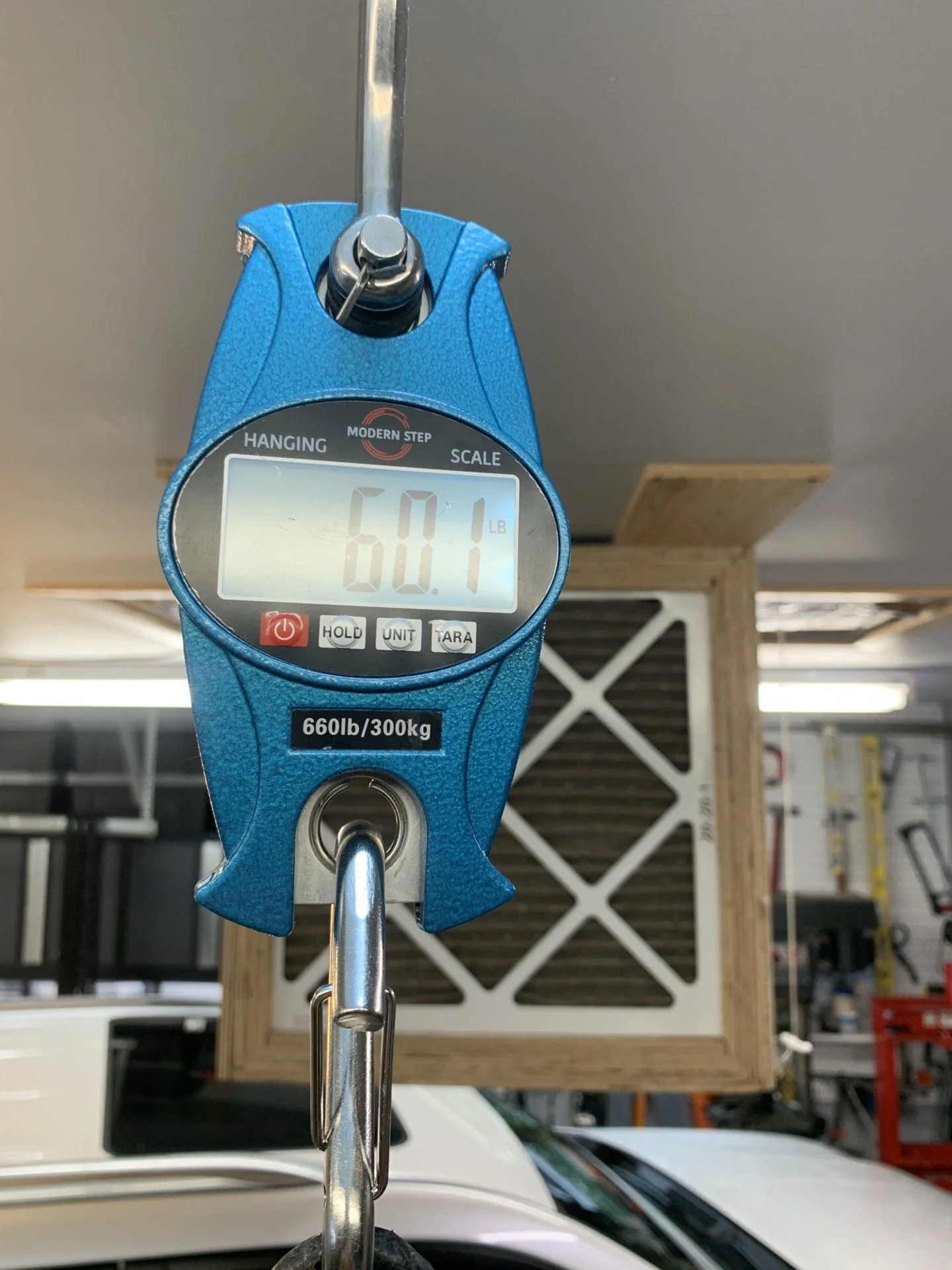

I took today off to get the second and third rows removed. The second row captains chairs are 60 lbs each and the third row is 47 and 48 lbs each. The trim and associated brackets reduced it by another 30 lbs. Total removal weight was 245 lbs.

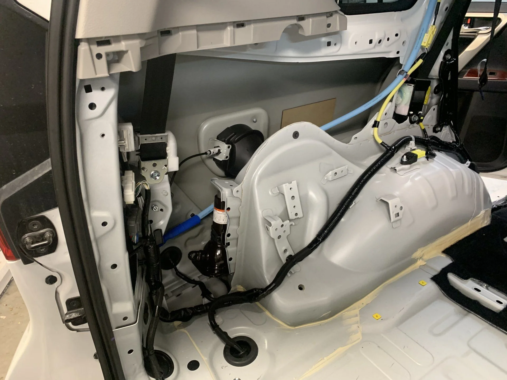

I was a bit surprised with the lack of sound deadner. Guessing the seats reduced much of that. I’ll be ordering Dynomate or the generic equivalent.

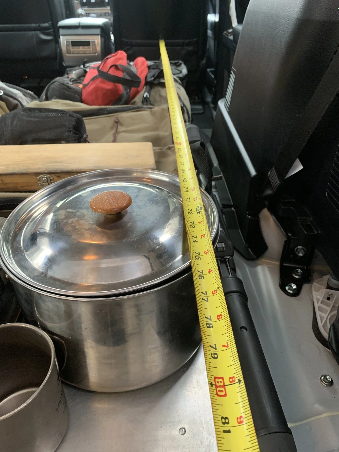

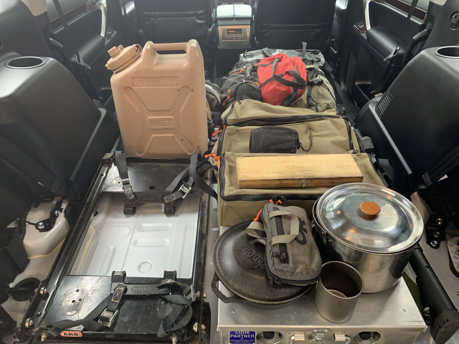

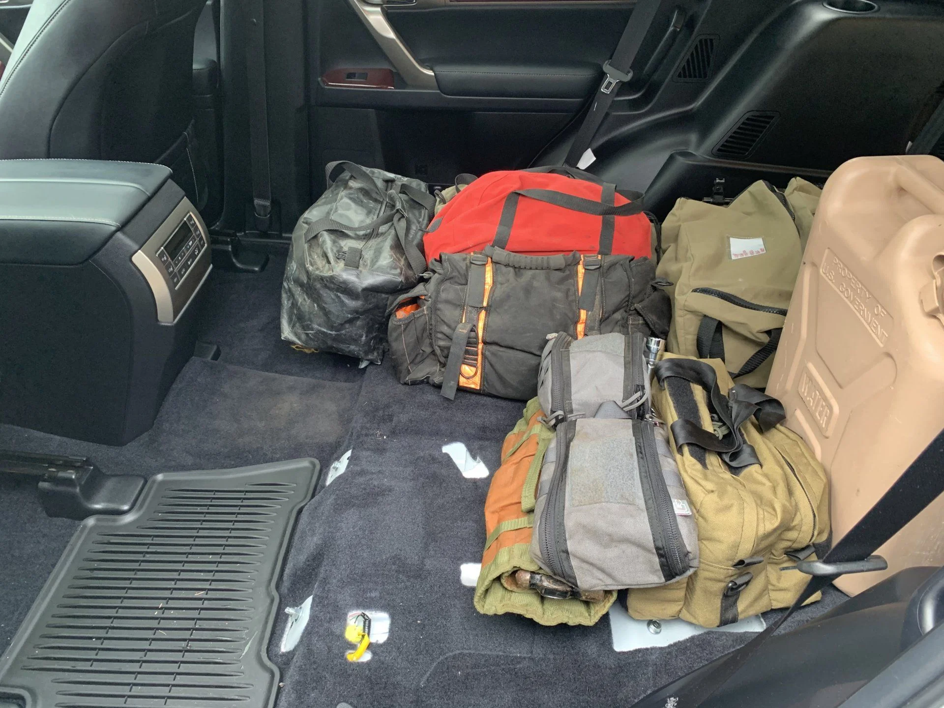

Laying out equipment location for upcoming visit to Truck Vault. Heavy items such as tools and recovery gear forward and between the axles. Camping and cooking equipment aft.

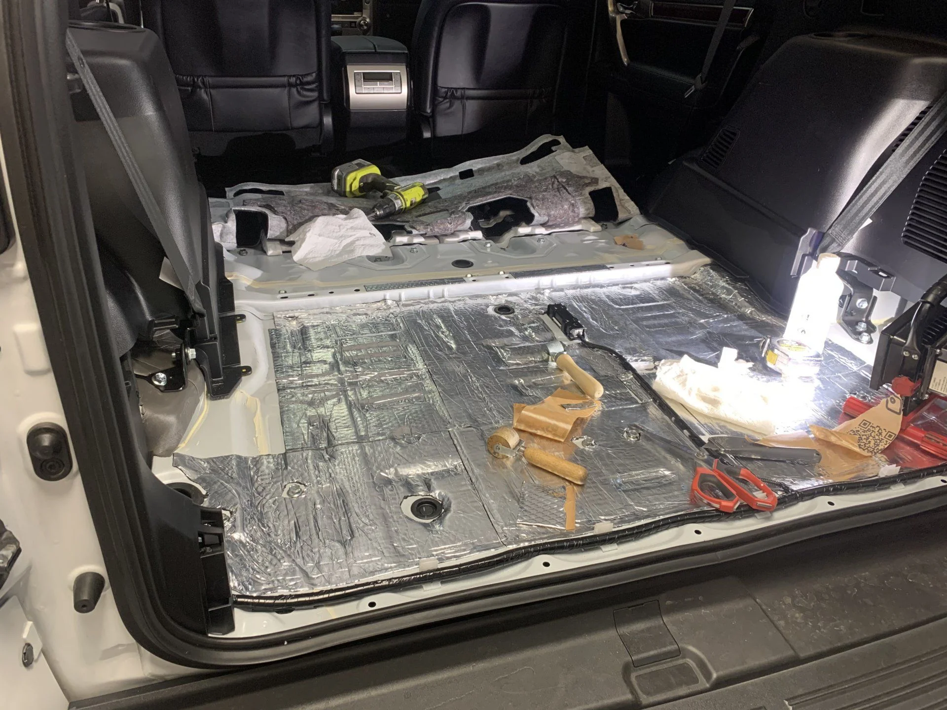

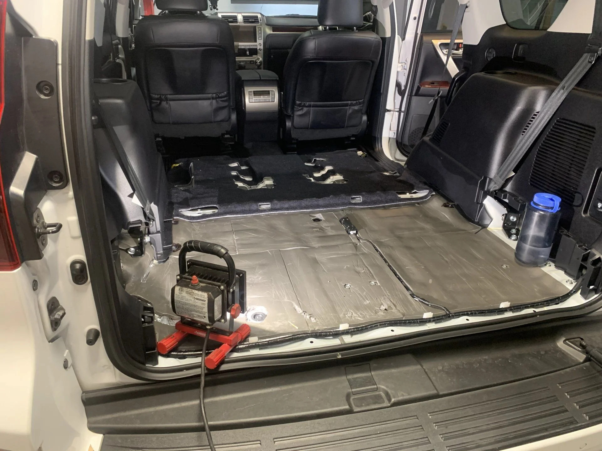

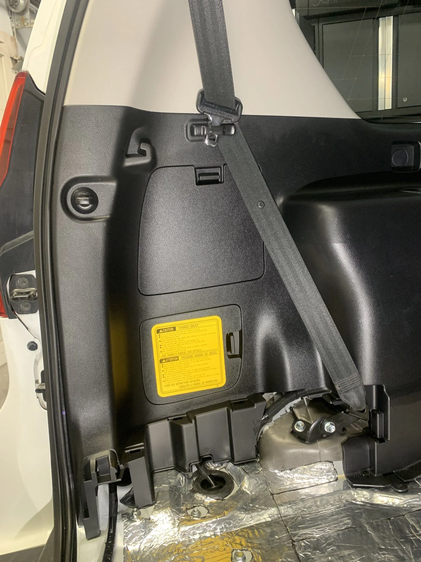

While waiting 4-6 weeks for just about most parts such as rock sliders, bumpers and suspension I took this time to install sound deadener and insulation foam to replace the noise absorption of the removed seats.
Last Friday driving home I used an iPhone app to observe a consistent 68-69 db noise level @ 70 mph with the sunroof shade closed. After seat removal while driving at highway speeds I could definitely hear the ambient noise level was elevated.
The other reason was to help insulate for cold weather camping and sleeping inside on the platform. With window covers and insulation the interior retains heat well. I applied a similar process on my daughters 4Runner build and have tested it several times the past two winters.
Eventually I will apply deadener to all the doors.

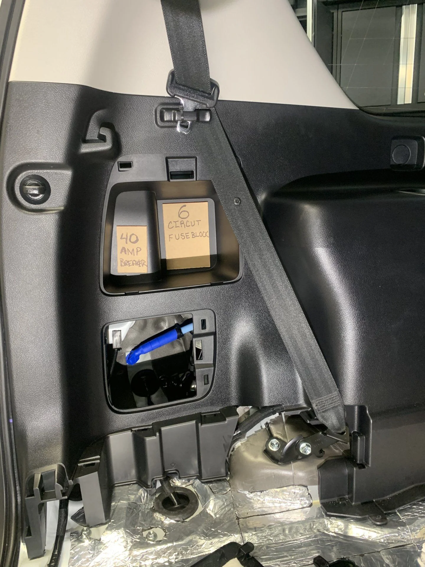

Located a space for the fuse panel and a breaker to kill power to the fuse panel to mitigate parasitic draw. Yes I will install a breaker at the power source. Fortunately Blue Seas has prints for the parts and dimensions so I was able to cut cardboard to size to test fit.

I happen to be on the freeway yesterday and was happy to record 68-69 db @ 70 mph. So with the seats removed and the soundener and foam installed I am back to what was previously observed in factory form.
Once the sleep platform/drawer is installed confidence is high that the noise level will lower. Hoping for the mid 60s db @ 70 mph.
