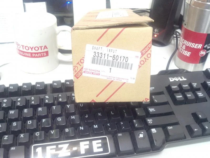

Onur, got a part # for that ceramic cup ? :D
attachment.php
