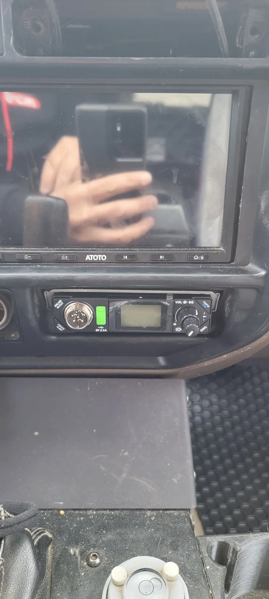

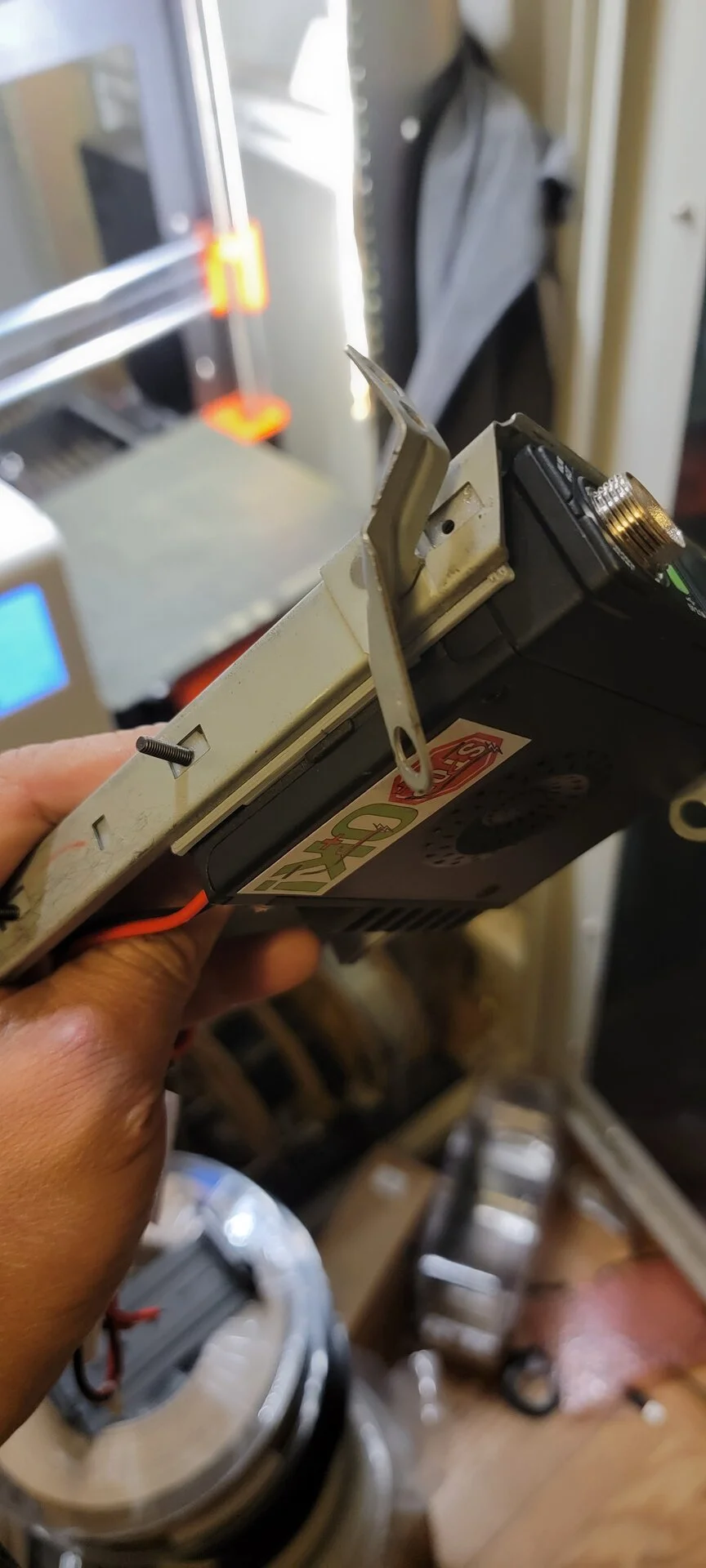

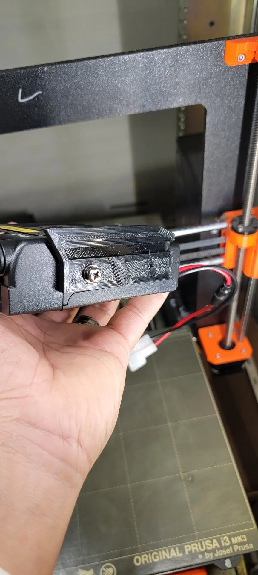

Lee at Solvefunction knocked out this CB ash tray mount for our 80 Series. Built around the President Bill micro CB which gets great reviews. Slides in using the ash tray rails. Easy install that looks OEM and allows you to easily replace the ash tray by just sliding the CB out. It’s on his website now for purchase. THANKS LEE!
I have several things from Solvefuntion and all of them have been top quality!
Thank you
this does require pulling the dash face off and pulling the ashtray mount.
You will likely need to do this when routing the antenna and power.

4. Is remove plastic slides from ashtray mount.
5. Paint front of ashtray mount black, this is only visible from a low angle.
6. bolt in New mounts using the provided m3 bolts and nuts.
7. Slide in device, there is a positive click feeling when in the right spot.
8. Reassemble.
