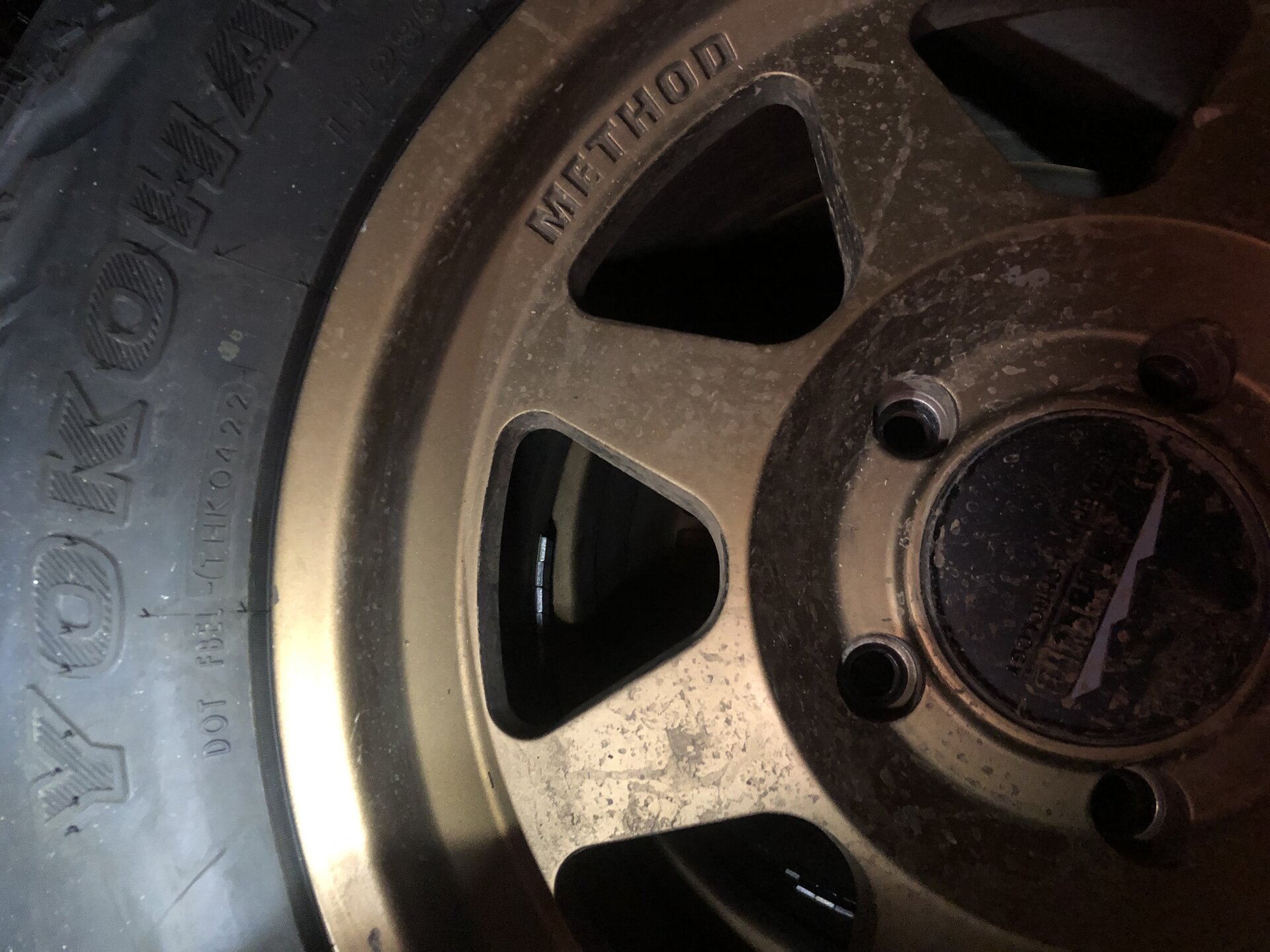

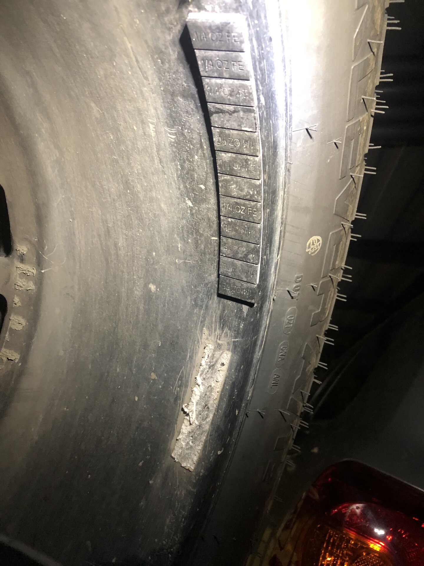

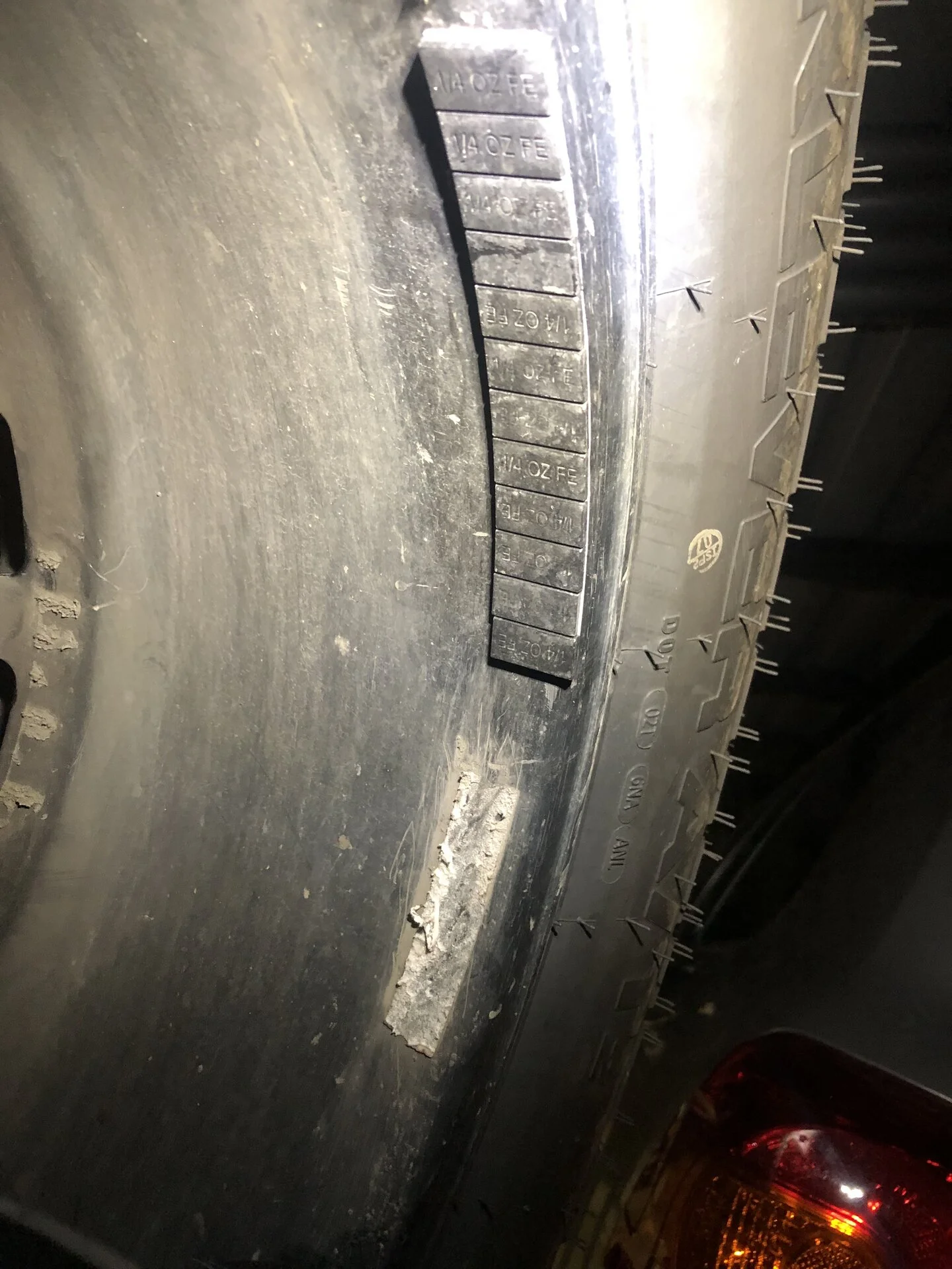

To add more anecdotal data here on balancing weights, One of my 34" Yokohama MTs only took 1.25 ounces to be road force balanced. That is shockingly good and even less then the factory size dunlops. Majority of the Yoko GOO3 's called for between 3-5 ounces, they ride surpsisingly smooth for being a MT.
Adding some additional data on my "budget" Kenda At2 tires, all 5 took between 3-5 ounces to be road force balanced. And ride perfectly smooth. Size Lt275/70r18. I had a Similar experience with the Kenda Klever RT tires. They also balanced easily but took slightly weight then the Kenda AT2.

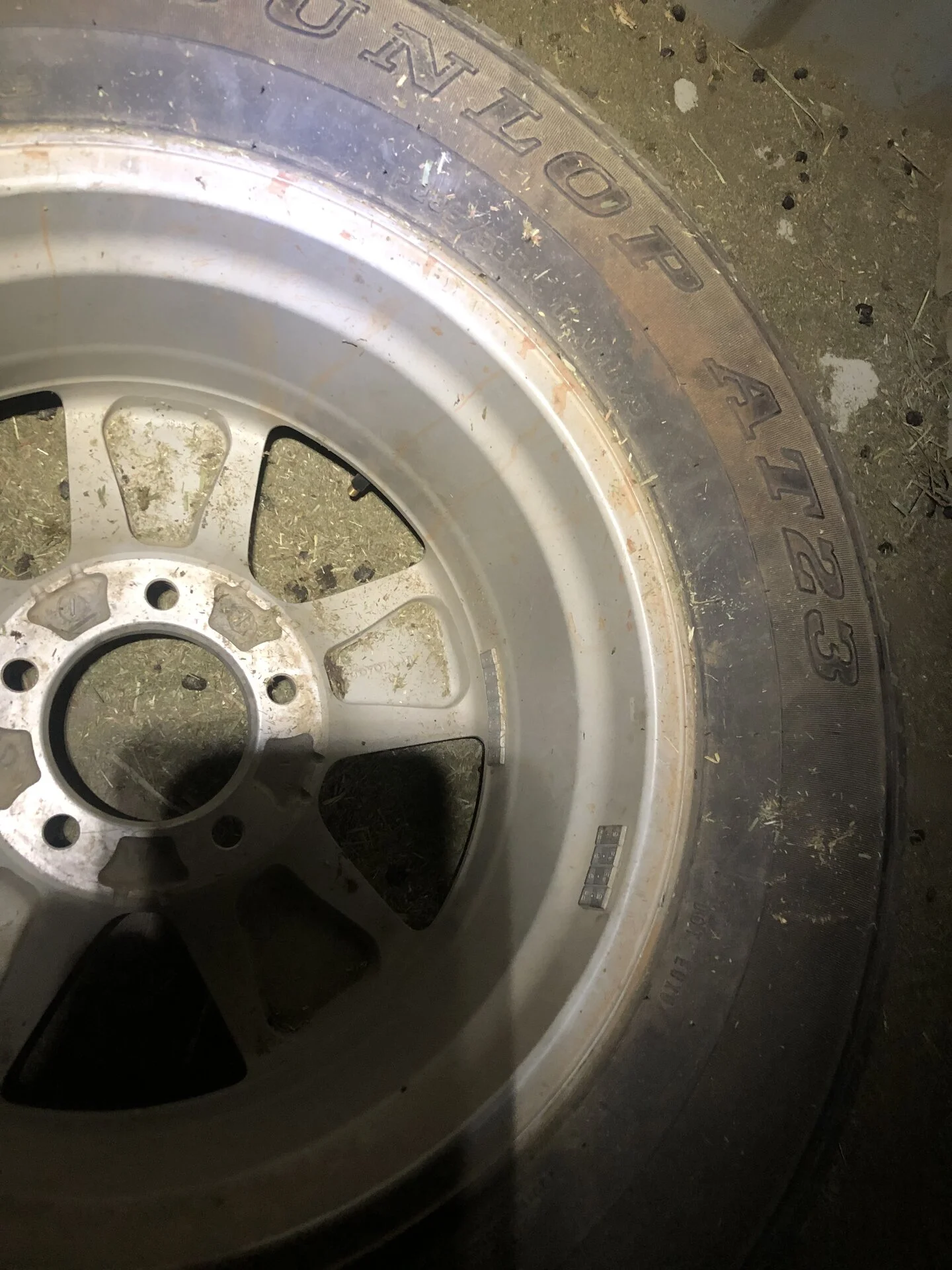

Factory size Dunlop Grandtrek AT23: 11x0.25 ounce weights
Yokohama MT G003 Lt285/70r18: 5x0.25 ounce weights
Kenda AT2 LT275/70r18: 12x0.25 ounce weights
