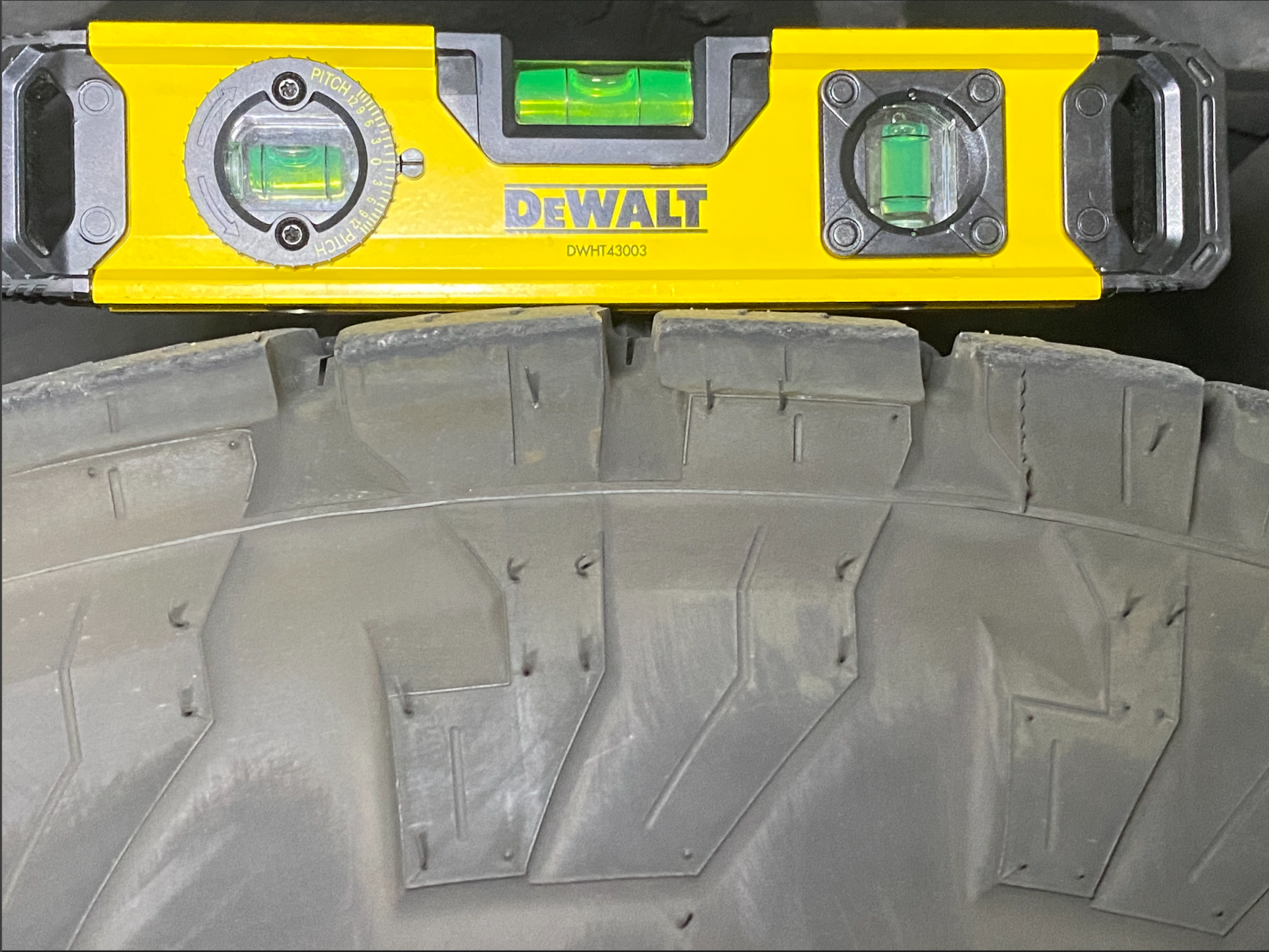

There is clear staggering designed to reduce harmonics. Is this just a trash fitment for the LX?
what tread depth is left there? maybe you're just got a wear issue. shaving would fix that. Probably just a fancy tire problem.
I just calipered it. Its exactly 1mm higher. Tires have like 10k miles on them. Just about one year since the LT-C switch.

This is not a balancing or wear issue, this is a design issue.
