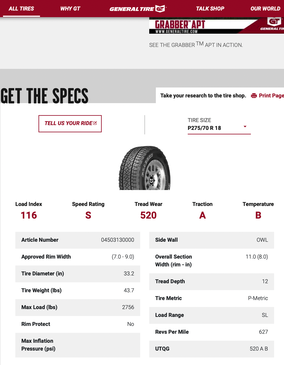

This is what I'm eyeing at the moment.
Add the inch I want in the wheel, not the sidewall. Keep gearing happy not exceeding real 34".
Add the width I want in the wheel (18x)9", and keep the tire more square for lateral stability without having to add PSI.
Only problem is its all E loads. So if thats the case, keeping the sidewalls the same will make it more harsh.

Such a shame C loads are few and far in between in these sizes.

There are more SL tires in that wheel diameter though.

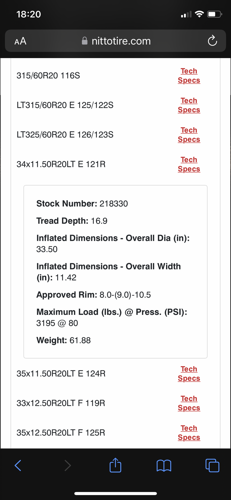

Nitto recon grappler in 34x11.5r20? Load 121.
You have $$$ right?
You have $$$ right?
Wow another rare tire lol. How do you do that!
These tires aren’t showing up in either DT database or tiresize.com.
Do tell your secret there.
The $$$ yeah i guess, its just i dont want to waste my current set. It would have to contribute a major portion of that cost. Paid like at least $2k for those alone.
Then tires, twice… I paid the Ps to C load cost difference too.
