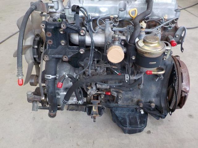

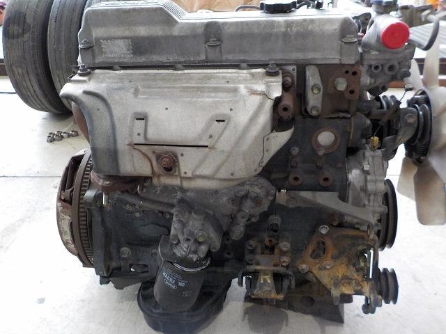

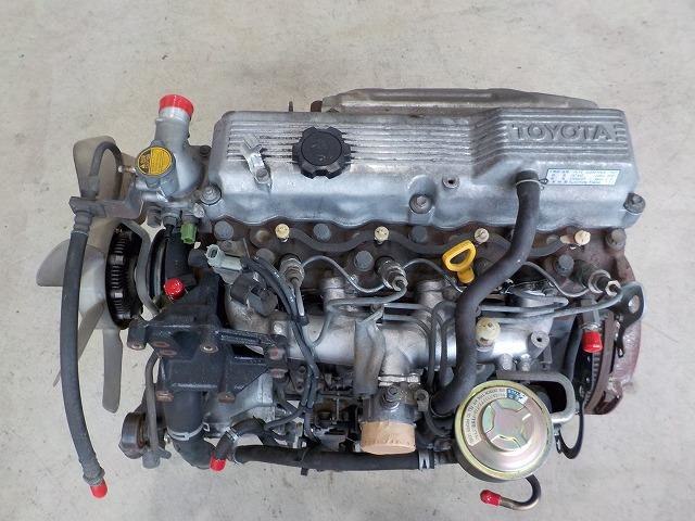

That's a 1999 3B-II JDM engine:
All 3Biis have a rotary pump.
Some 3Bs have a rotary pump, some are inline.
The best way to difrerentiate them is by looking at the valve cover, or checking for pushrod inspection window covers.
Thanks for sharing these pictures. 1999 was AFAIK the last year of the 3B. Interesting to see the onboard power steering pump and that the engine has totally different brackets from the Land Cruiser 3BIIs. Is it your engine?
