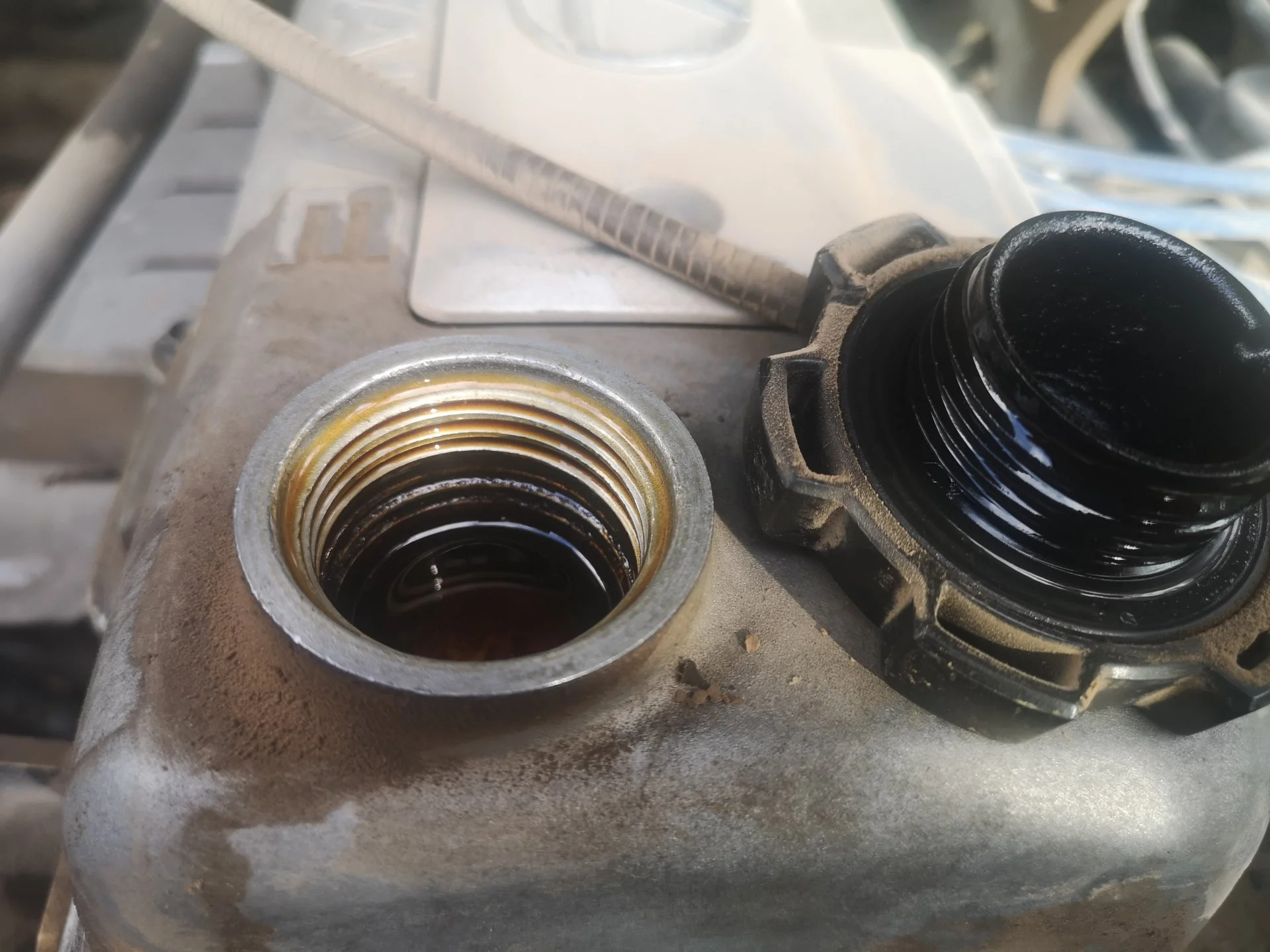

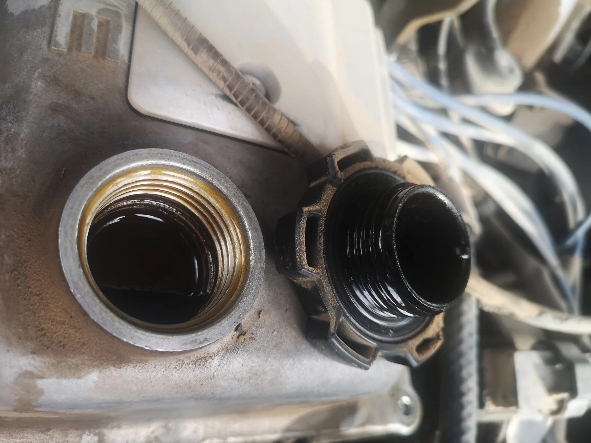

Today my oil light came on again, and I figured I'd just put another quart in (is been losing that much every 1000 miles or so since it got leaky). Popped the hood and saw WAY more leakage from the valve cover than there has been any time before. Liked like a few ounces of oil on the front of the engine, mixed with the usual trail dust, making glossy mud.

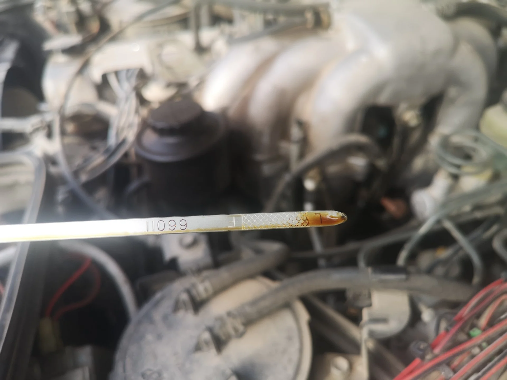

Checked the dip stick and yep, it was down to the low mark.

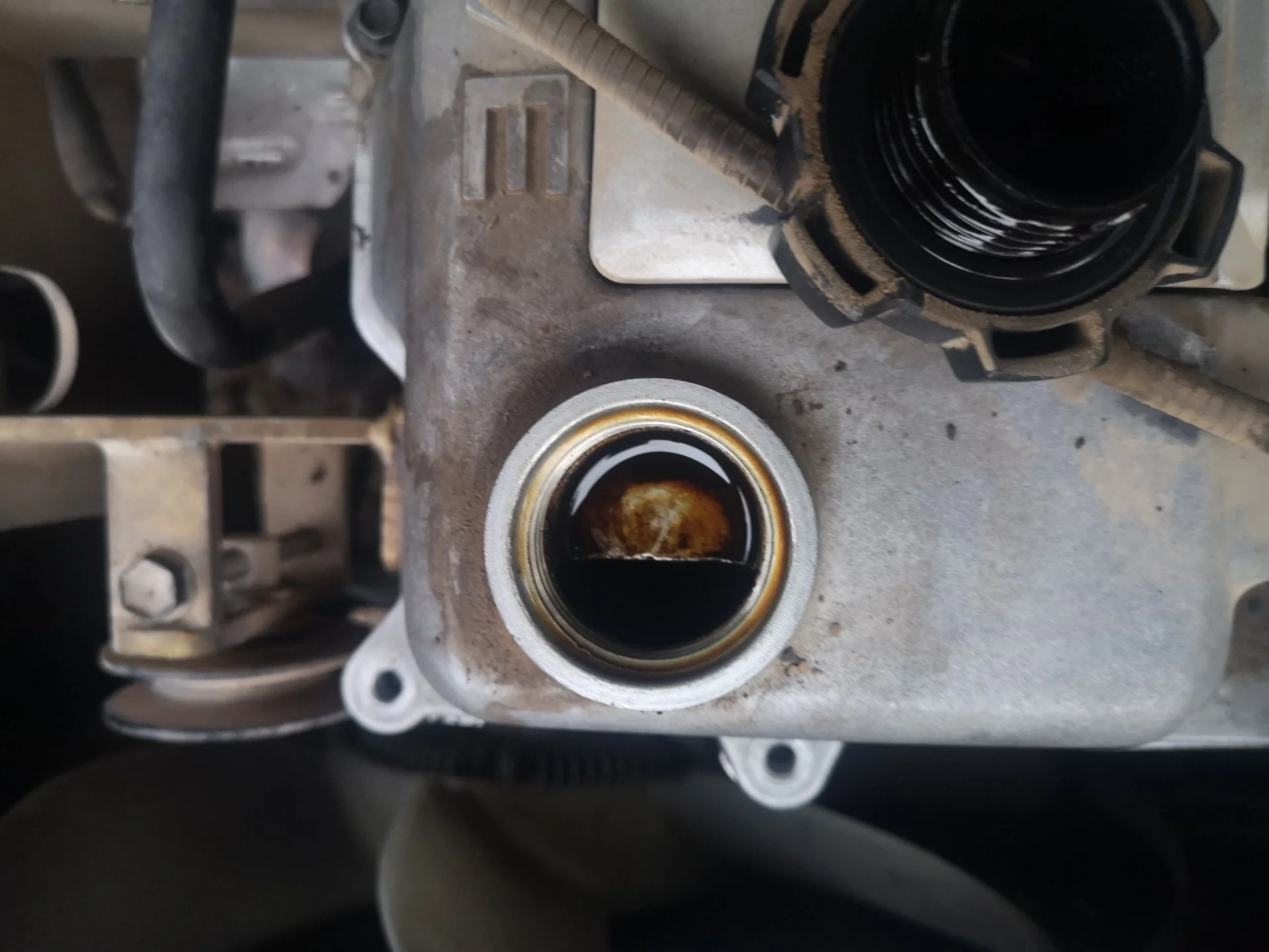

Opened the oil fill cap and the oil, unexpectedly, was staring right back at me from just below the threaded hole.
What does this mean?
Seems like the oil isn't making it down to the pan, and maybe it's being forced up under pressure, driving it out past the valve cover gasket? Maybe a clogged oil filter?

I don’t mean to assume you don’t already know this, but there is a flat surface under the fill cap in the valve cover, with an opening toward the front for the oil to move through, when filling for example. Hard to tell from your pictures on my phone, but my initial thought was you are just seeing residual oil sitting on top of that. If there is actually oil filling up that high, it would mean your entire engine cavity is full, no? Or, it would be quite the clog for all your oil to be sitting up there and not draining into the pan. But if that’s the case, how was the oil pumped up there in the first place?
If you stick your finger in that little opening, is there actually oil filing the valve cover cavity above the cams? I hope not, but best to get the dumb questions out of the way first, hah.

Get a flashlight and look directly down from above at the oil filler hole, not at an angle as in the photos. There is a ledge occupying the rear 2/3 of the hole, the front side is open so the oil can flow down to the oil pan.

It was just the shelf, I'm an idiot. Big bumper and leaning over, couldn't see the opening and forgot it wasn't straight through.
