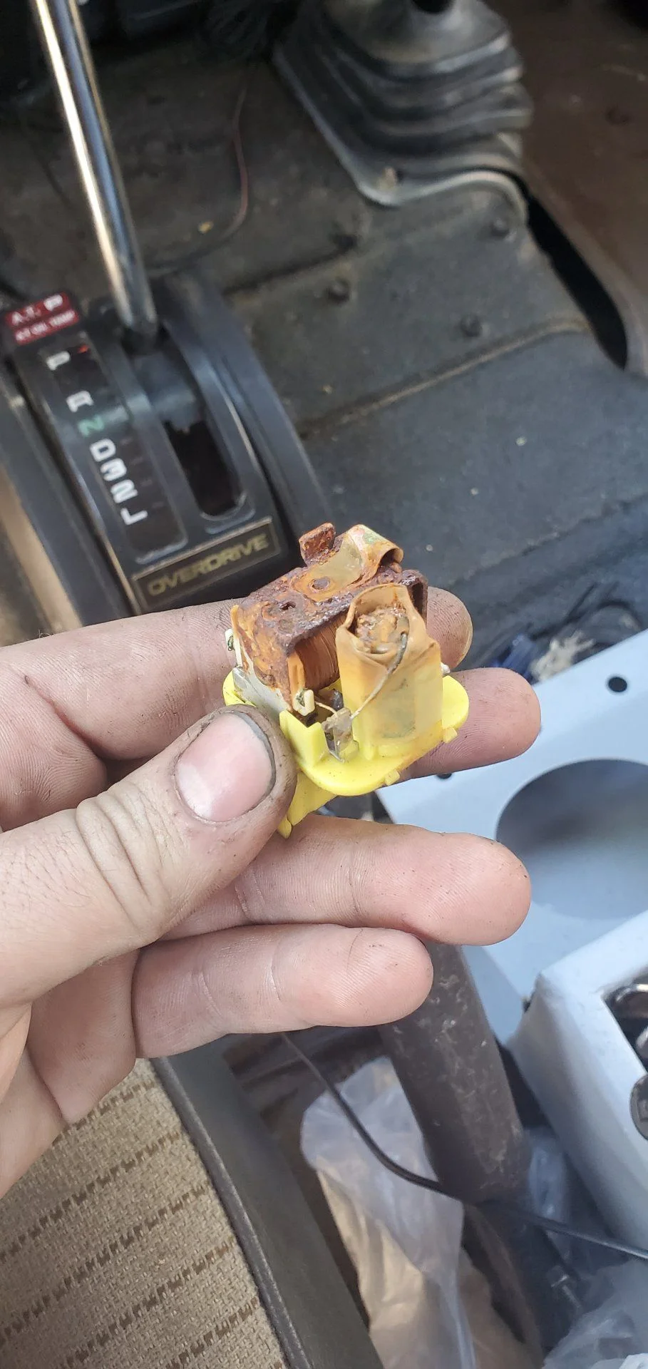

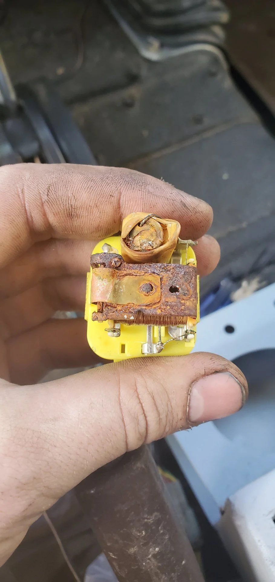

Alright so i figured out this problem, but things got crazy and i forgot to update on it.
Basically what was happening is my car would die when there was too much electrical load, as well as when it got too hot it would not want to restart. After dinging through the FSM and the wiring schematics i found that if i bridged the connectors in the engine bay to keep the fuel pump going it wouldn't die or have a problem restarting. This lead me to finding out that my fuel pump relay was bad, and when i say bad i mean BAD.
As you can see from the pictures, the relay was just trashed. For some unknown reason Toyota had this relay mounted upside down in the passenger side kick panel. Which i guess wouldn't matter to much if you dont have a slight leak in your drip rails. Well since the drip rails leaked the relay housing acted as a cup, so basically there was water constantly in here for God knows how long.
Luckily this part is like 40 bucks on rock auto, and once i put it in ive had no problems. Ive actually ended up getting better gas mileage, which i think has to do with how the fuel relay controls the fuel pump (or im just crazy). Ive also redone my drip rails and gutter so now i have no water coming in, just to be safe i mounted the relay right side up so it wont catch water.
Just some friendly advice, if you have had water pooling near the passenger side kick panel id check the relays before the rust to s*** and leave you stranded in the road outside of a Taco bell
