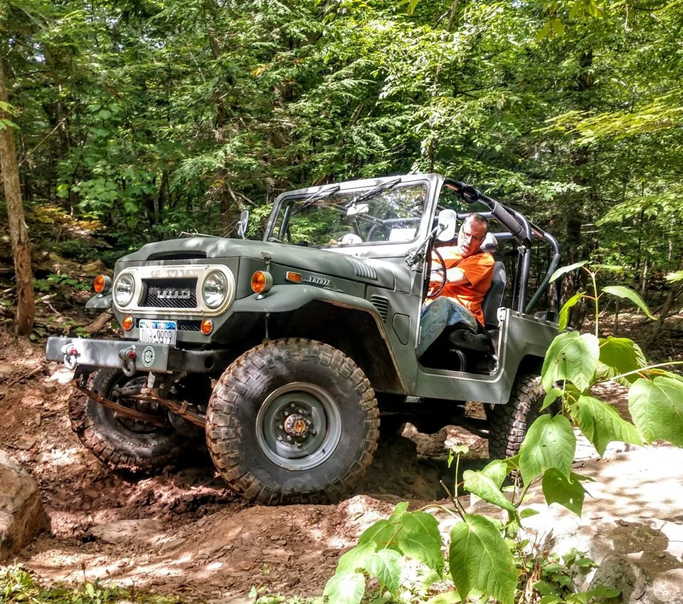

So, the FJ60 on 38" Swampers is gone. :confused:
Going forward I'll be wheeling my SUA FJ40 (ARB lockers, 4.56 diffs) and I'm getting ready to bump up from the 33" BFG KM2s on there to 35s.
You all wheel what I wheel, in general (input from the guys out west is useless). I'm looking for a relatively aggressive tire that'll work in the rocks of the northeast... AOAA and Rausch - for example.
I'm looking for radials - one set of tires... I don't want to be swapping back & forth. I'll trailer it on most wheeling trips but want to drive it regionally often. Going with 17" wheels.
So far the tires that have been mentioned:
Goodyear MTR
BFG KM3
Toyo MT
Maxxis Trepador
I'm hoping for real-world input from those that know.
Thanks
Mark
