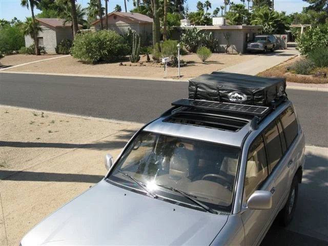

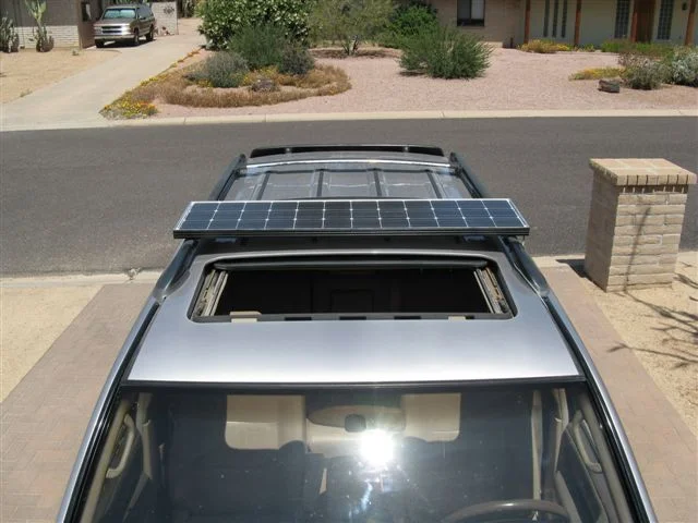

This keeps our battery up along with the fridge

Eric it is a 55watt ITE Siemens panel. Due to the cost mine is not easy to remove at least I hope so:grinpimp:

55W is just right for a typical 12V fridge. Nice!

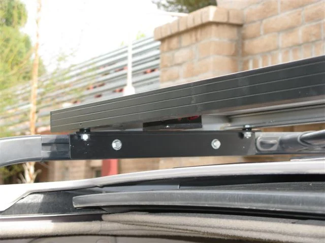

how do you lock it down?

Custom mount on rubber groments. 100s of miles of wash board logged without issue.
I can go days without starting the LC on one reg lead acid battery. Waeco CF-50 full of beverages at 33°:D
