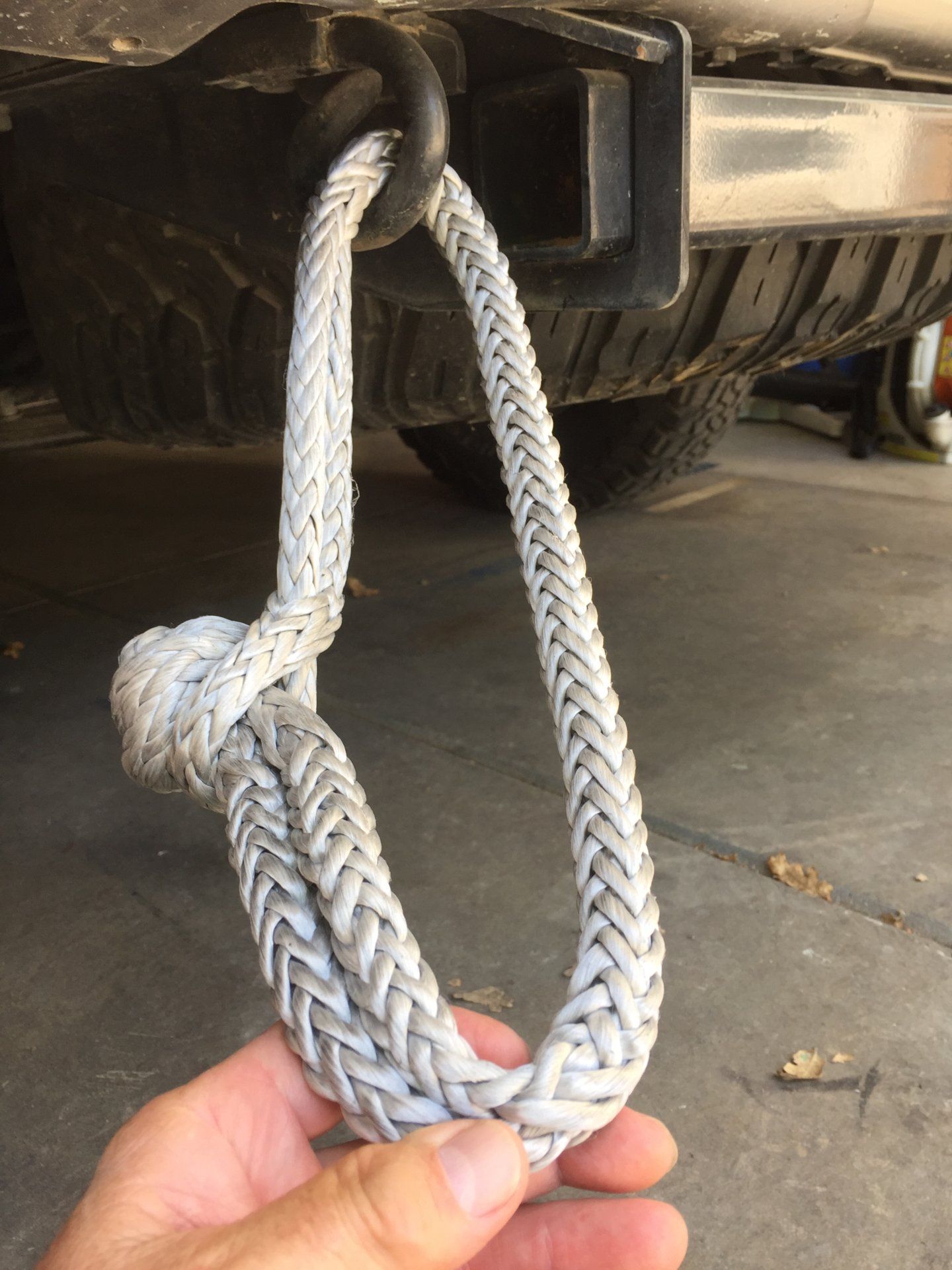

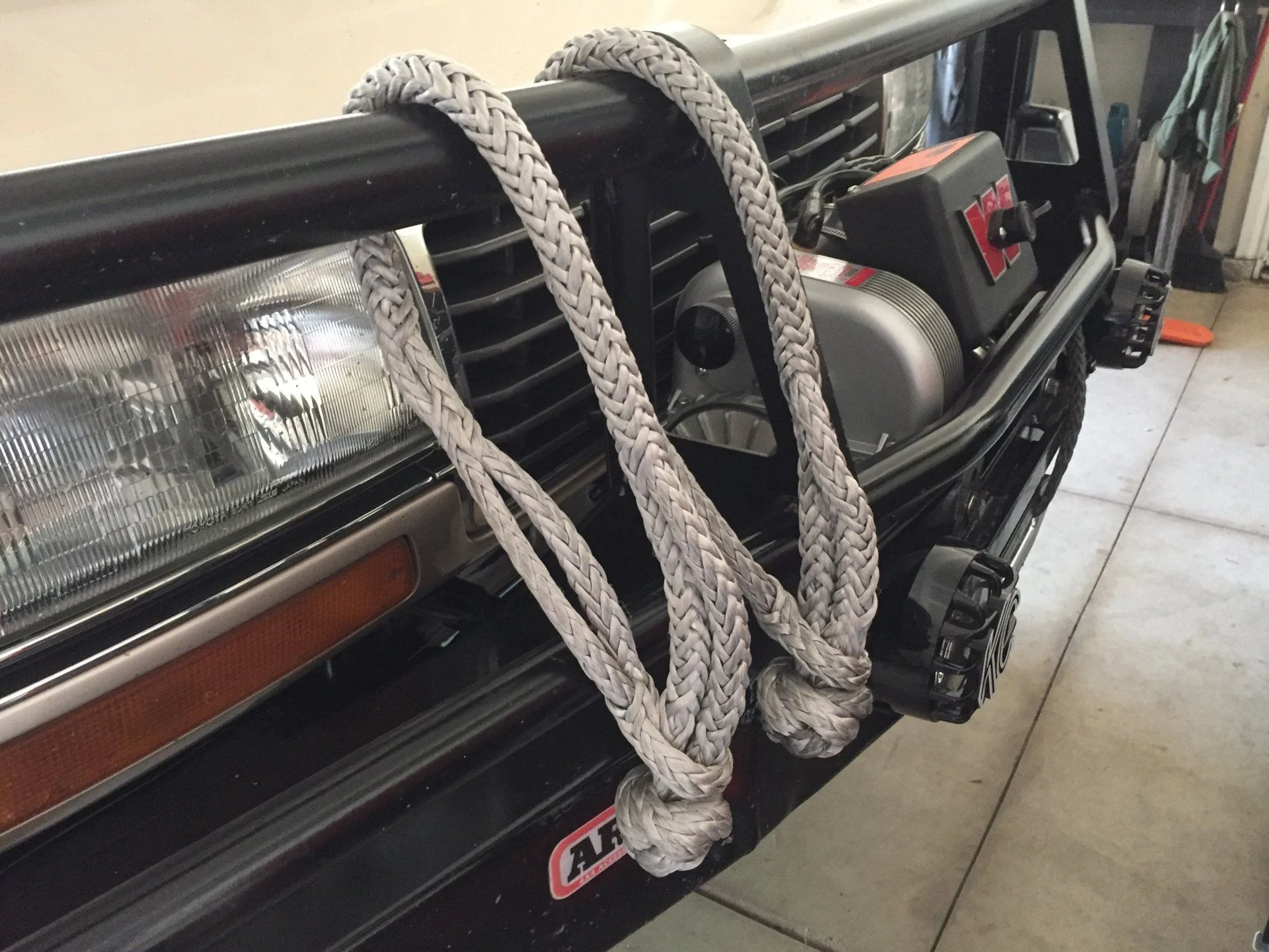

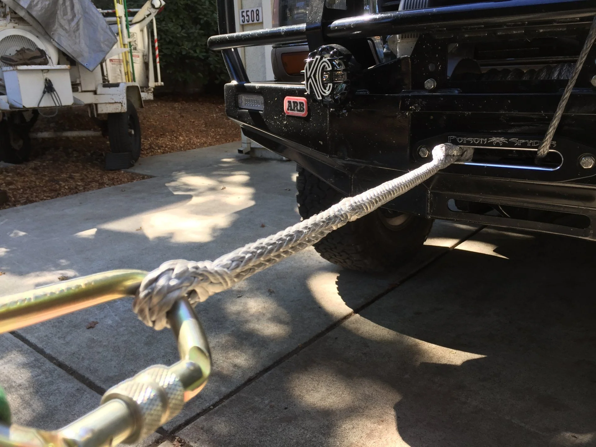

Had a buddy of mine make me up some soft shackles out of 7/16 amsteel SK-78 at 23,900lbs strength....will see how much I like them...so much lighter than the steel shackle...
Nice job!
I have a few of the Bubba Rope soft shackles and they have been used many,many times. I love them, they're light, strong, high viz green, AND they float!
I think you'll find yourself a convert.
They look great!
How did you get the knots tight? Is that a tested rating?
They look great!
I got em tight by backing up a few times, by lightly shock loading the softies ;)....they were hooked up to my F450 as anchor point...

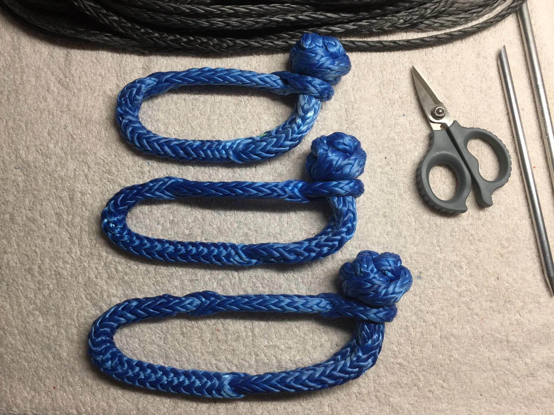

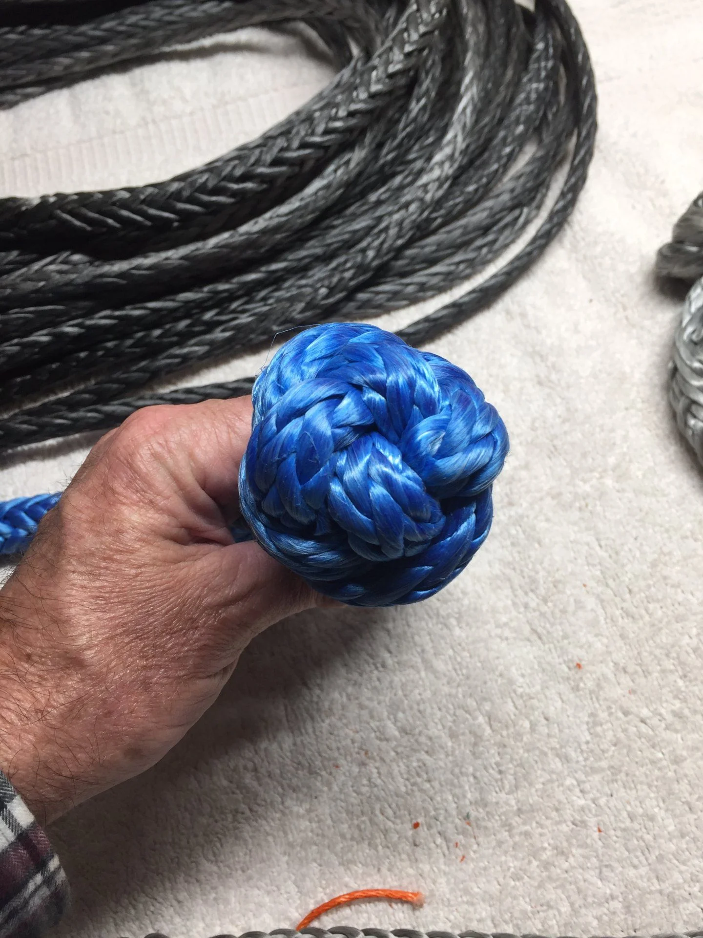

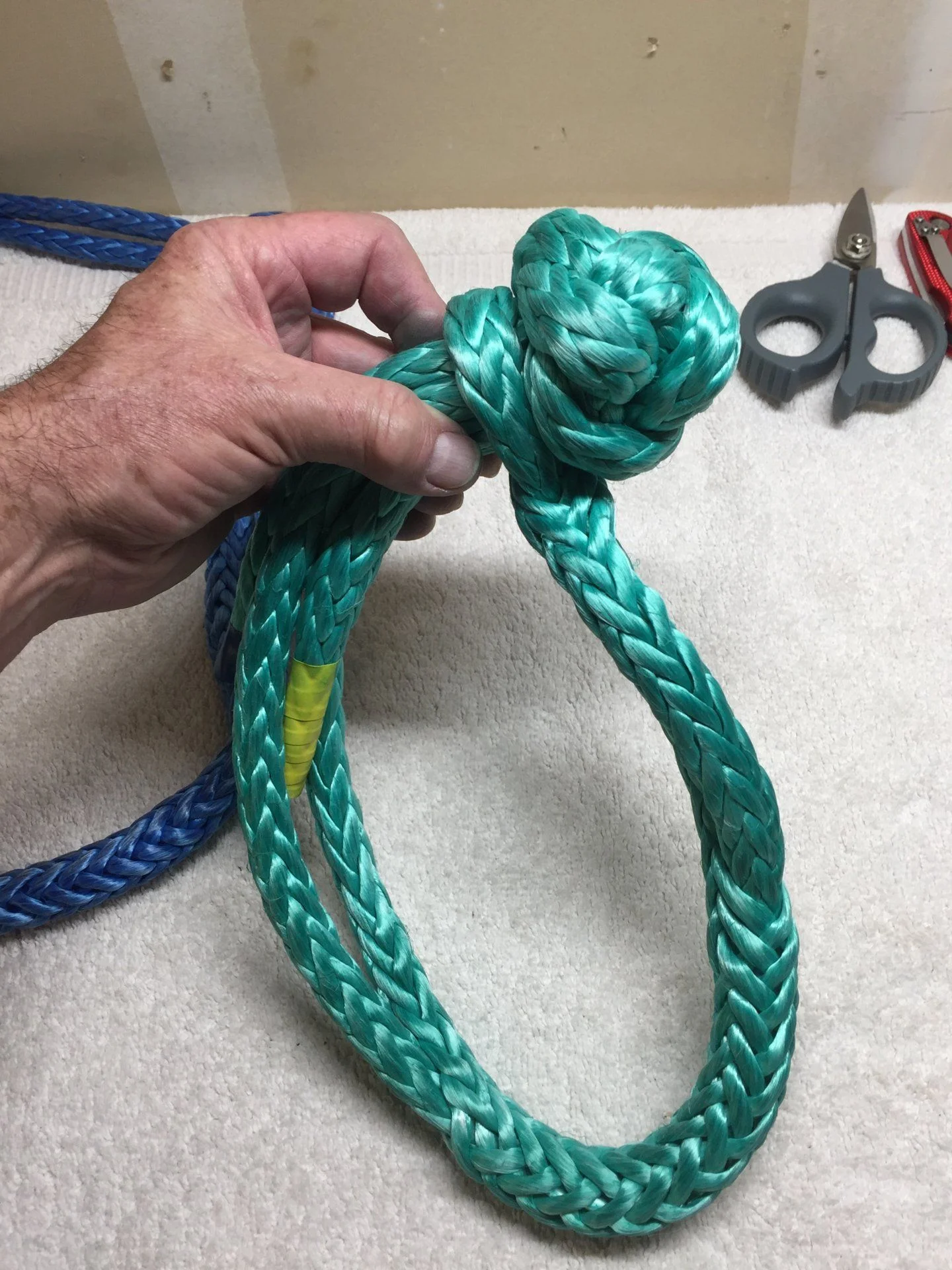

I made 3 soft shackles 6", 8" and 9" out of 7/16 amsteel blue...the button knot is the hardest part to tie.

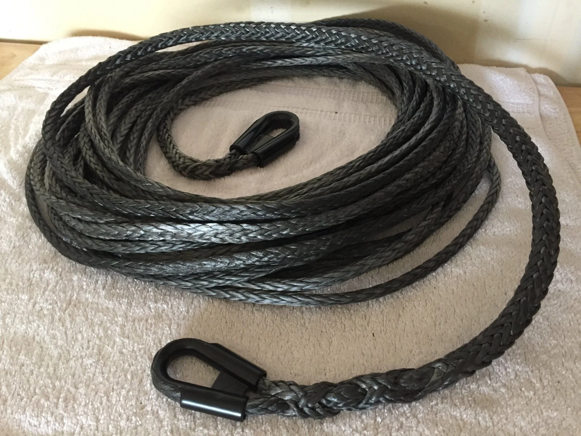

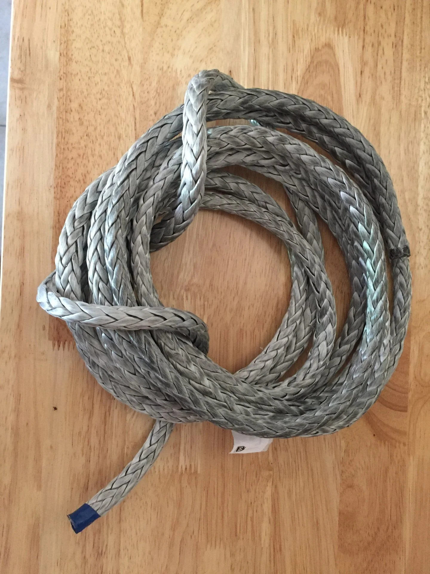

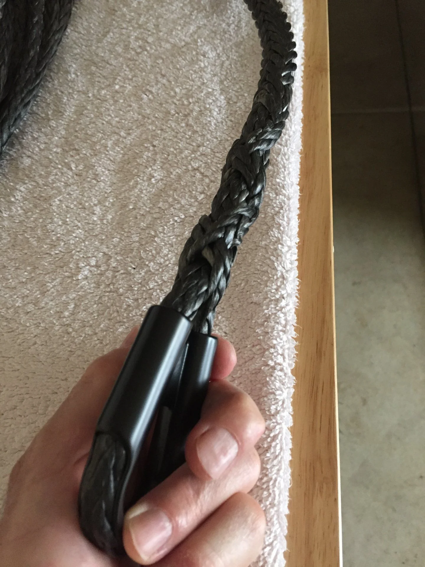

Spliced up a 100ft 3/8 dyneema extension for the far away tree ....

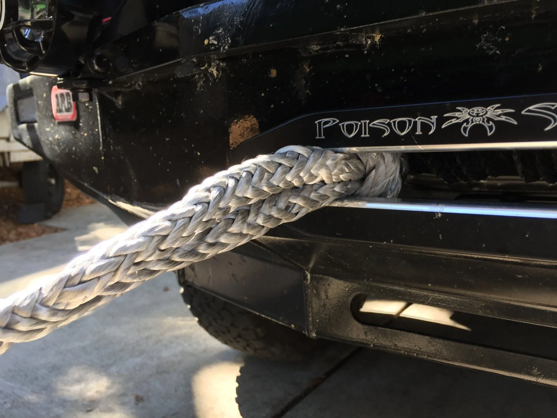

I went up to 1/2" samson dyneema for soft shackle, rated at 30k...1/2" seems more durable and will still fit thru recovery points...I have enough rope to make one more, takes about 8ft for a 10" opening and tying the button knot...
