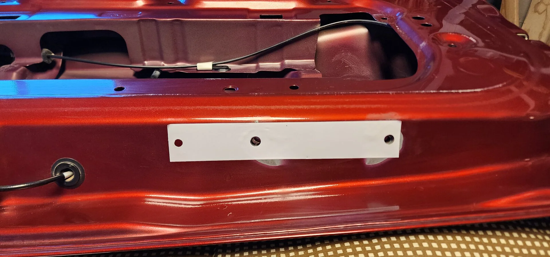

i did the dremel pilot hole trick
then used a burr from the other side. burred it large enough to fit
screwed the bolt from the inside out to help guide my burring
used a little touch up paint to cover the not so pretty burr hole

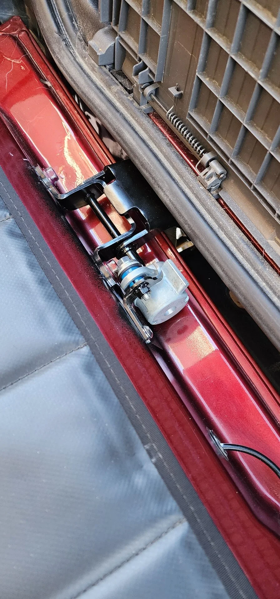

Works great. Every LC200 should do it.

Getting the Damper on is easy, getting the rod to the hinge.....its another story

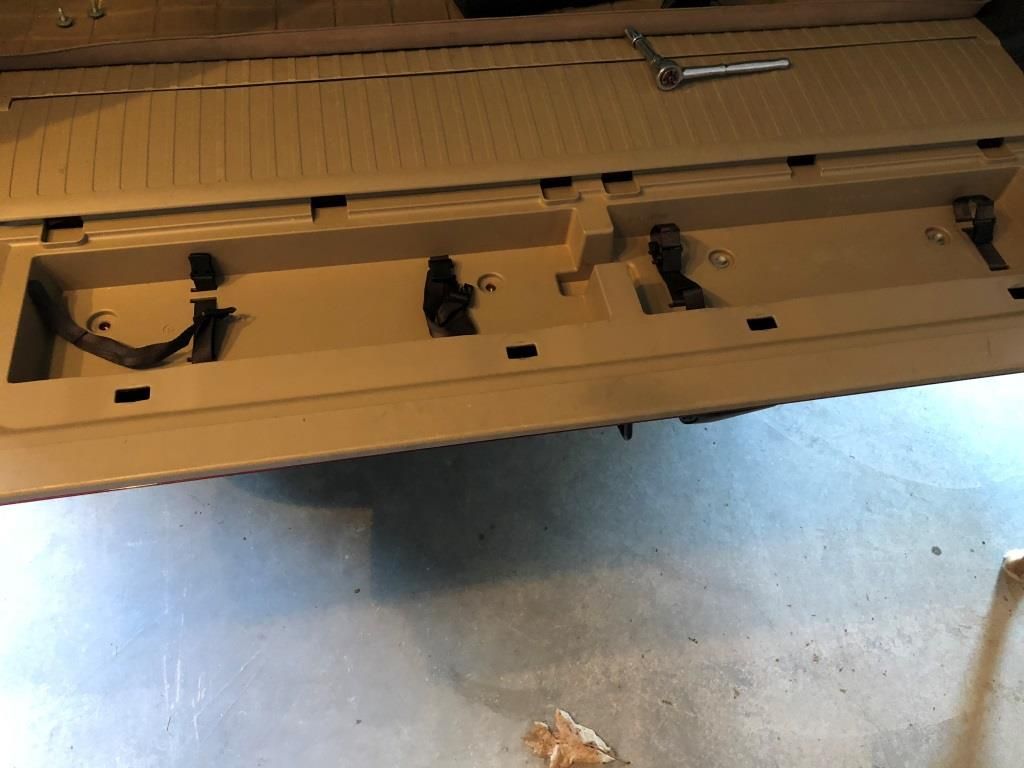

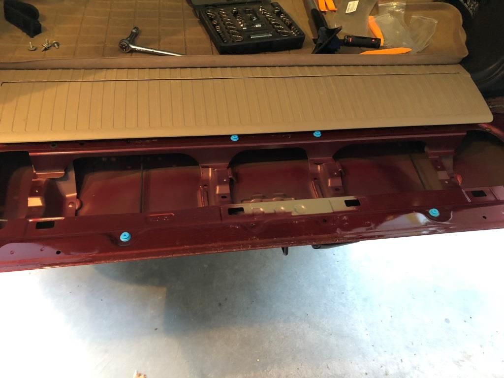

First step is getting interior panel off
Remove 4- 10mm bolts. I used the panel popper kit to get started on removing the interior panel. Once you get one or two out you can get your hands in there and pull up the rest. It requires a little force, but fortunately I didn't break any of the rivets.

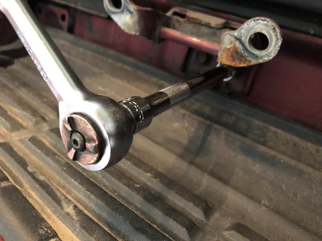

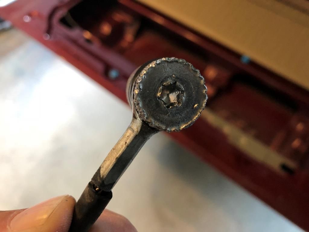

Next was getting the check cables off. This proved to be the toughest part for me, as they were rusted to the point that the T-40 hex driver was stripping out the cable end. I ended up snipping the cables and using locking plyers to turn the cable ends. Seems like the ends are made of a soft metal, stripping out that easy. View attachment 1575917

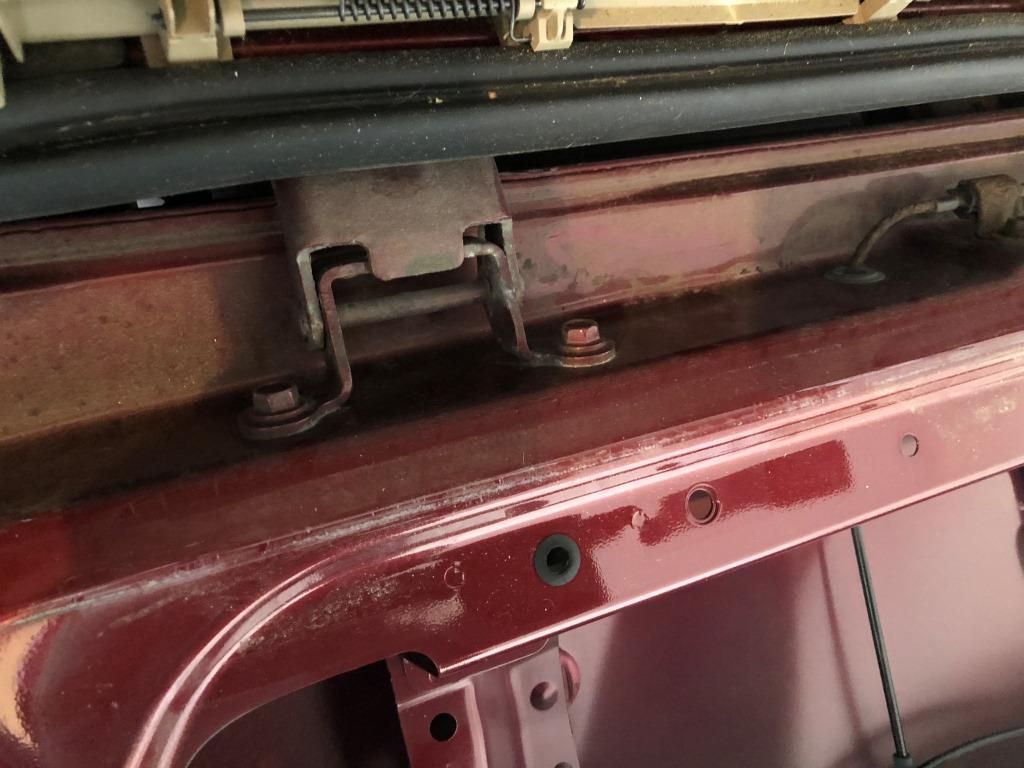

Remove 4 - 12mm bolts holding the hinges to the gate.
Next step is remove the left hinge from the body, attached by 3 - 12mm bolts. - I used an extension to get in there
Next I mounted the new hinge to the tailgate using the 2 - 12mm bolts
Installed! Thanks for the write up.
Found the hinge and the damperer on Aliexpress for under $50. Came with a template for the captured nut. This was game changer. 🍻
