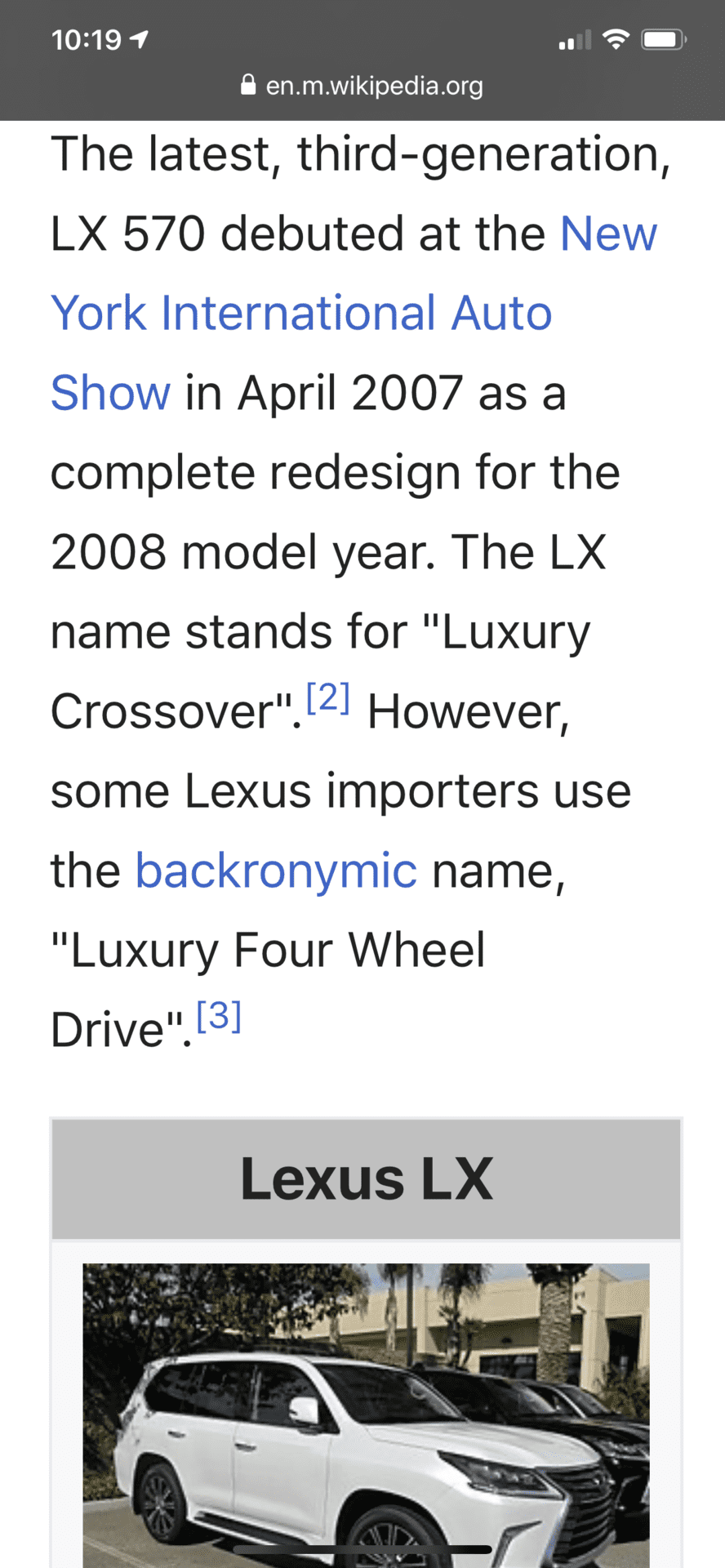

570 debuted in 07 as an 08 model.
Check here:
Success. Lining up the torsion spring while holding up the tailgate with one hand while trying to line up and thread a hinge bolt was a bitch. If you move too much the torsion spring snaps back out. Took about 20 tries to get it
Two people would have made the torsion spring part easier.
Check here:
Sure, most if not all vehicle manufacturers begin sales of a new model year at the end of the current model year. So, the first 2008 LX570s, LCs, etc. would have been built and sold in mid-to-late 2007 (That doesn't make them 2007 model year vehicles). The year on the title will say 2008. You can't order parts for a 2007 LX570, nor can you order parts for a 2008 LX470 no matter how hard you try.
I was responding to the claim that he could not have a 2008 LX. maybe I misunderstood what was meant…. But meh... ;)

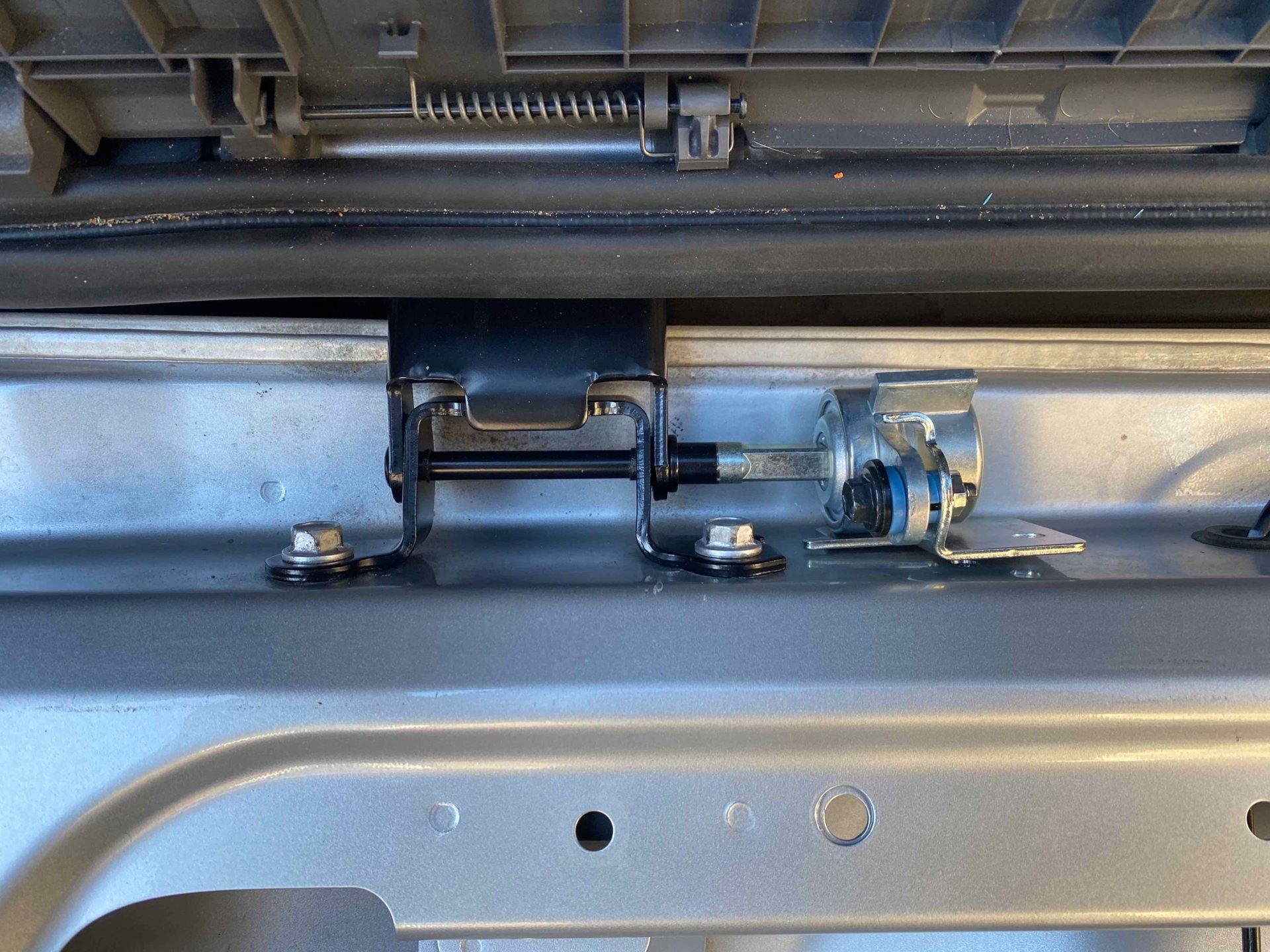

can you post a photo of the situation?
File attached. I think trying to twist the damper with a screwdriver has made it a snug fit on the hinge, but it will slide all the way on.
If you're able to slide the all the way on, you should be fine. It is very stiff, so I wouldn't bother trying to operate it without it being totally bolted on.
If you're impatient, the bolt that holds the cargo tray into the tailgate should thread into the hole. You could do that to as a temp measure to test it.
I didn't think about trying one of those bolts... should have tried that! I ordered a few parts yesterday so the factory part should ship to me sometime this week.
This worked like a charm. I used a file and smoothed out the high spots inside the damper that I made with the straight blade screwdriver. Bolting the damper did the trick- whatever the problem was (and it was extra stiff at first), it just worked. Thank you!
