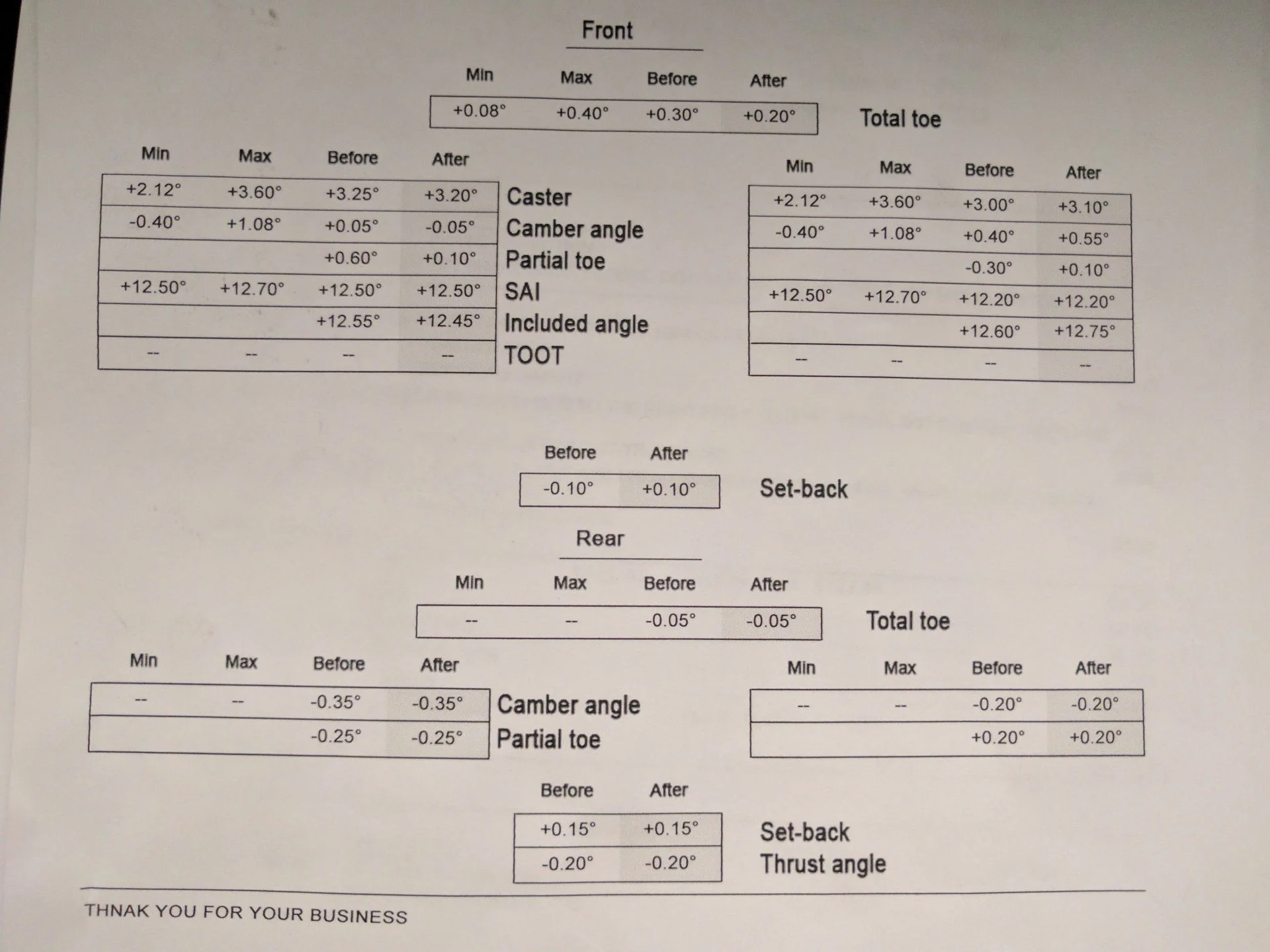

Couldn't find other threads specific to alignment numbers so since yours was the last I recall posted I figured I'd post mine here. Took my truck back into the place who did my 1st alignment post Tundra/lift install - that was 5k miles ago and they do a free re-align w/in 1yr/12k miles. I was off a bit after the 5k miles, I noticed mostly the truck drove pretty "straight" but took effort to keep it down a line. I only got to drive for a few mins after pickup but seems to be close to perfect again. Caster is at 3.2/3.1 which is about a degree higher than it was previously, but still not as aggressive as some guys run (5 to 6 degrees). No clue what half the other numbers mean :)
