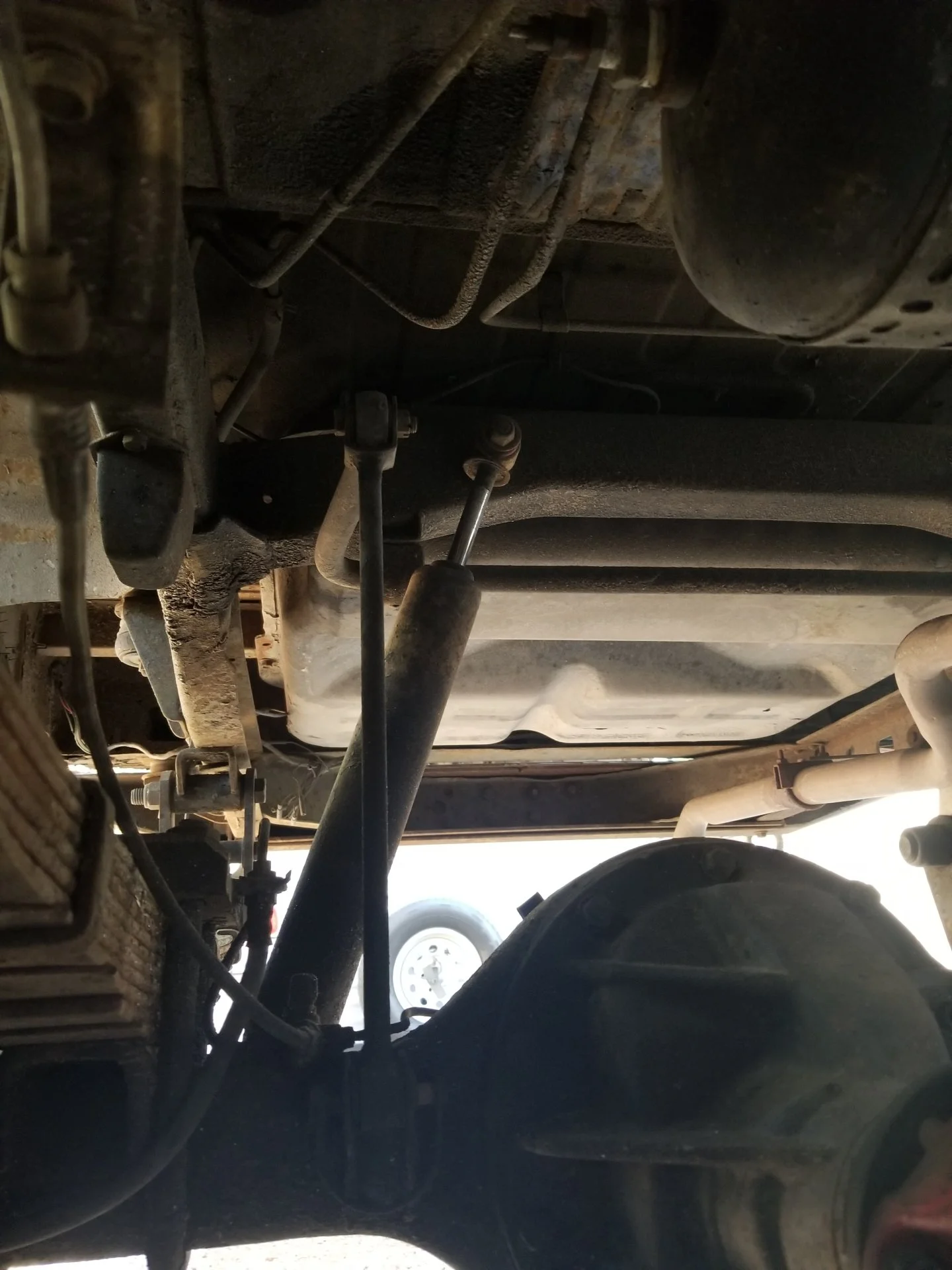

On my low SOA 40, I had no body roll issues once I put Rancho R9000 shocks on it.

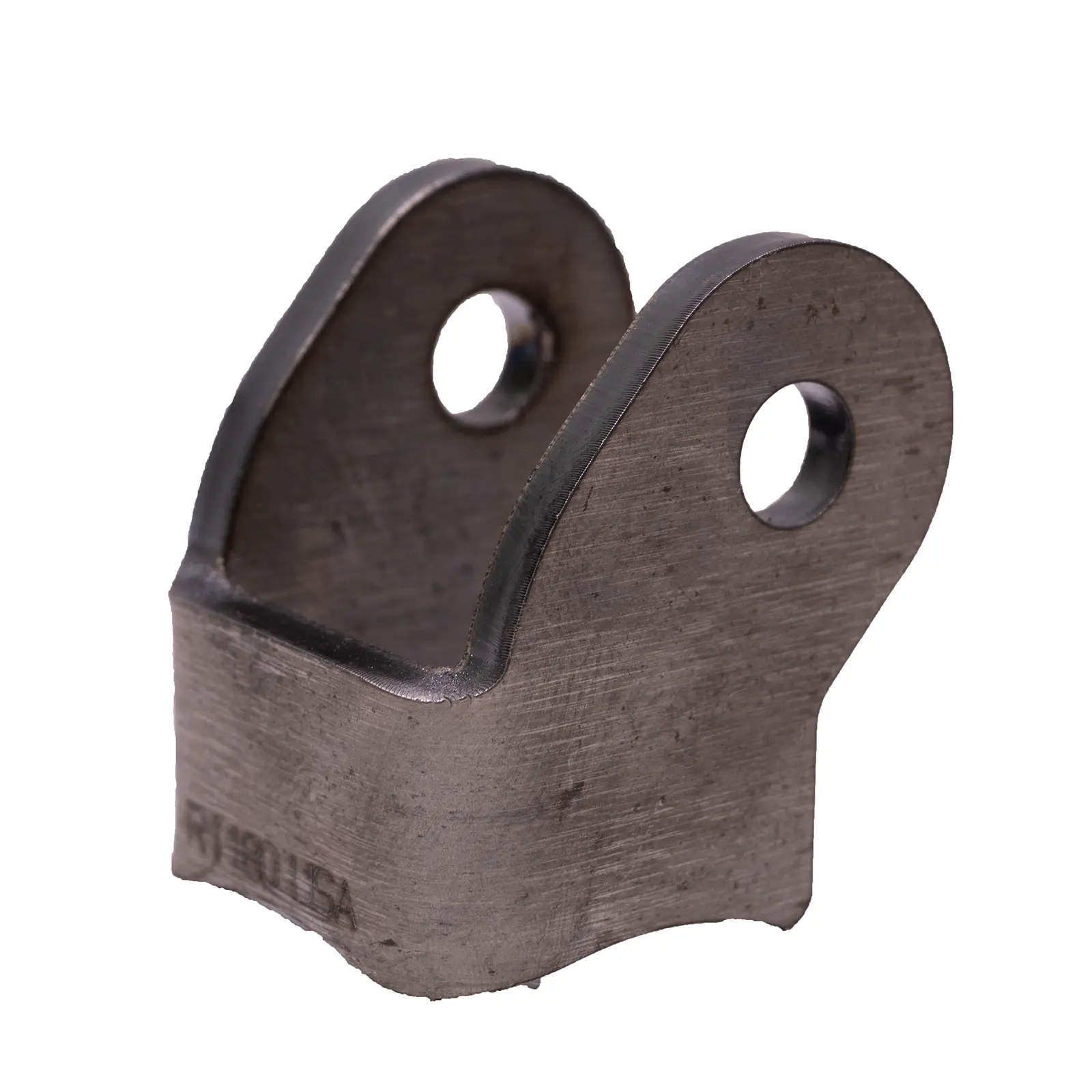

@pjohnson how did you mount the rear shocks to the axle? Thank you!
