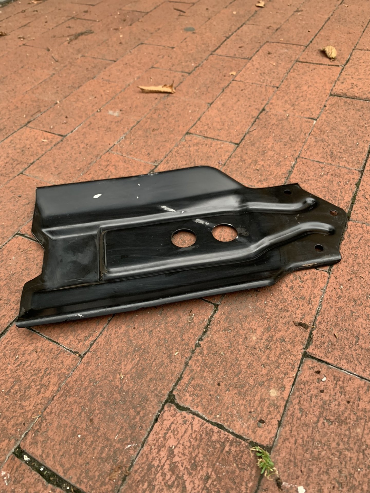

Does anyone recall if the metal brackets that I painted above install above or below the carpet… I cannot recall. do they hold the carpet in place or does the carpet go over them?
Thanks. That means I can not just test fit, but fit, before reinstalling. That will take some work out of it.

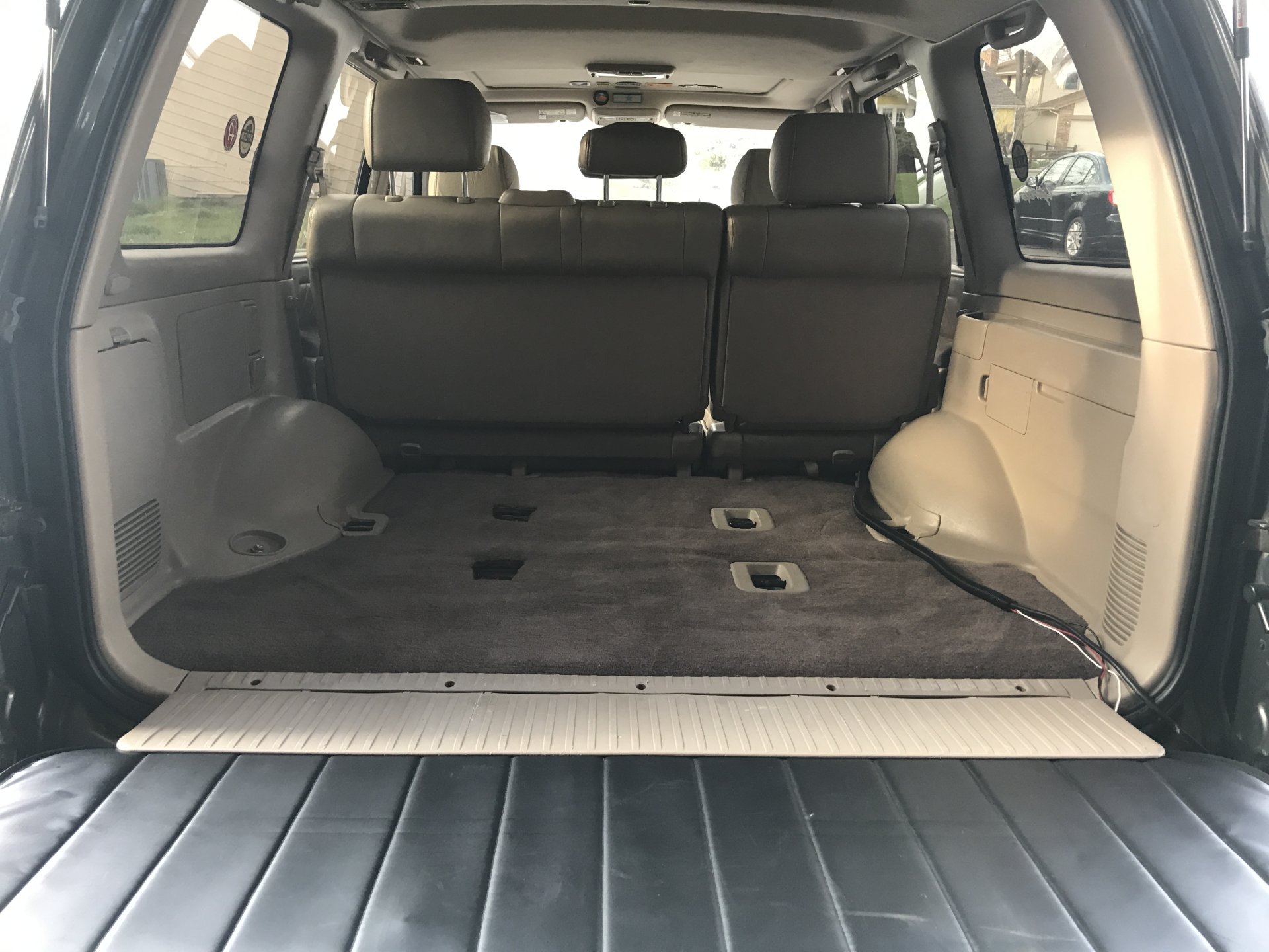

I have the carpet and all the seats but the passenger back installed. There may be somewhere in the multiverse where a version of me would do this sound deadening project again... but it is kind of hard to imagine. It was an absolute bear to get back together and I had to cut away lots of places that I carefully installed sound deadening just days before to get things to fit again. Unless you really, truly, truly care about having a super silent ride, I would not recommend this to anyone I liked. Great products, but just a lot of work to get right. The worst part, I still have each of the doors to do. So the hard part may still be ahead of me!
Upside, the real reason I started all this was to clean the carpet well... and I did that, and it will now forever be my dirt not the previous owners, and there is a value in that!

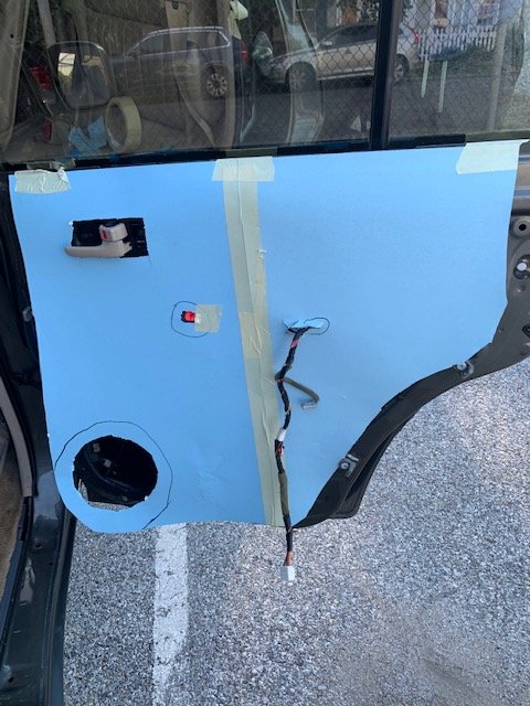

The next step I expected to be the worst... but to be honest, so far it has not been! That is getting enough space to get the luxury liner pro sound blocking to fit under the door card. My solution below was well worth the time. Two poster boards taped together allowed me to trace and mark all the places that needed to be cut. And since the doors are largely the same, doing a template for one door should work for the other side too. I cut the front doors from the template today... and will tackle the rears tomorrow, hopefully. Happy with the results so far. Waiting on some grill cloth to redo the grills, then can reinstall.... but the test fits looked promising!

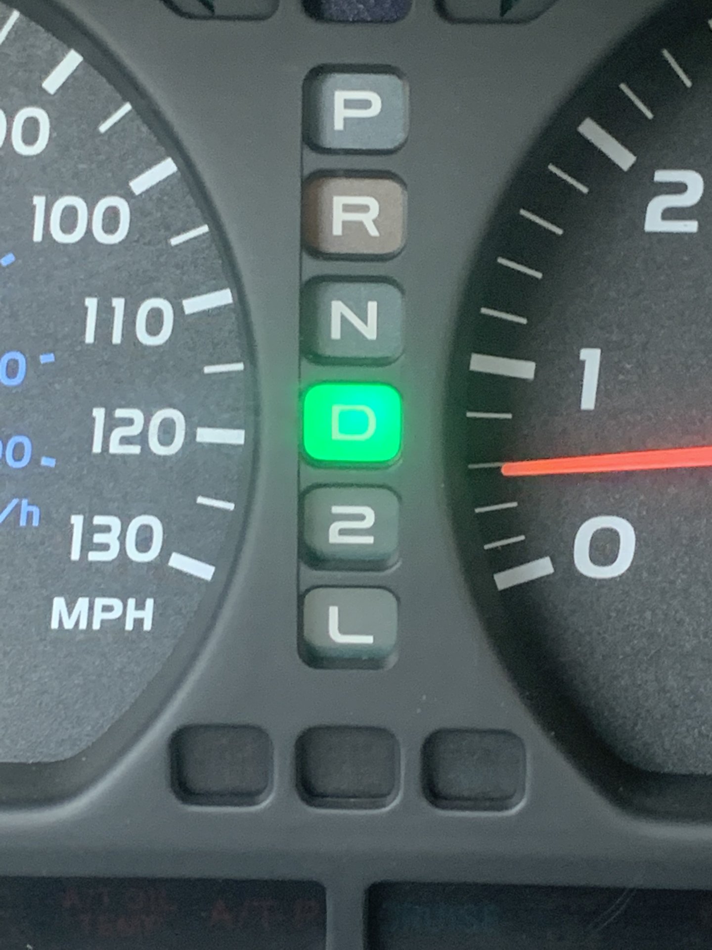

Most excitingly, I have a dash without warning lights!!! Since I bought it the ABS, VSC, Trac, and BRAKE lights have been on. Throwing two codes (c1223 and c1254). Working through the diagnostic on c1223, I came to the conclusion it was the ecu… I tried buying a used one, but lost like 6 weeks to a scrap yard that was slow to respond when they sent me a suspension height cpu for a LX. New scrap yard and correct part went in yesterday… but all the lights stayed on. I reset the DTCs and still the same ones came up. I started down the diagnostic for c1254 but that didnt give a clear direction. Not sure if I was doing some of them right, I called it quits last night. Today after work I went back out to try and chip away at it… and I found no lights and no codes waiting for me! A quick drive of a mile or so and none thrown! Seems like the ecu just needed the night to make friends? not sure I understand, but I’ll take it… hopefully it lasts!

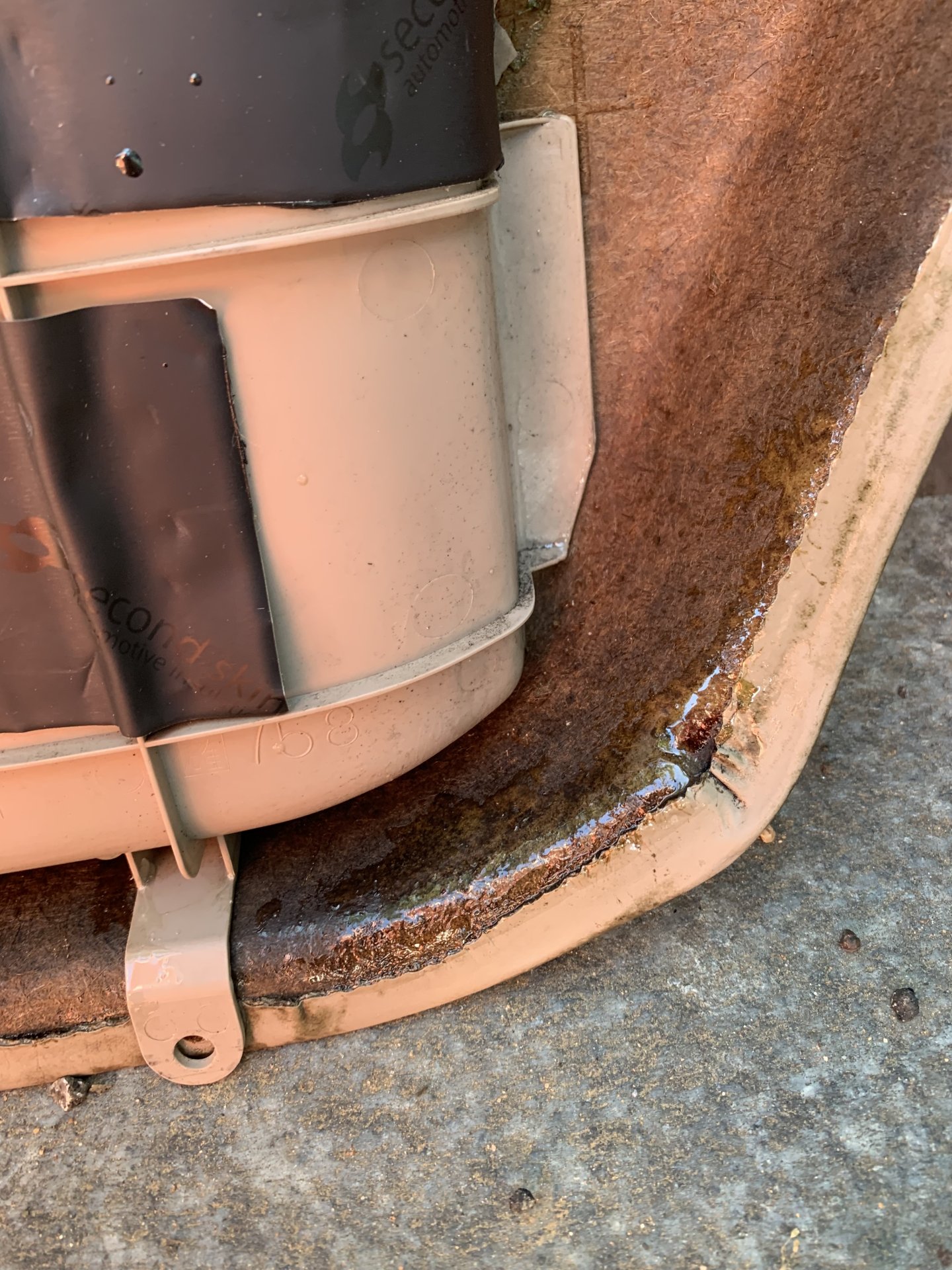

One thing that was common on almost all my doors was a soft spot on the door card on the bottom bend to the rear side of each door. Water ingress at some point, with some hard hits over the years. Not wanting problems to get worse, I mixed up some fiberglass resin and coated that section to give it some regidity and waterproof. Not a long term fix, but kept it from getting worse in the short term. I can always pull a skin off and do a legit resin with material if there is a problem. Hopefully I did the stereo all correct so until the window regulator or locks give me an issue, there will be no reason to remove.

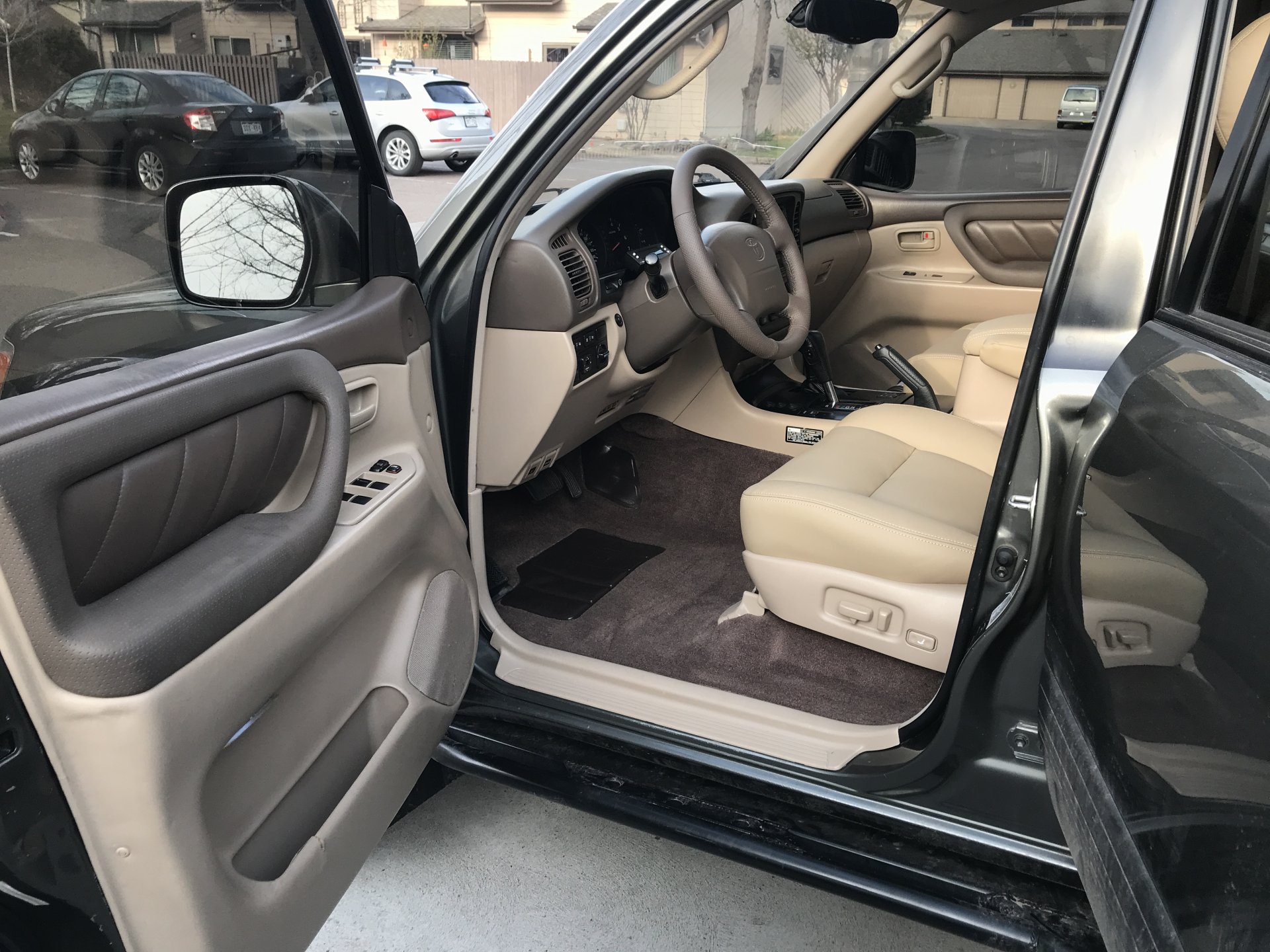

So what happened was over then last 3 weeks, the rest of the interior went in, and the interior project is over! I still need to tune the stereo, but can fiddle with that as time allows… that‘s a fun project! With that behind me I shifted to getting my fluids in order. Still have front diff and transmission to do. I had a window to do the work, so had to live with the fluids I could get my hands on quickly... but at least I now have a date and mileage to work forward from. The other two I expect to get done in the next week. Also did a 300 mile trip to Pittsburgh that went flawlessly!
