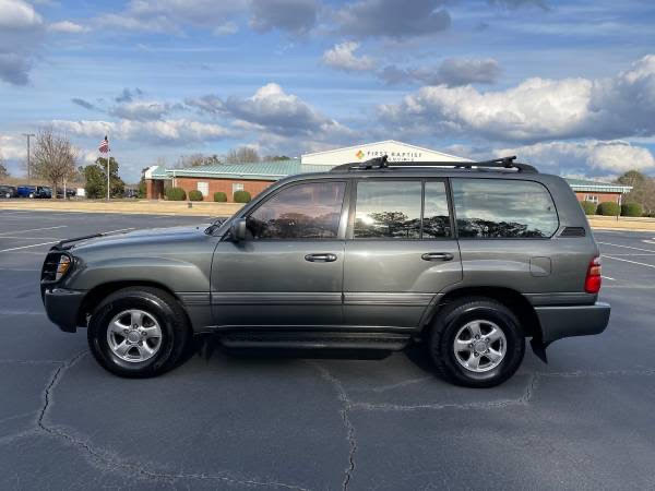

So what happened was I grew up in New England where rust was the ultimate killer... you could never win, you could just hope to stay in the game long enough to survive. So when I saw this 2001 LC posted down in Atlanta that was completely rust free I was hooked. Sure it had 348,000 miles, but I thought what could go wrong... Everything else is fixable. However, I did not mean that I WANTED to fix everything else, but apparently the car gods did not hear my thought processes clearly!
I hopped on a plane the next day on a one-way ticket and had a flawless drive back to DC... its new home. What could go wrong?

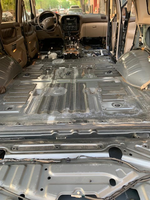

I can clean! So I started with the back carpet... but that just made the plastic trim on the sides look bad, so that came out too... but then the front carpet looked bad, so out it came as well! So now I have an LC stripped of nearly everything but seats!

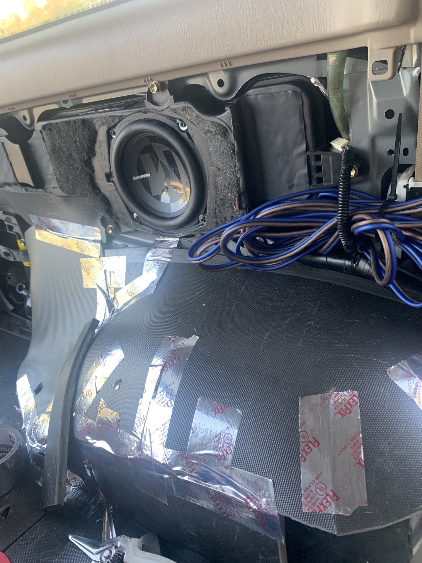

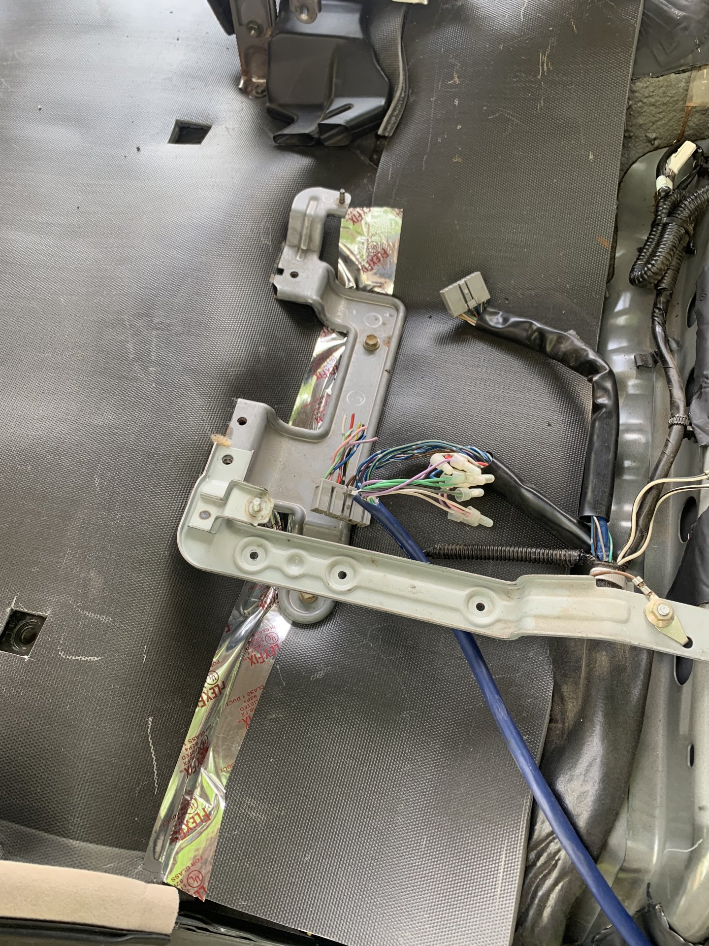

So what happened was I saw the stripped interior as an opportunity to add some sound deadening. I’ve installed layers of damping material before, when no one knew better, but the tech and understanding of sound has led to some new products, so here we go. Second Skin damplifier and luxury liner pro.
So rolling on the Damplifier Pro was super easy and way better than another brand I used a decade ago. That was easy… but doing the Luxury liner right is a legit time commitment. Really a big job To get all the pieces to fit back together… and still have lots to do before I know this will! That said, this product is great! It is really heavy and limp. It just flops down and stays there... horizontal surfaces that is. while all the cutouts in the floor are a pain… the bits under the front seats were both a blessing and a curse. A pain to account for all the holes, but once the ac unit and vent and the amp rack are screwed back in, they hold it tight! I still have front passenger seat and all the doors to do. More pics to come.

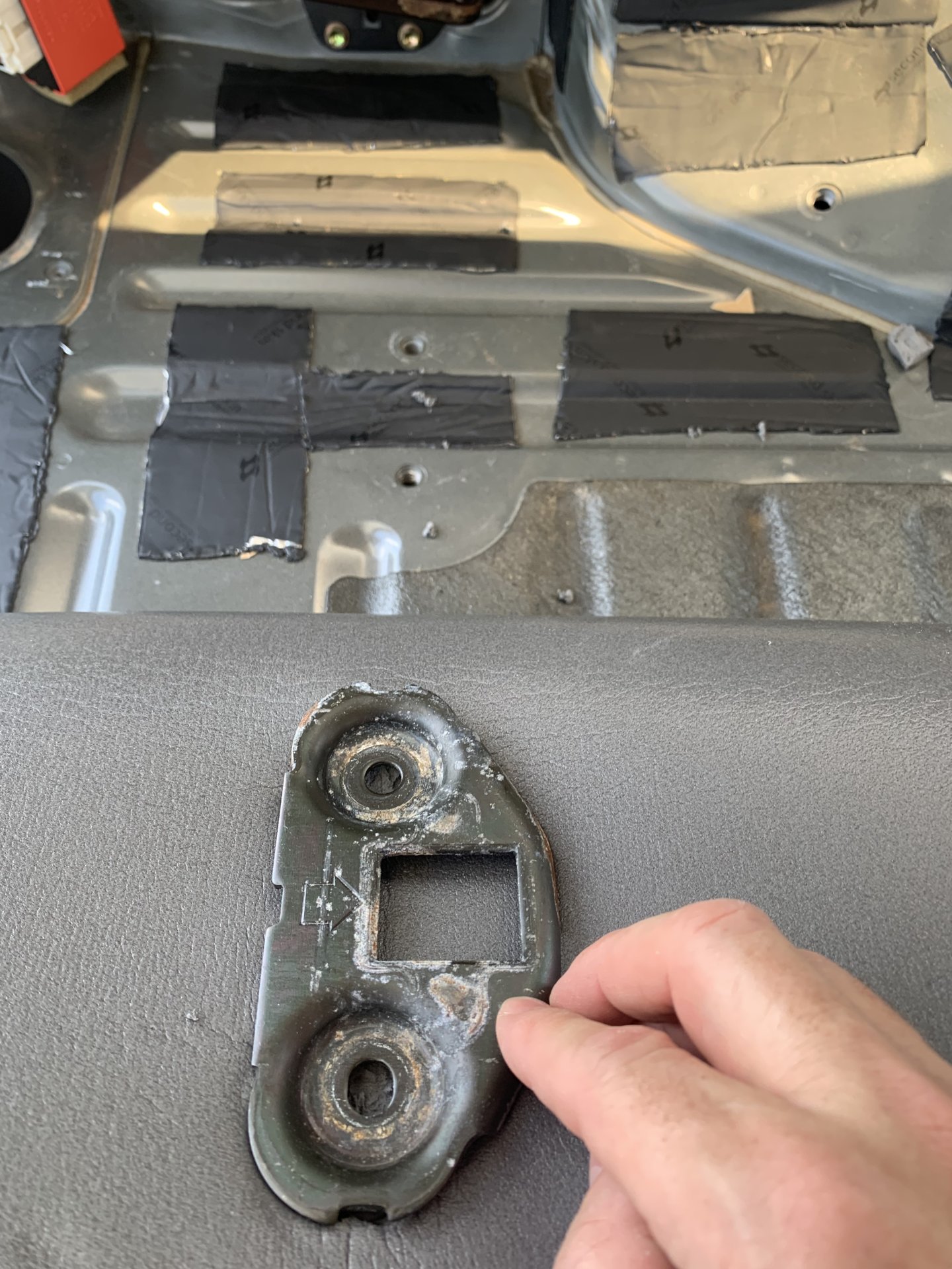

The Luxury Liner pro is a combo of closed cell foam and a layer of vinyl… it is probably between 3/8 and. 1/2“ thick. Obviously, if you try to just layer it down, none of the hardware will fit back together. Second Skin recommends not cutting the vinal, so I did my best to thin out the contact points for every seat connection, tie down, and any other screw that has to connect. It takes a lot of time, and often found I missed one and had to go back. I am already bracing for the pain that will be putting the carpet back in… assuming it will have to go in and out a few times to get everything to line up.
Also while things were out… just because they are covered by carpet and plastic, doesn’t mean they don’t want to be made pretty too!

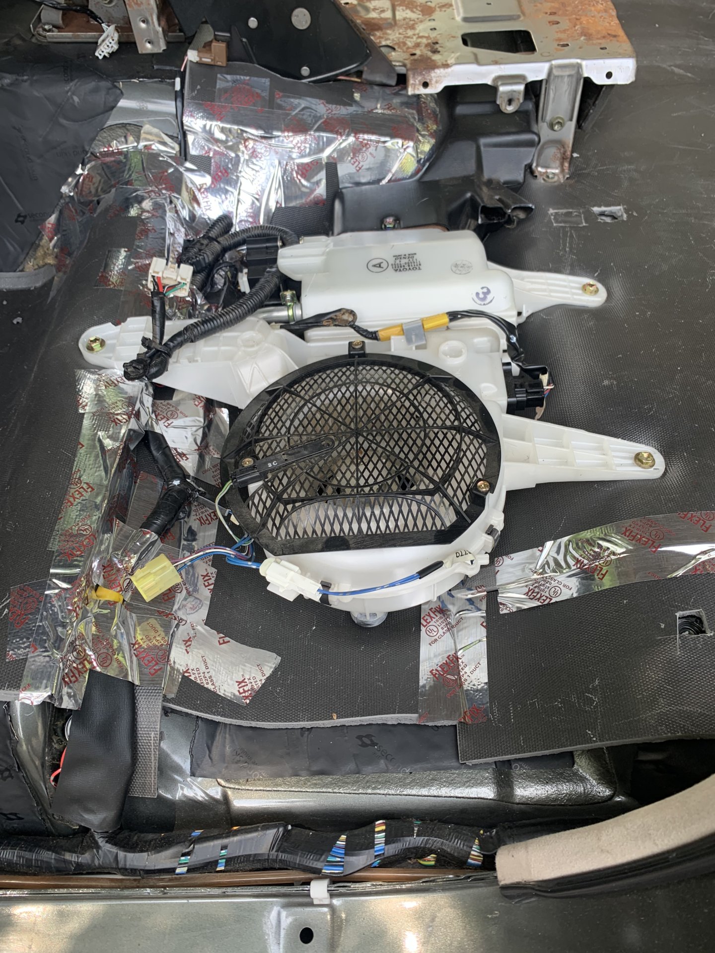

And while I am not super happy about this solution, I just needed something in and working, and I will revisit in the future, but I decided to just swap out the stock subwoofer for a 6” Memphis dual voice coil sub. Someone over on DIY Mobile practically gave the Memphis for free, after I asked what might work in such a tiny box… they just had no use for it. I have had systems that could really pound... that is not what I want for the 100 at all, but do want it to sound nice. I am hoping the sound deadening will lower the sound floor and make this a viable option for now. I really do not have the time to breakout the fiberglass right now for a better solution... and yes I installed the sub upside down, didn’t notice until it was all sealed up and cured, so wasn‘t going to redo just for an unseen label.
One upside, I was able to get the luxury liner behind the sub, under it, and all the way back to the rear, behind the jack. They said the key to a good instal is trying to get as much coverage as you can, for every place you miss creates a window for sound to come in. Like cracking a window, it doesn’t take much to allow all the noise from outside in! I may need slightly longer hardware to get the sub to sit right behind the trim panel, but it should work.

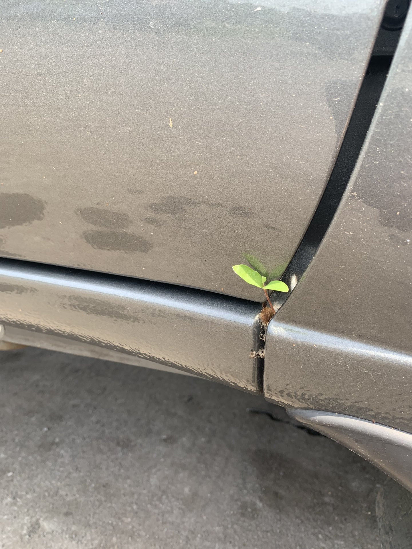

A first for me… I never weeded a car before! I almost felt bad pulling it out. I live in DC and they say things grow easy here… they mean it.

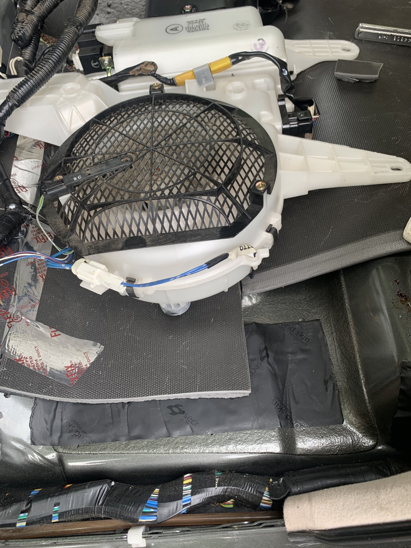

Anyone know what the yellow electrical connection on the left side of the pic? It was not attached to anything, and I couldn’t see anything to which it could attach. The heated seat connection is in white and that was connected.
Found this same lonely connector when replacing carpet recently. So far I haven't figured it out. I'm convinced it was never connected. Of course my before/reference photos didn't catch it. And google has failed me.
