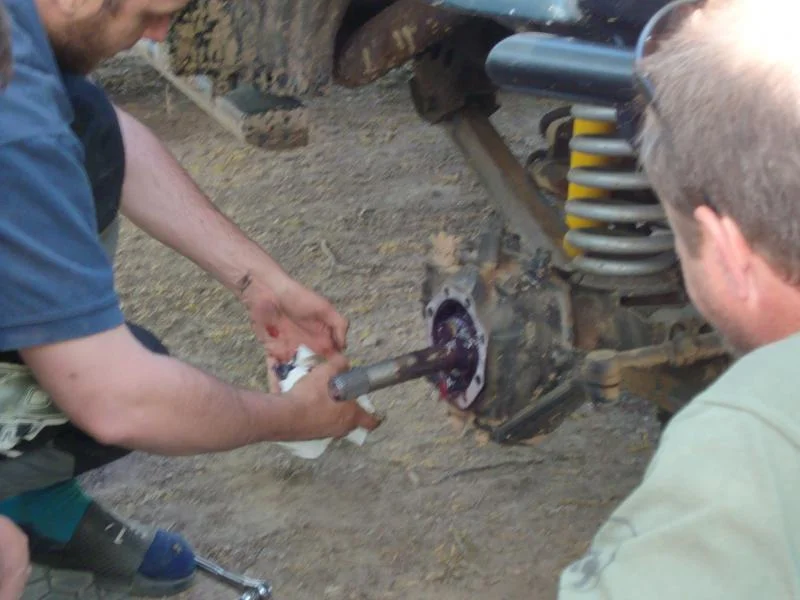

--Went on a little test run Saturday helping some of the upstate guys scout out Golden Mtn for GSMTR '10...was still running the stock 275 tires and was locked up turned to the right and...pow! The clicking pass Birf shattered. Bell was intact, but the star shattered, so went back to camp, pulled it apart and discovered that the incorrect inner axle (non e-locker)had been installed, so stuffed in some rags and put it back together. left the locker locked and pulled the plug on the front diff...drove home in 2wd...benefit of a part time case.
--Ordered a set of Longs Birfs and inners and will get those in as soon as they get here.
