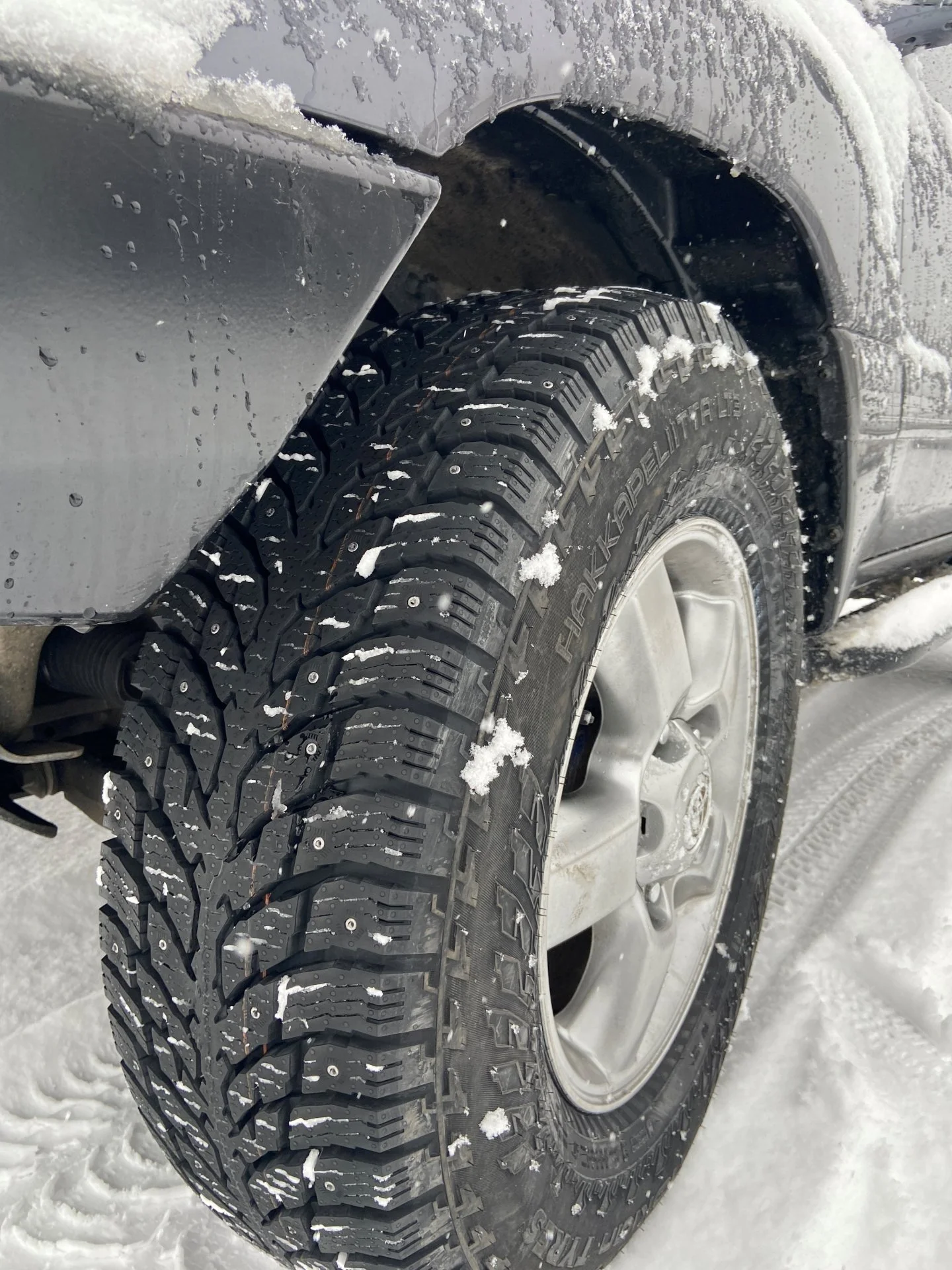

Got the new tires on just in time!
Those look great, after 10 years here in Steamboat, I have used a few different tires. Blizzaks have been our go to with great results and we have them on daughters' truck and wife's car. I just put some Cooper Snow claws on the son's Tacoma but sold it too quick to see how they did. I personally have use Cooper AT3 on my GMC 2500 for last 2 years but since they were great in the snow they didn't last much past 35K miles before I had to replace which was quite frustrating but softer tires simply don't withstand daily driving any other times.
Those Nokian (not gonna try and spell the other word) look great! I have never owned studded tires but would bet they do well on the slick stuff.
They are solid but I’m learning once it’s icy - slushy - icy, you’re gonna slide in anything. But these are a vast improvement over my KO2s.
