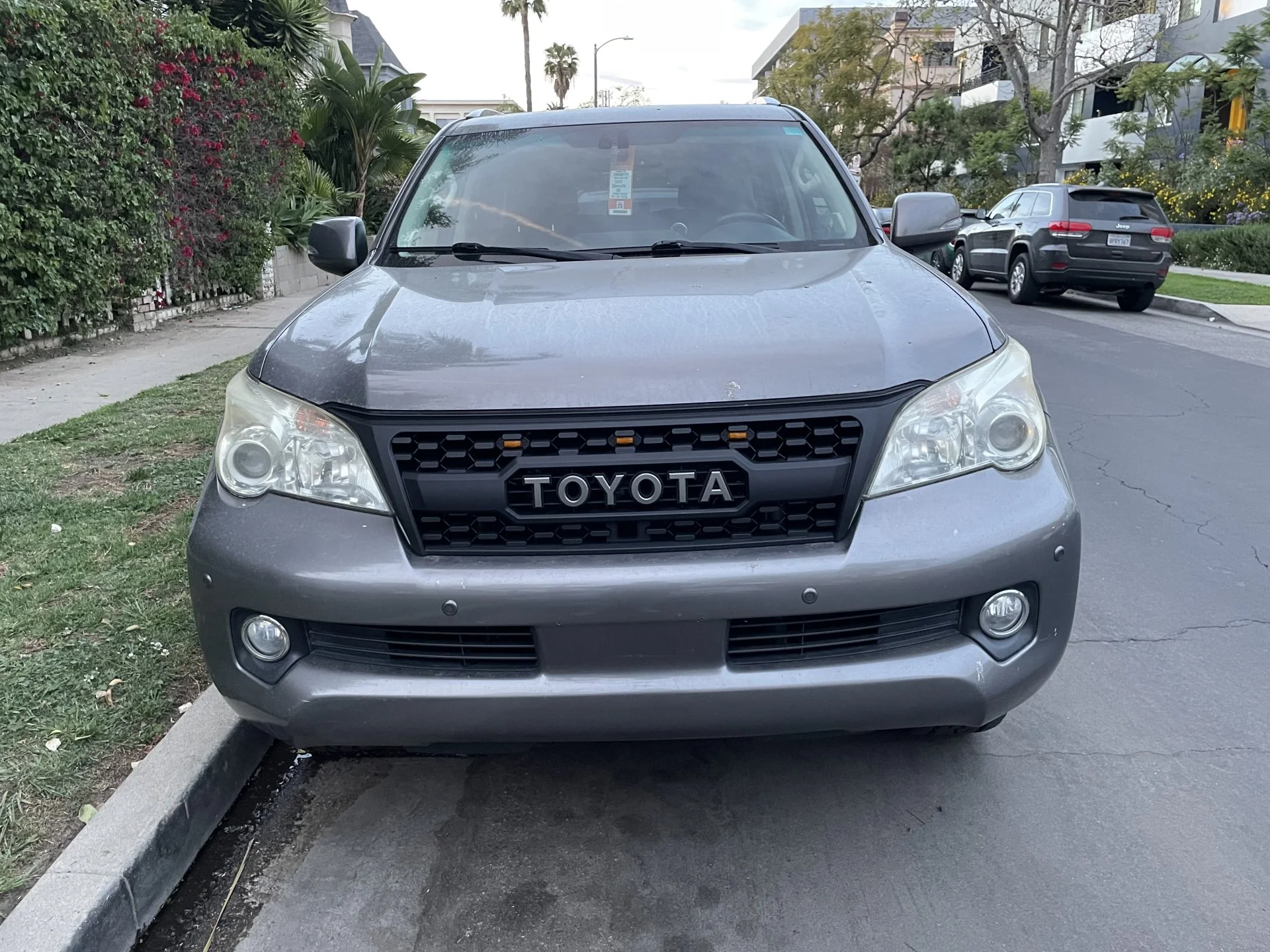

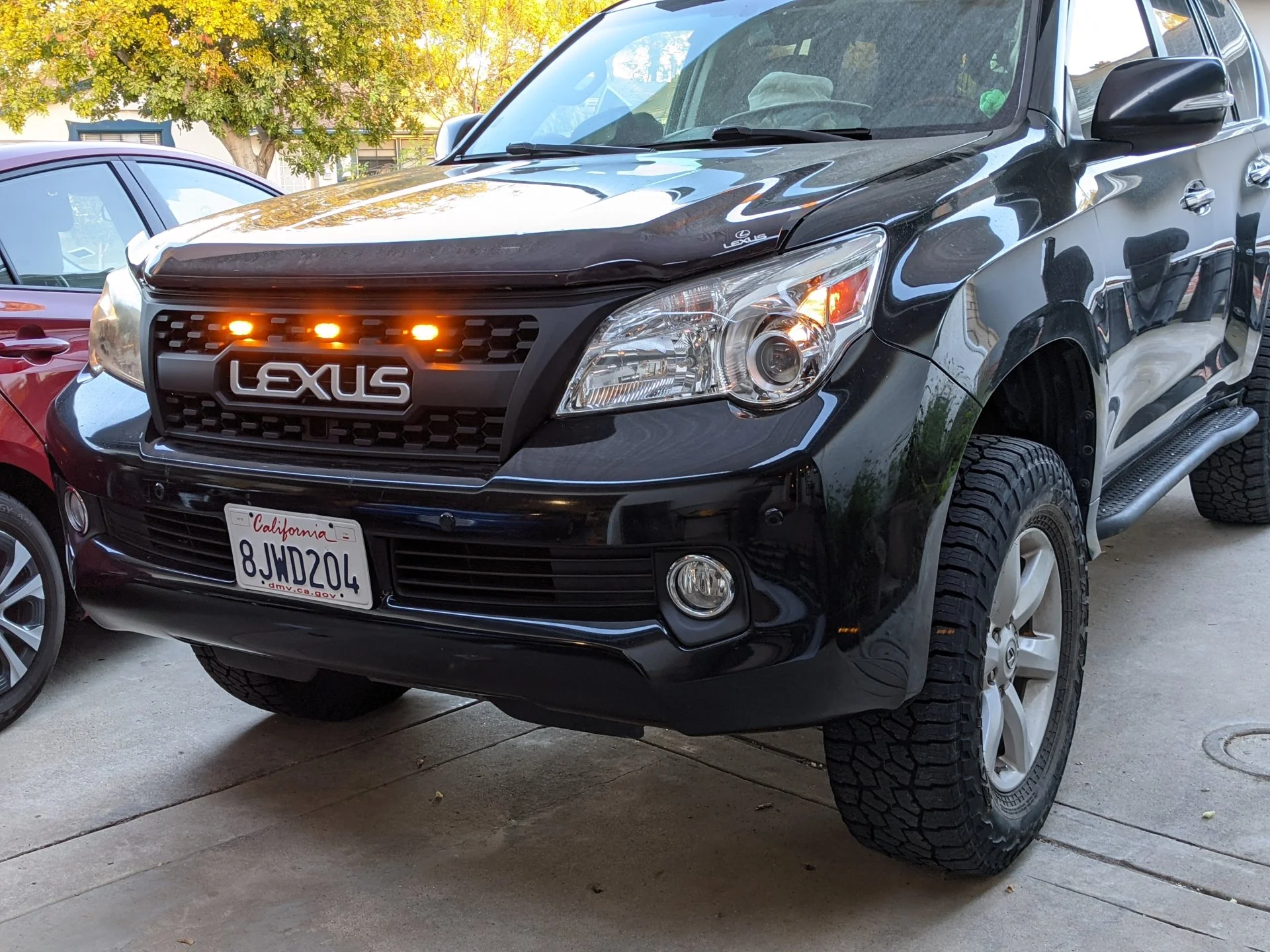

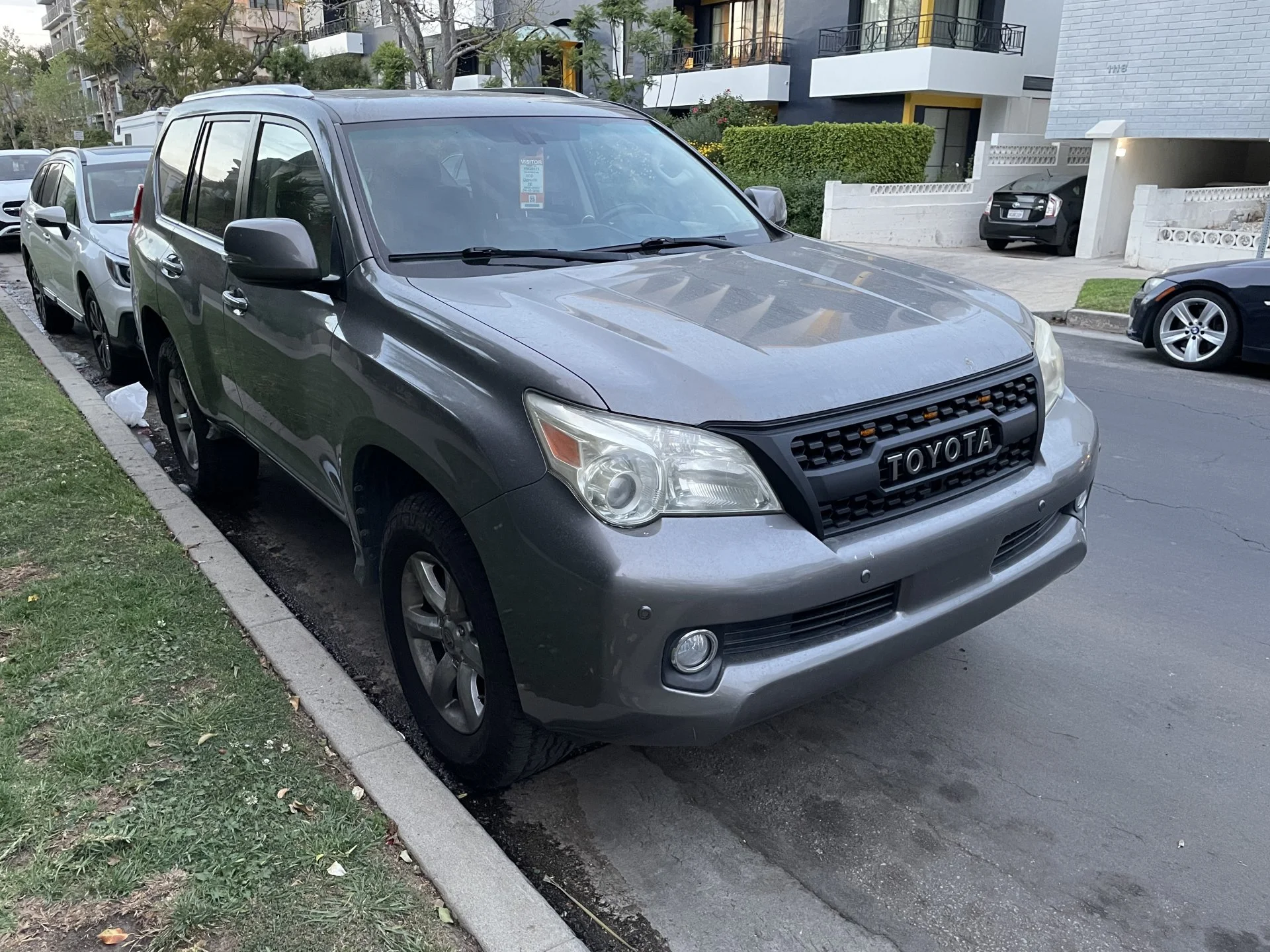

I had to trim the bracket a bit more than the pics I’ve seen in this thread and it still doesn’t quite fully “tuck” under the hood. After looking at others that have done testing, I’m guessing this is just how it’s supposed to look.
I haven’t wired up the Raptor lights yet. I’ll take care of that tomorrow.
Pretty straightforward install and it took me about 25 minutes including taking it off and trimming the brackets again.
Unfortunately I don’t think I love it just yet but that’s also probably because I’ve just recently started the build and haven’t done much other than maintenance so far. I’ll probably love it once I get wheels and do some additional modifications. I’m sure the faded headlights don’t help either. That’s on the docket for the weekend.

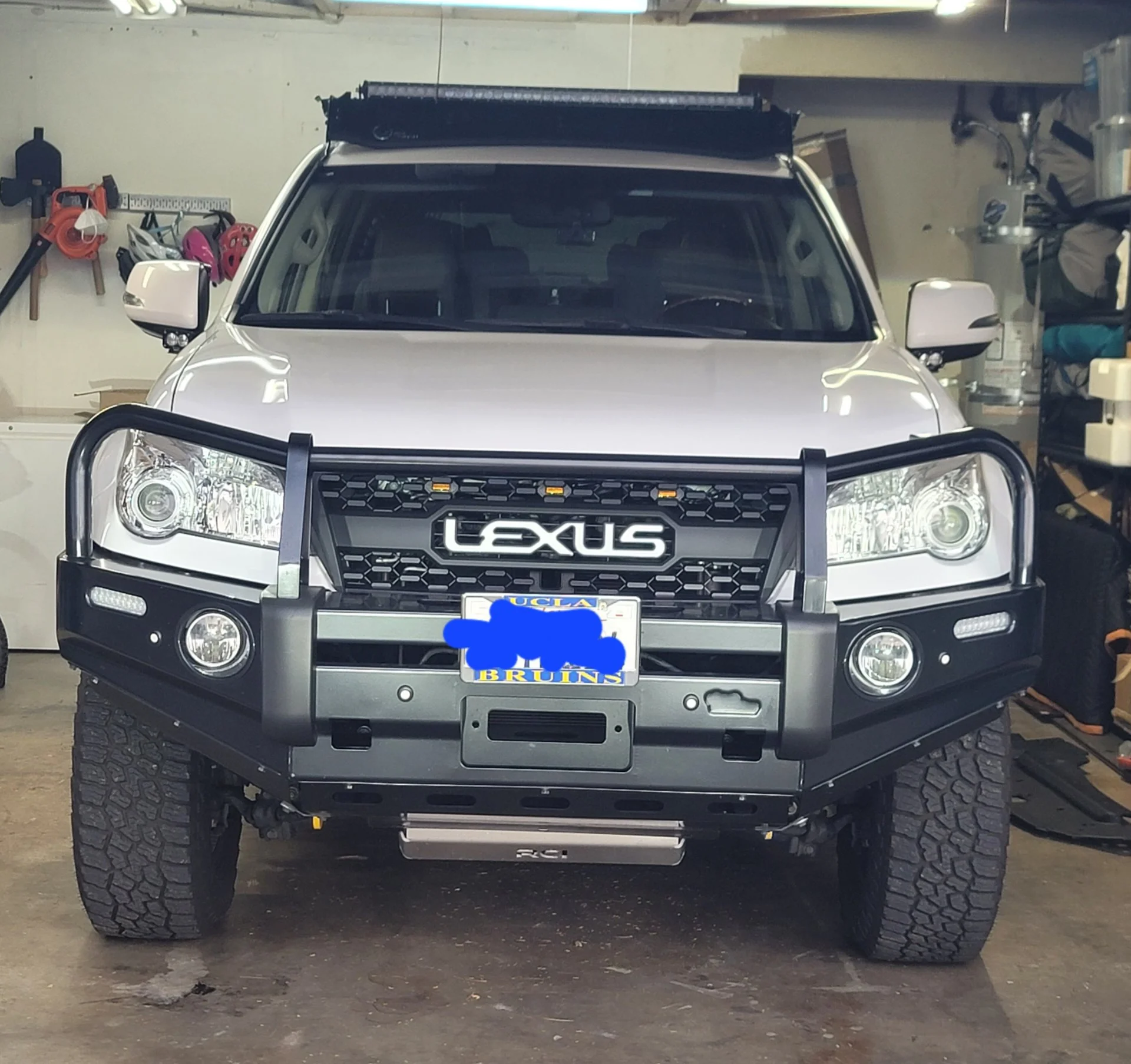

I got mine today and installed it. I had a little issue fitting the grill. I had to "stretch" the grill so that it would fit onto all the mounting points. I also had to trim the brackets a lot more to fit the grill but still there's a decent amount of tension in the grill to fit it where the brackets are mounted.

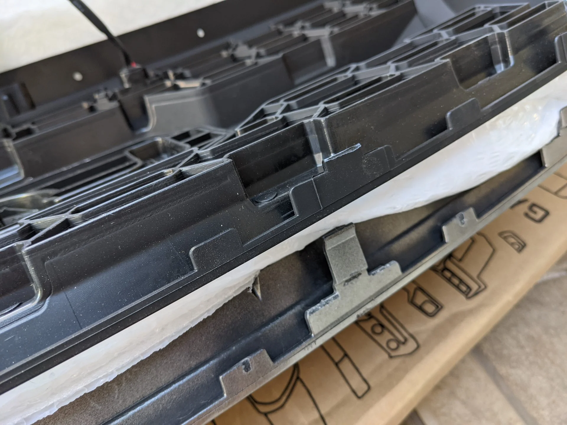

Damn thought I'd be first to post, ah well. Little disappointed it came with a broken tab, but I installed anyway. Same issues as others mentioned about fitment, it's about 95% there.

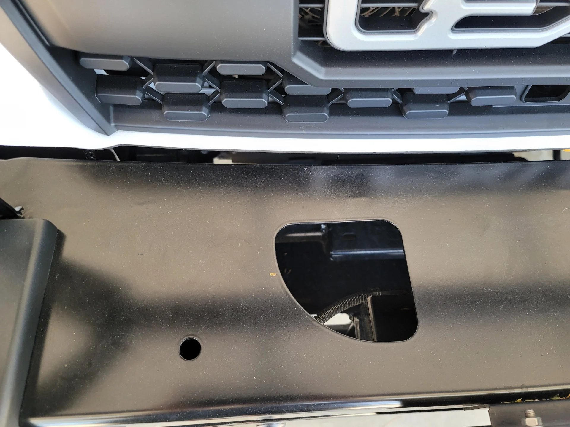

If I got one of these grills, wonder if I'd have to do any trimming with my MetalTech front bumper??

Don’t scare me, I’m hoping it’s all good. There’s already a gap with the factory grille so let’s hope that extra space is good enough.

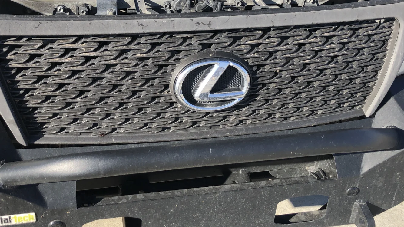

I'm not sure if this pic helps but I don't think you guys with metal tech bumpers will have any issues. The new grill is about the same size as the f sport grill. I would say that the new grill is a tad smaller since there are small gaps on the side and top.
