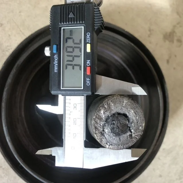

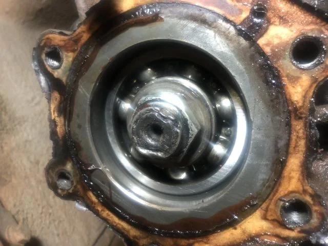

Snapped output shaft?
I read a thread about using a puller (all examples seemed to be tabletop, not in vehicle). Is it really just the three 17mm bolts holding it in (other than the press bearing)?
One shown here, and 2 above

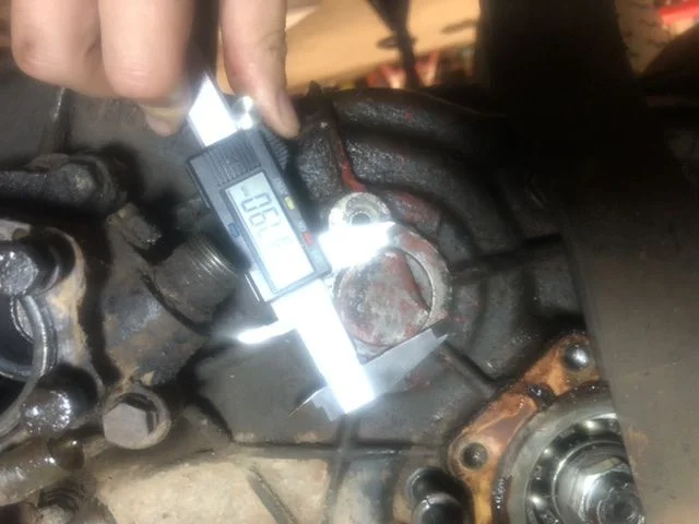

You measured the output shaft. In your pic the idler shaft has the redish goop around it. Sort of in the center of the case.

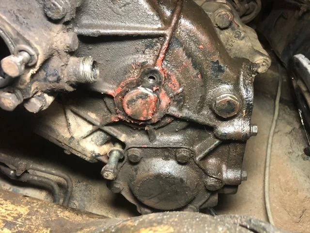

Any good ideas on how to remove this nut that’s on the tranny shaft? I have two problems.
1. as I try and turn it, I already removed the drive lines and it wants to spin
2. The crush part of the nut must have been hit with a hammer. It really doesn’t want to un-crush.
is the transmision in gear with wheels chocked? that may help in keeping it from turning
an impact gun will work
a small chisel to get in the groove and bend the tab back out
any or all of the above
Isn’t that the middle one? I’ve tried to find a labeled diagram, but have been unsuccessful. You may be under the impression that I know what I’m doing.
Yes, the middle one you measured is it.
