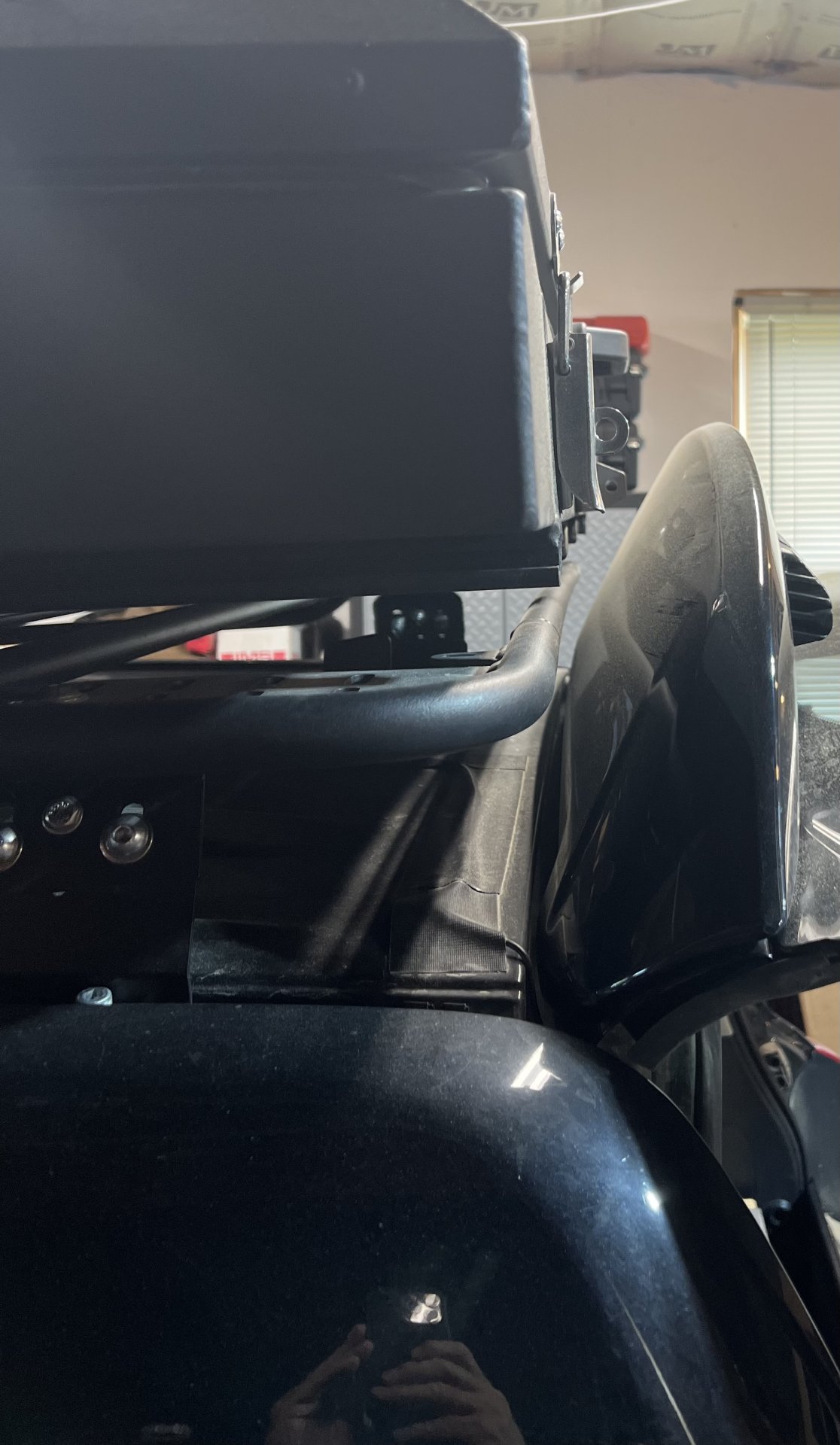

Does anyone run an awning on the rear of the 200 that deploys without interference with the spoiler in the upper hatch door open position?
I don't want a full size awning on the side, just a small one I can cook under at the back or get out of the sun or rain.
Any info you can share would be greatly appreciated.
A traditional awning seems impractical with my setup. Maybe one of those tent things like you posted above would work? I don't ebven know what to google for to find one though...

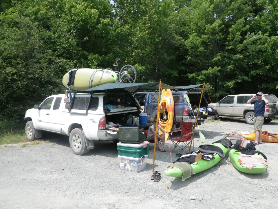

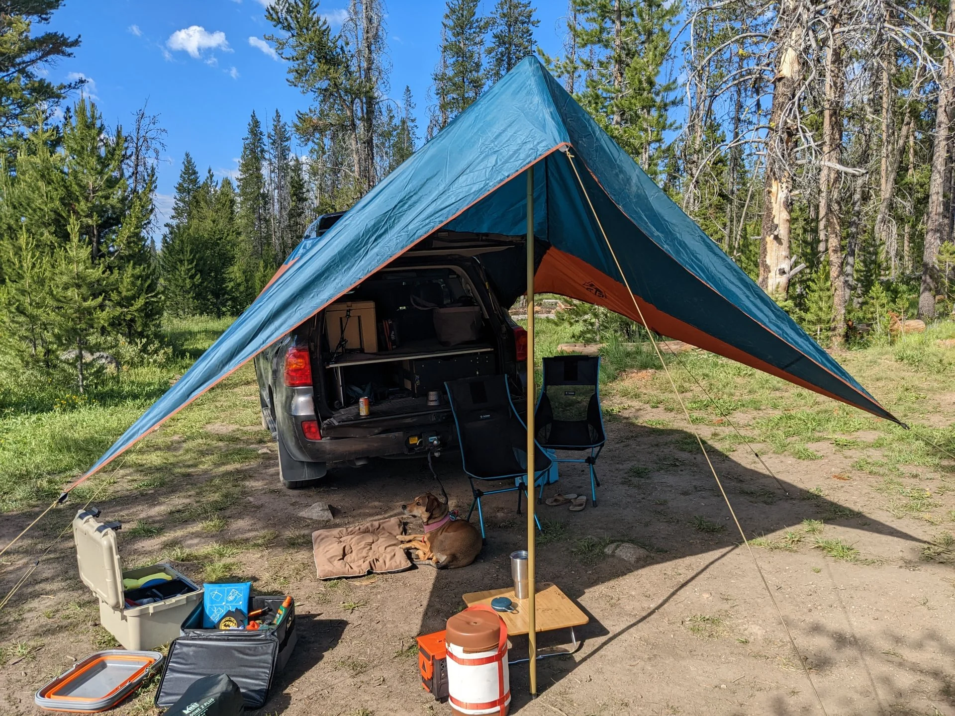

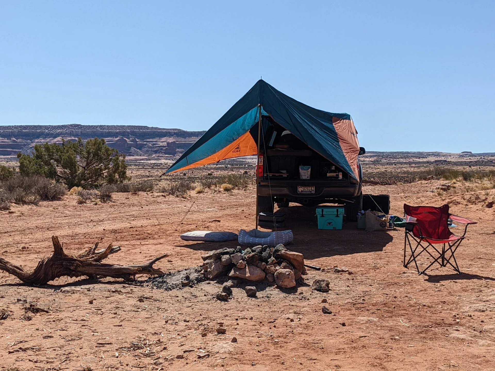

At one point I made an awning for the rear of my Tacoma that might work in your situation. It was a 6x8' nylon tarp from REI that my wife sewed heavy duty velcro tabs to one end to attach to the rack bars. Then I used a set of Kelty Tarp Poles for the other end. It worked great to provide shade/light rain protection. Heavy pooling rain was too much for the velcro, but a different attachment method would surely work. Tie off required, in this pic I was using a long kayak :rofl:

Yes! I love this. Thank you.

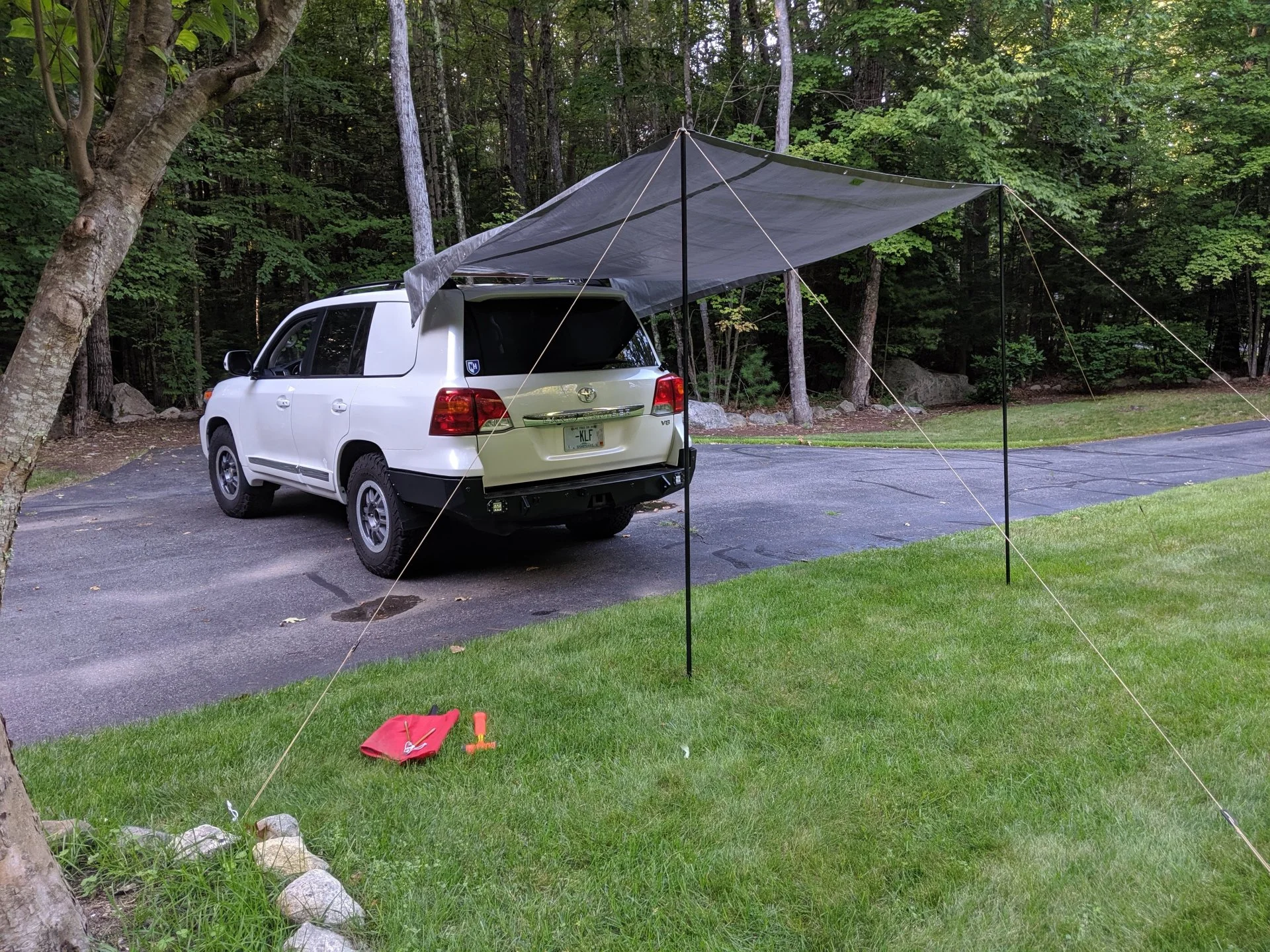

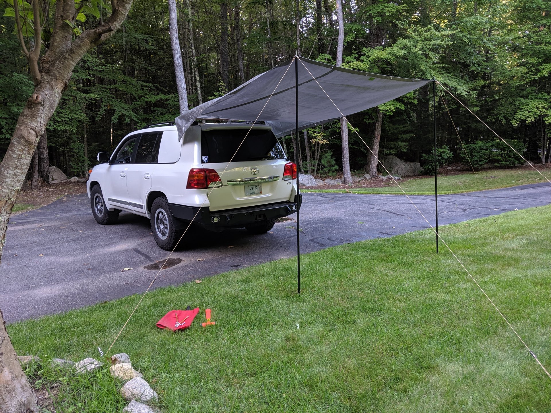

Something I rigged up with a tarp, some poles I found at EMS, string, stakes. I made a bar that bolts to the roof rack rails out of a piece of scrap maple I had. I've since added hooks on the front corners of the tarp that hook under the rear quarters above the tires with bungies, they are padded so they don't scratch the paint.
Yes, I can open the hatch and it doesn't cause any issues.

Yes! Maybe I can make one out of things I already have around the garage?!

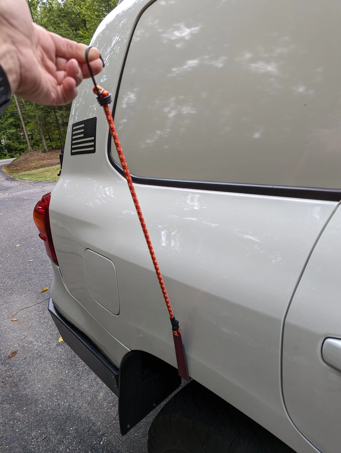

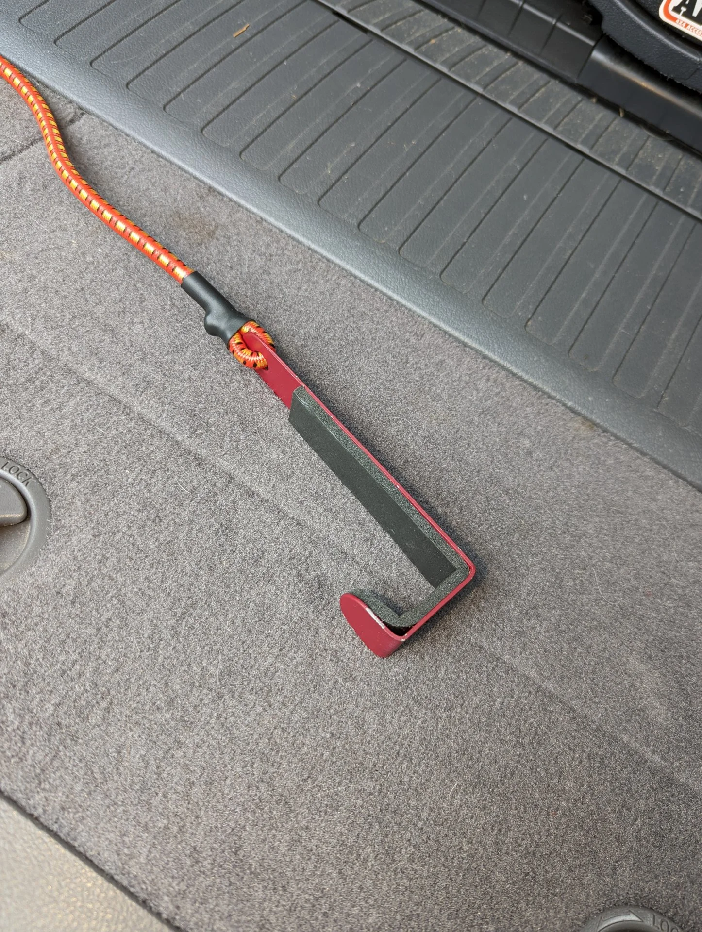

Hooks I made with some scrap metal and bungies. Padding inside the hooks is peel-and-stick foam weatherstripping.

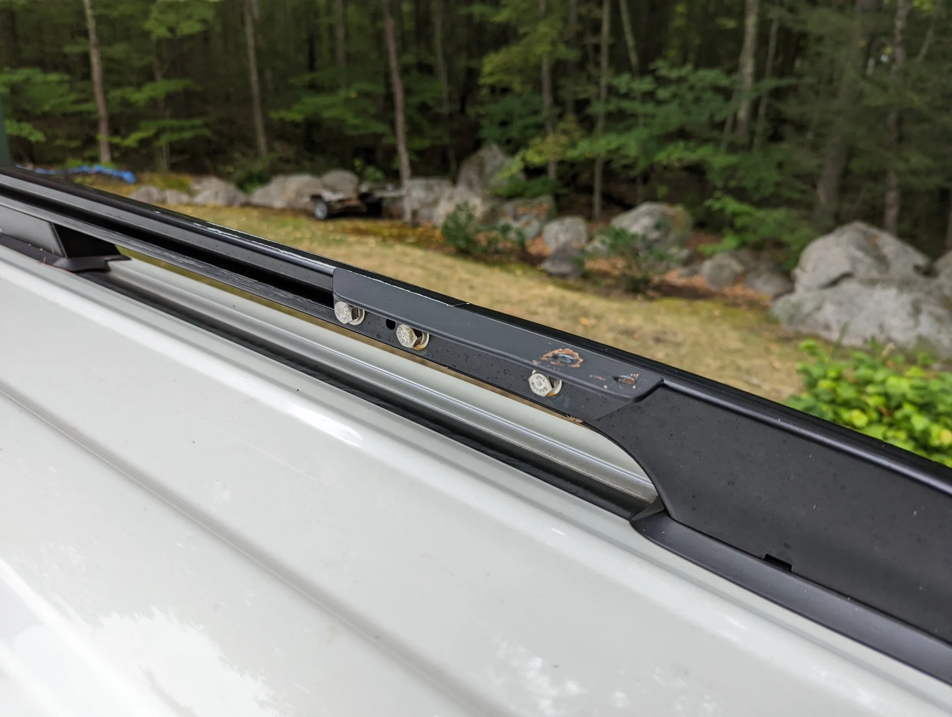

Brackets I made with some angle steel, the SS bolts go into bar stock that was tapped and slides into the roof rails. You have to pop off the plastic covers to get access, but it's easy. Like everything I do, they are way overbuilt and overthought.

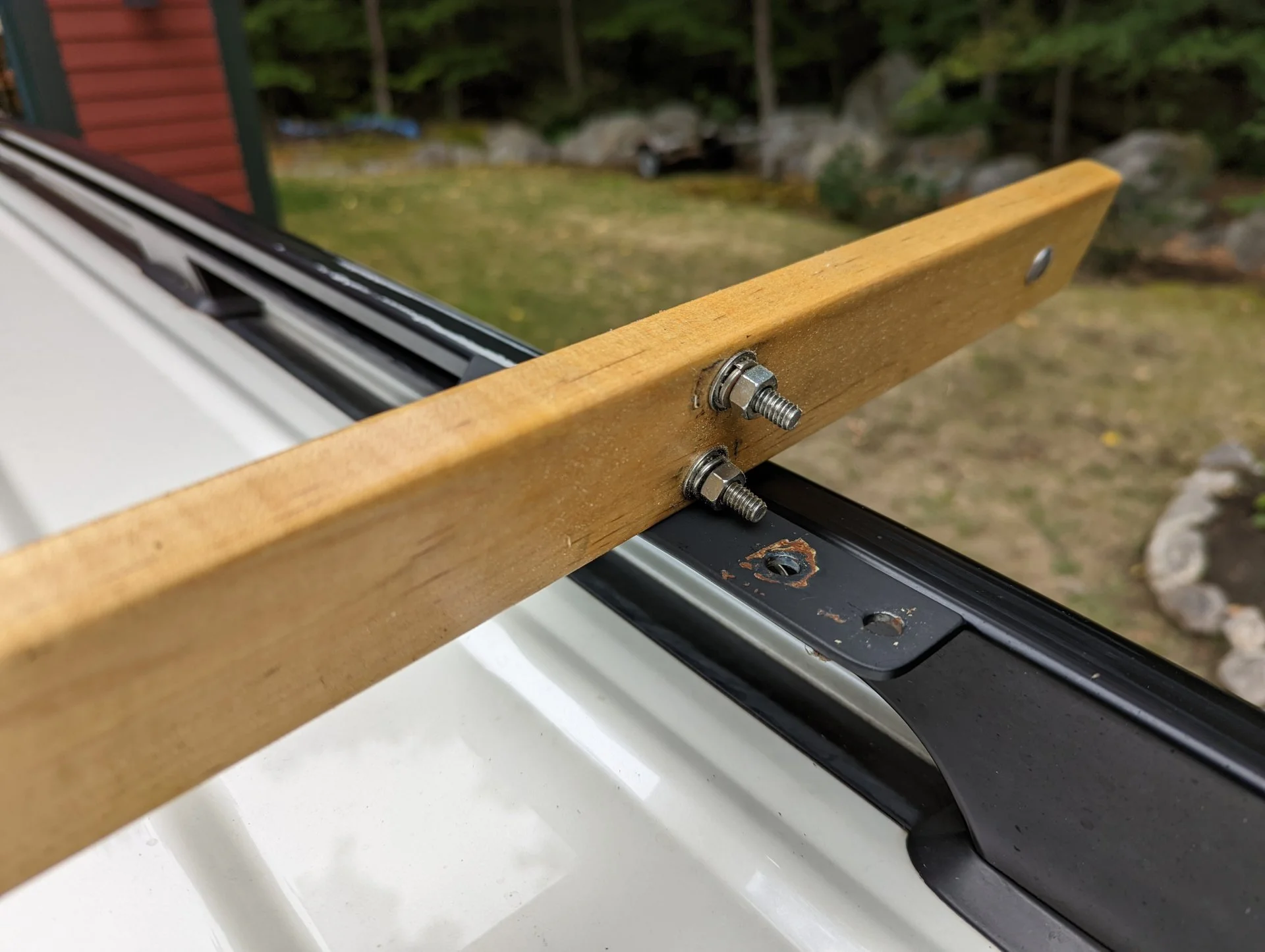

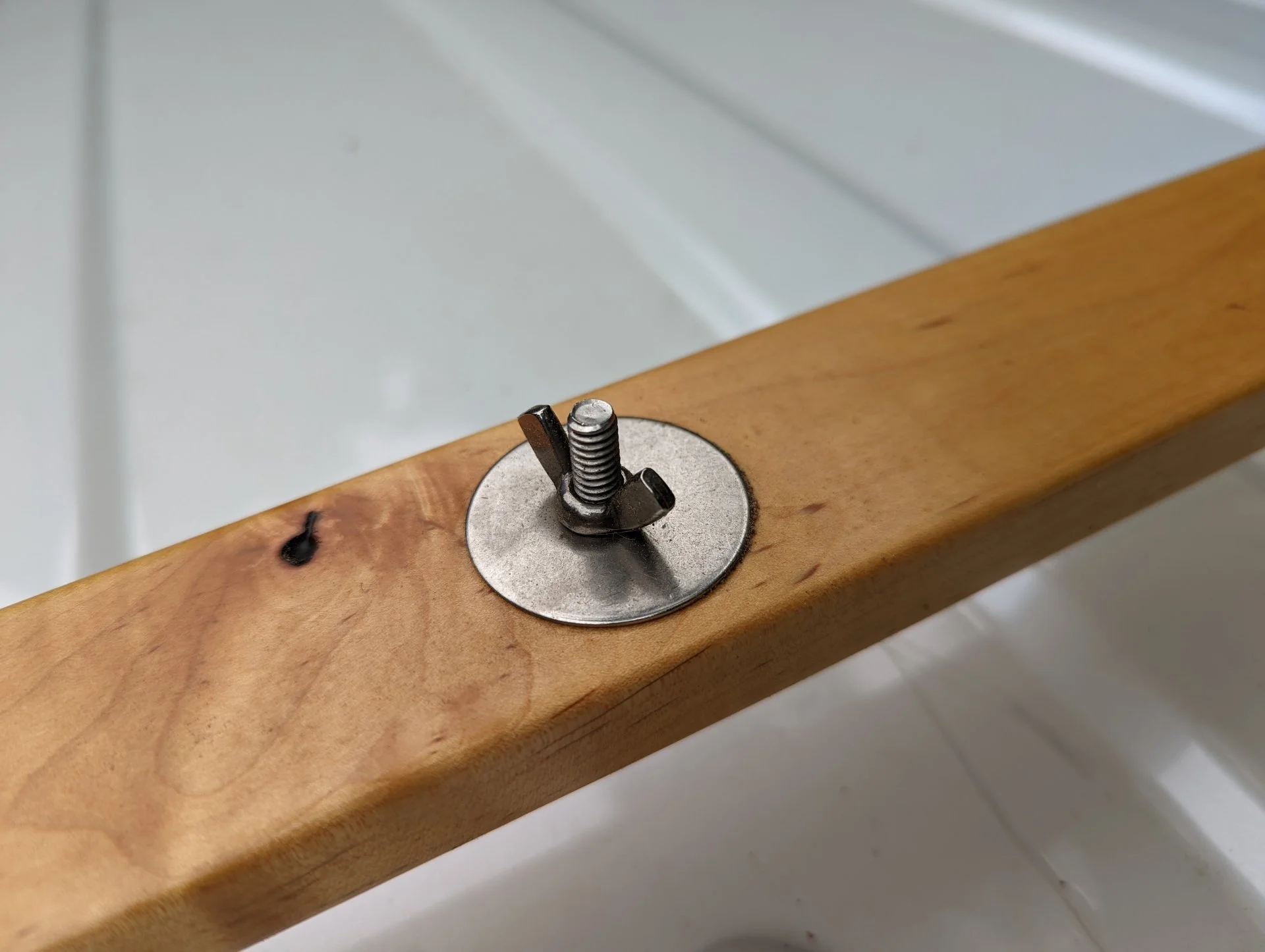

How the maple cross bar bolts to the brackets...
The crossbar is about 5' long, and has several coats of poly for weather proofing. I don't leave it up there, it does howl a little on the highway.
I epoxied SS carriage bolts into the crossbar at the locations of the grommets in the tarp. Wingnuts and a big fender washer make attachment very easy.
a 3/8" carriage bolt also slide right into the OEM roof rack rail.
