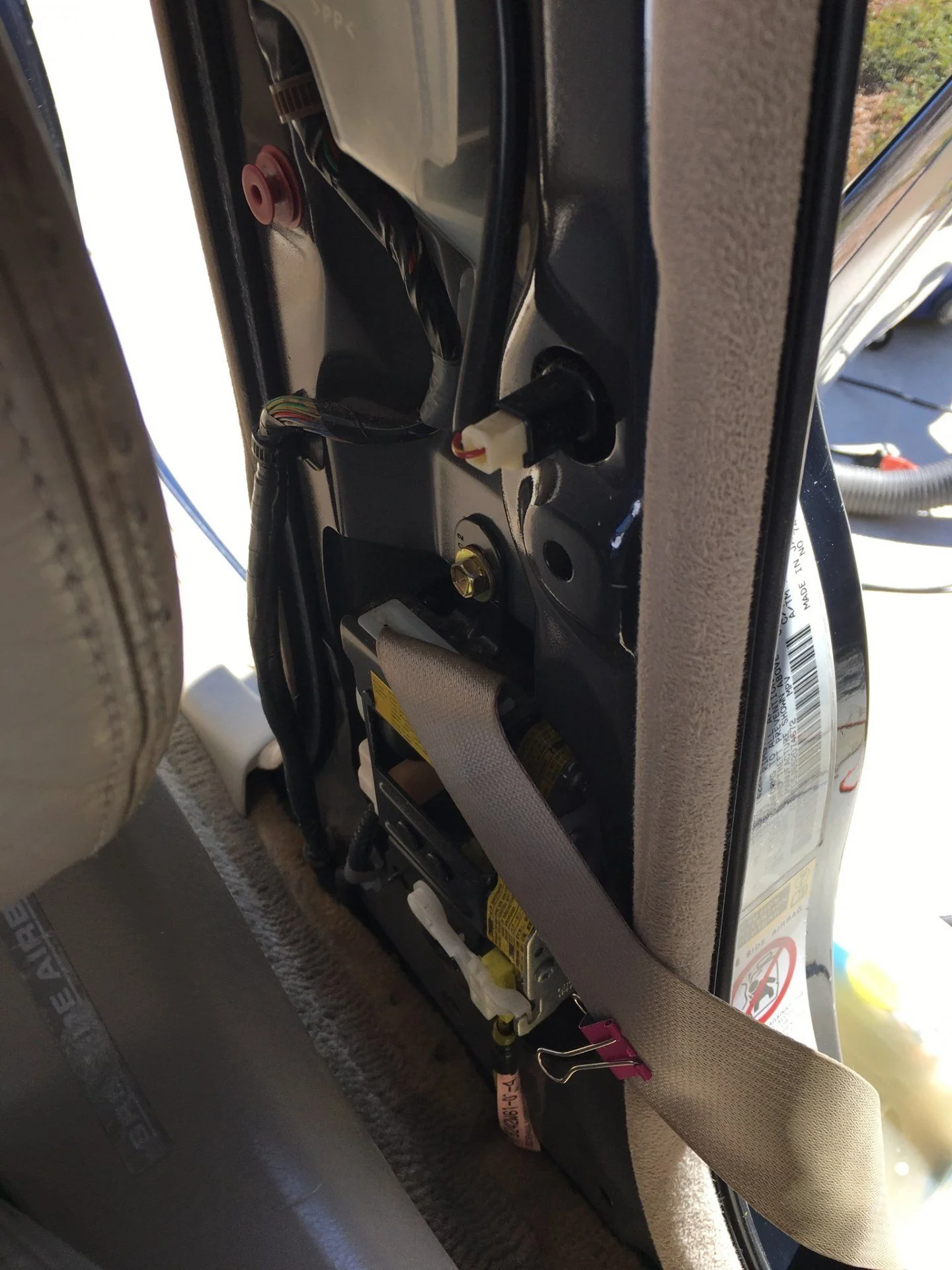

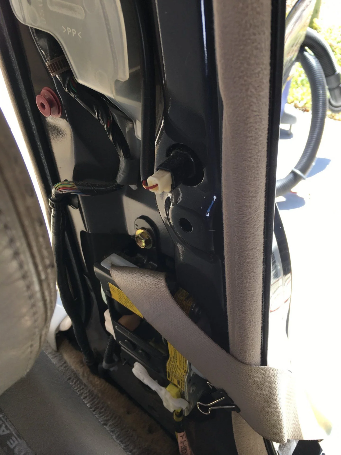

The seat belts in my 05 have been slow since I bought it. It got bad enough on the drivers side that there was a couple inches of slack sometimes! I tried all the tricks to fix them, velcro, dental floss and so on. Tore into it today to fix it and here is what I found that worked. On my 80's, I just pulled the entire seatbelt assembly out and soaked it in hot water and oxyclean. Thought that would work on this truck but the seatbelt pre-tensioners gave me a pause. Here is what I did...
First pull the plastic bits surrounding the seat belt on the B pillar. Disconnect the 14 MM bolt holding the belt at the bottom and the one over the shoulder. Pull the belt out all the way and clip it off to prevent it from retracting in. This is what I did.
If you are a Lexus owner, this might work better...
Now grab a bucket, fill it with HOT water and something to cut the grime on the seat belts. I used half a scoop of oxyclean. Dump all of the slacked belt in the bucket.
As you can see, it was nasty to say the least! 200k miles of boogers, sweat and who knows what else had permeated the belts! I went through 2 buckets and then took a soft brush to them to get them clean. Rinse very well and let them dry.
While they were drying I took the time to clean under the door sill plates and all the plastic parts.
Once its dry, re-assemble and give it a try. Mine are like brand new now! And they work great, no sticking and they retract instantly.
All in all, a 1 :banana: job.

Man, everyone has had success with this. I tried it with oxyclean and hot water and nothing. Did both front DS and PS and nothing. Still will not retract all the way. I guess it's cool they are clean and smell new, just don't retract like new.
Ah, well don't feel bad! I said it retracts, I never said like new. :)
My DS seatbelt was all gummed up, and really, really stiff because of how dirty it was. It was so nasty and gummed up that it did not retract, at all. I had to manually feed it back in at the end of each drive. I'm not exaggerating. It was really annoying.
Cleaning it with laundry detergent pods helped. I think there is a little fabric softener in the pods? Hitting it with the power washer helped get it super clean. I'm not sure the detergent alone could have done it. Maybe if I had let it soak for a few days. In any case, once all the dirt and goop / black stuff was gone, it felt really soft, like you'd expect it to feel.
Now I unclip it, and toss it out to the side and Bam! It retracts all the way. I would not say it is like new, but it works really well now, so I'm happy.
If you want yours to be like new, then you should probably just buy the seatbelts new. It seems you get everything as one unit and can replace them.
