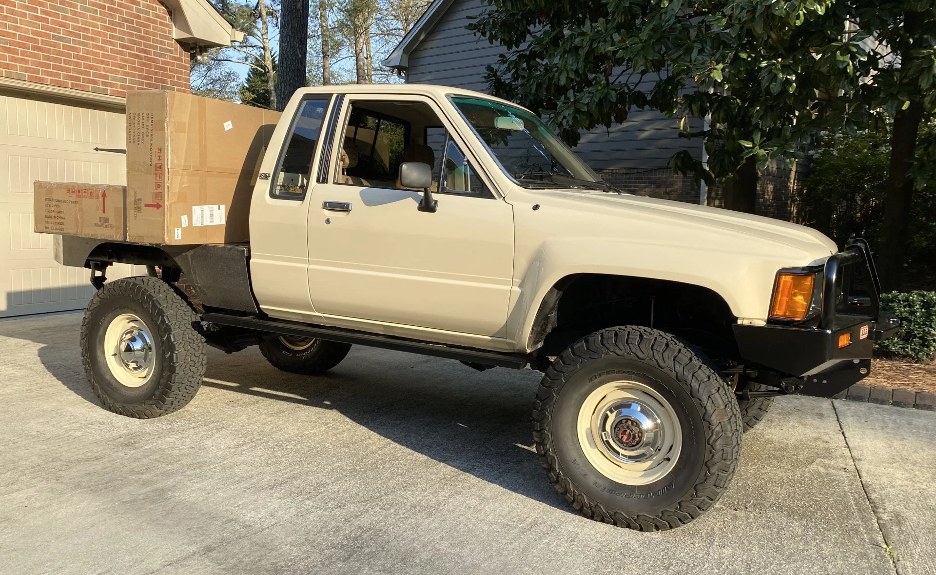

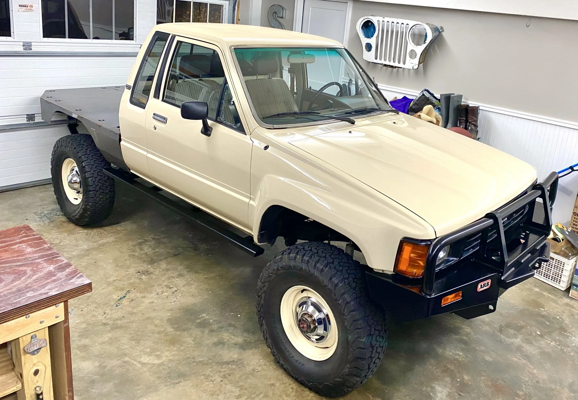

I wanted something simple and subtle for Patty. We used rectangular tube, matched the angles to wheel opening...

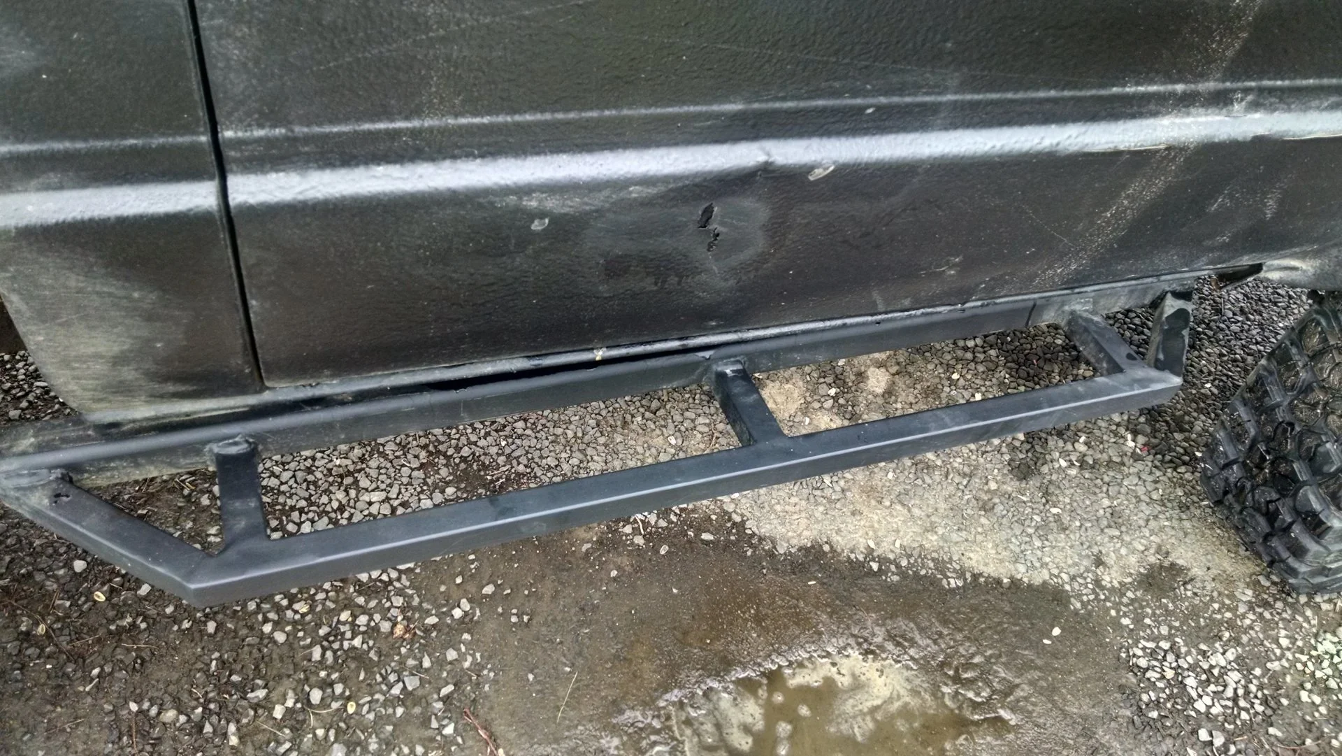

This is the simple design I made. Doesn't look good but they worked and bolted on. Honestly just go with what you like. Can't go wrong with TG if you can't out them on yourself. I preferred bolt ons in case I ever needed to remove them.
I do too. But, there isn't much of (any?) a bolt on option for our trucks. Everything is welded.
Sadly there aren't. That's why I made my own. 2×2 1/4" for where the rocker is and 1.25x1.25 1/8" for the other ones. Probably way overkill but I had the material. Could have a local fab shop make bolt on plates for the off the shelf ones.
