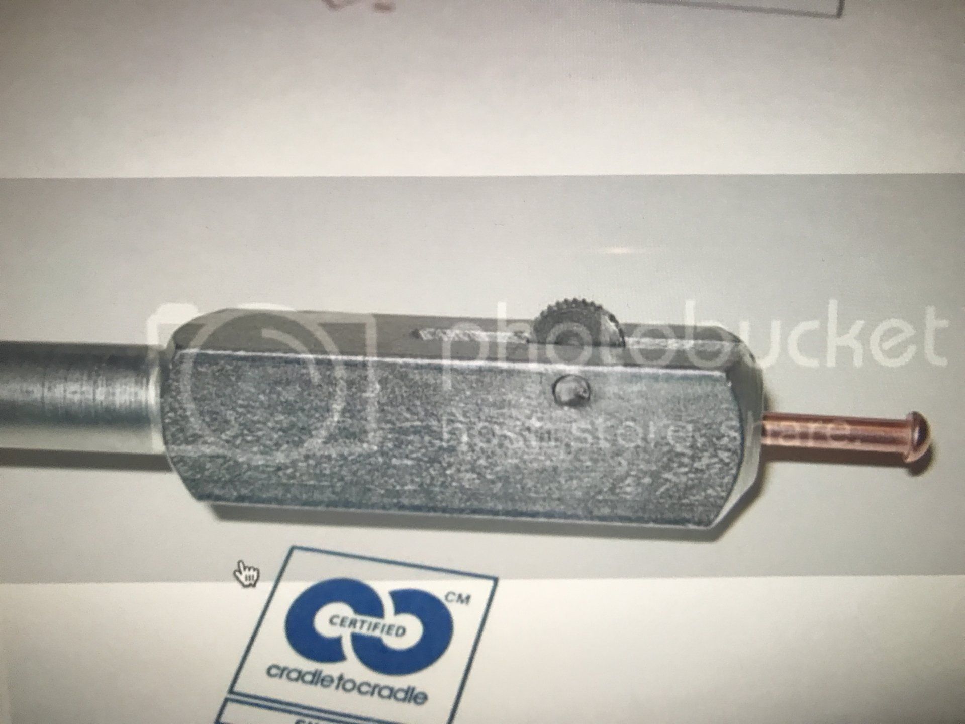

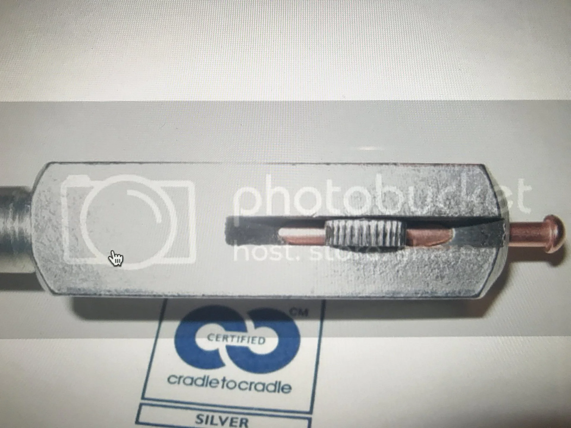

The stud welder dent puller kit I own utilizes a knurled wheel that is offset from centerline creating a cam lock. The slide hammer stud jaw can grip several different sized pins as this design adjust itself. This type of jaw requires slight pulling pressure to maintain grip on the pin while sliding the weighted hammer back.
The jaw does thread on to the end of the slide hammer.
You can understand my description better by the photos.
I'm sure there are numerous types of gripping jaws but these IMO are the simplest to use and requires no threading like a collet type.

I think this is one.
that knurled cam wheel seems like a good way to go. Better than a collet as far as grip, I think.
+1
I really liked the eccentric idea too, you can easily sharpen up the wheel or move to different teeth by stud’ding diff dia pull-rods.
And it self-grips under torque for the pull.
