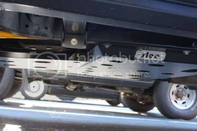

The long and the short of it is that they don't fit together without modification of the sliders. The sliders fit over the frame with 3 ubolt type attachments (front, middle rear) as seen here:

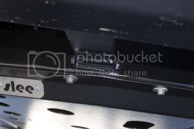

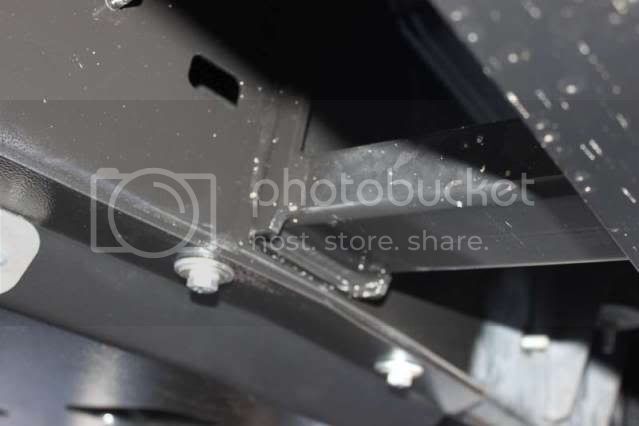

However, the middle skid plate has to fit flush against the frame, thus making the middle attachment point on the sliders impossible without some modification. So, ACC cut and modified the center bracket and welded the slider onto the frame to allow for the fitment of the skid. As seen here:
and here:
And, VOILA:

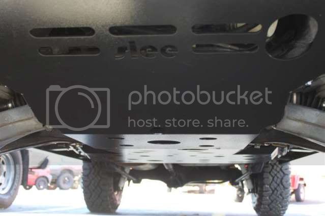

It looks like you could just notch the skid plate at the u-bolt location as well if you wanted to maintain the removable "bolt-on" functionality of the sliders.

It's the middle slider outrigger that's the difference. The MT ones are further towards the front of the truck, so they interfere with the skid. The Slee sliders' center outrigger is further towards the back of the truck, so it's behind the skid.

I would think so. But the skids were so clean and straight and fit so nicely, it seemed cleaner to change the slider a bit. I'll never take them off anyway. I also wonder if a notch in the side of the skid wouldn't catch on things?

Big thanks to Butch (mud name: Texican) at Baker Tire for helping me get this installed.
300lbs of steel now being carried with me everywhere, but it's in a low center of gravity. Once I add the rear bumper and 33" mud tires the regear will be a must.
