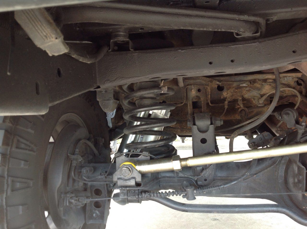

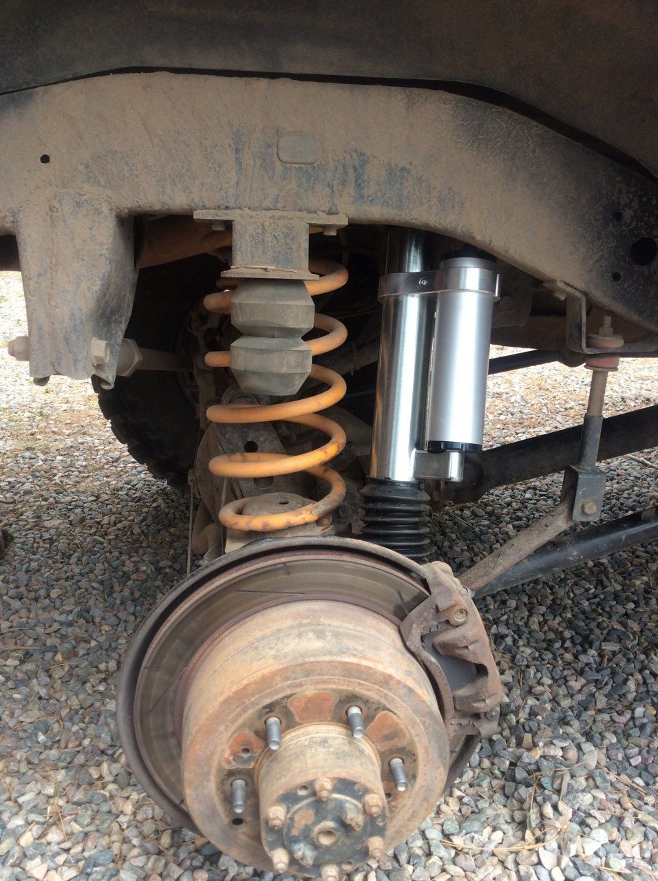

After several weeks of collecting dust the Slee 2.5 remote res shocks are on !! they are truly works of art ..... I have a Slee heavy set of springs and the BL's and swapbar drops, I added the Slee rear panhard and Landtank longer LCA's.... and then 10mm OME coil spacers to removes some of the spring "clunk"
They also installed my Landtank DC front DS and a new OEM rear ( thanks Beno !) - that got rid of the last vibrations in the drivetrain..... still have a slight one in one DuraTrac I think.....
Tried a new shop as I my usual was too busy..... impressed so far. Ahead of the time promised plus they were under budget.....
With only 100 miles the ride is noticbly smoother and the small stuff much less annoying as I go over pavement creases and potholes..... SLee said they'd get smoother with 1000 miles on so can't wait...
but so far it's really impressive over the OME 's....... hoping to put her thru the paces this weekend and report back....
Some pics - will post more once I get some time on it and can crawl under the truck
cheers

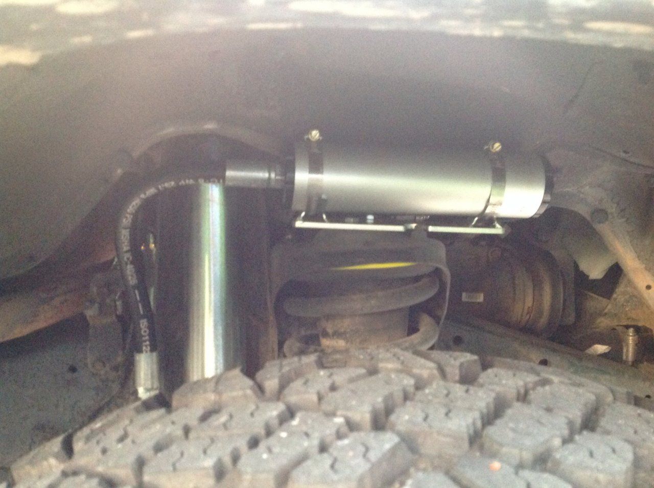

How does that reservoir not hit the rear swaybar on compression? Must be the pic angle, but I look under my truck and envision the same if guessing your location
I think it's camera angle - the shop did test the full range on a ramp as we were debating bump stop changes and they said it flexed really well with no binding or issues other then at lock I tend to just rub one my driver side sliders .....
